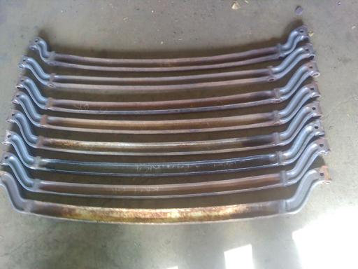

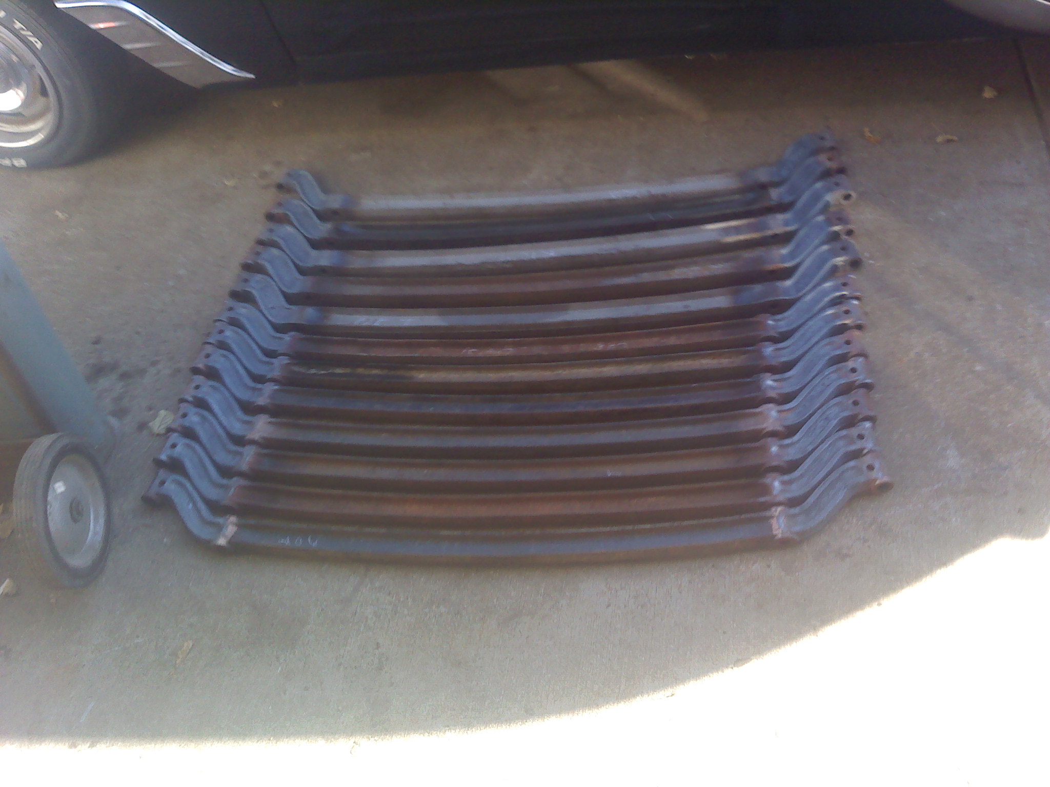

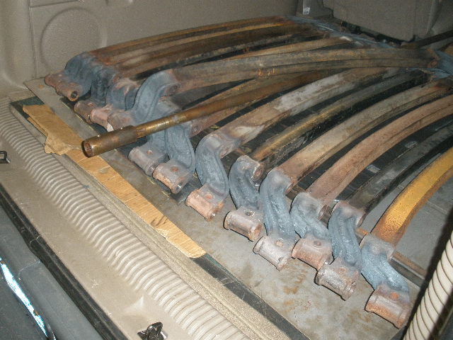

    2010-02-20-027.JPG CIMG1315.jpg Mindover, thanks for sharing the great photos.
    I saved these two pics from here, I think, anyone know who they belong to...cool shots.

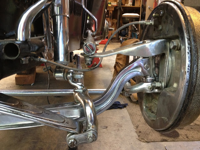

    Here is mine- saved it from a local "rat rodder" who was gonna strip the chrome and drill it full of holes. He gladly traded for my non plated axle simply because it had 1/4" more drop

    good save, Chris.

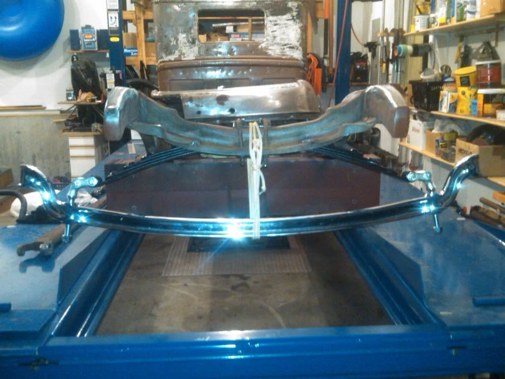

    Here's mine on my '33 truck. I'm told it's a chromed Dago, but I don't know for sure.

    Harv, the first pic is of another batch we did long ago.

    I think that dago dropped axles may be like Corvette engines they all are aren't they.
    Nice looking axle whether it is a dago or not.

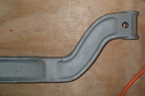

    I thought so at the time! No one had dropped an axle here in the UK at the time that I knew of.
    With a lot of youthful enthusiasm, a bit of railway line for an anvil some blacksmithing experience, a days work and a lot of heat.
    No I heated it (lots). Its still on the car I built it for. The car is in Australia now though.

    Damn Chris....thats a nice one....

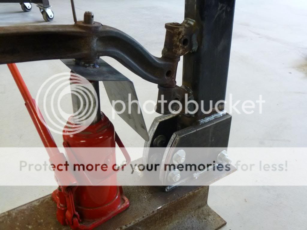

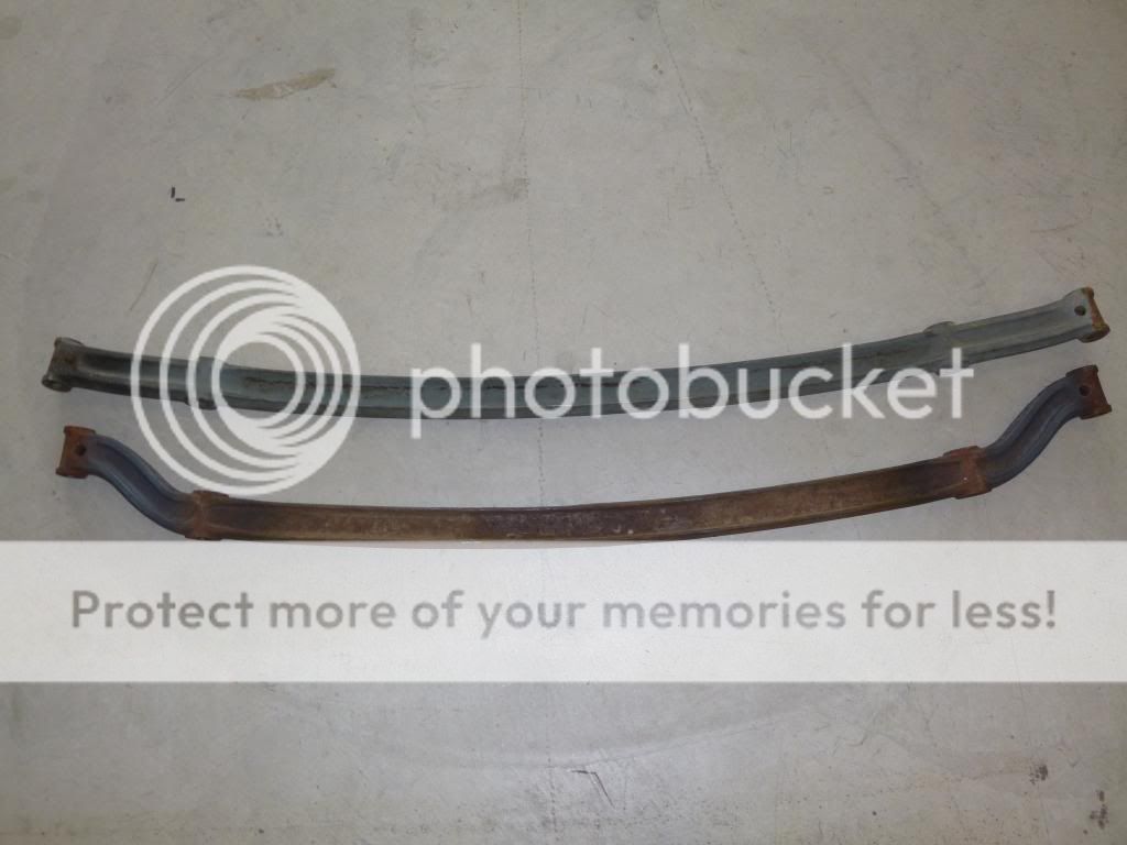

    So I got to reading this thread a week or two ago, and got all inspired... that can be dangerous. I looked threw all my s**** and treasures and came up with this.... I had a model A axle that had been wacked in the center and vee'd back a bit but after some press work you would never know it. Figured if I ruined it I wouldn't be out anything but it seemed to come out o.k.
    I made the post adjustable in case I wanted to change camber, I also made the guide on the other end adjustable so I could let the axle shorten or make it taffy,(I did find that my mount for the free end wasn't beefy enough, I made it as strong as the piece of s**** would let me but it deflected a little instead of stretching the axle)
    I dropped this one 2.5" below stock as that is all my steering arms would allow before hitting the Tie rod. Here it is with a stock one.
    Thanks to everyone's posts and ***us's tech thread, this was a pretty fun project.

  24. That's a pretty cool setup Leonard.
  25. louisb
    Joined: Oct 13, 2008
    Posts: 1,126
    louisb
    That is pretty sweet. Nice job!
