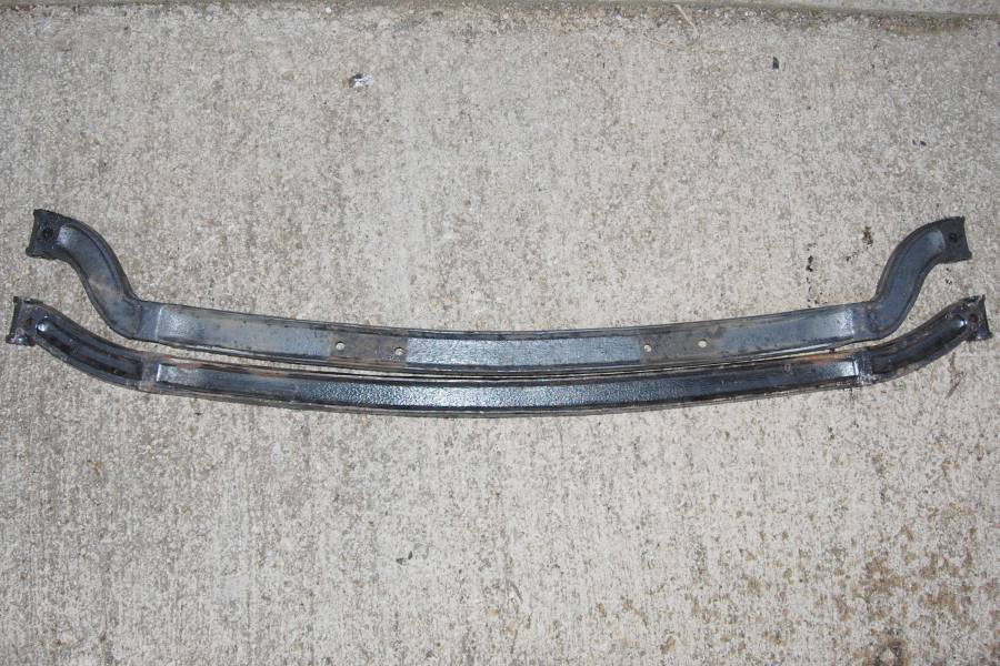

    I sold my really nice dropped '32 heavy that I bought from 296 v8 during one of my "do I really need all this ****" phases, but then was offered another axle and parts that I had made an offer on a few months previously, so kind of had to get it :eek:
    I don't know who dropped it or when, but it came into this country under a '33-'34 pickup (from Az I think) that had been "updated" in the '70s or '80s judging by the style. It had welded tabs for tube shocks, and the two pairs of holes are for the steering rack that was fitted (and not working too well - I think that was the main prompt for its removal). The drop is pretty nice, and it was mounted with some fabricated split wishbones/radius rods that used part of the original 'bones.
    The other axle is a stock '32-'36 axle for comparison

    I kind of dig those bones!

    Yeah, I sort of like them as they remind me of some I fabbed for a Model A pickup a few years ago, but not sure if they are a little too "modern" for a traditional '40s rod.
