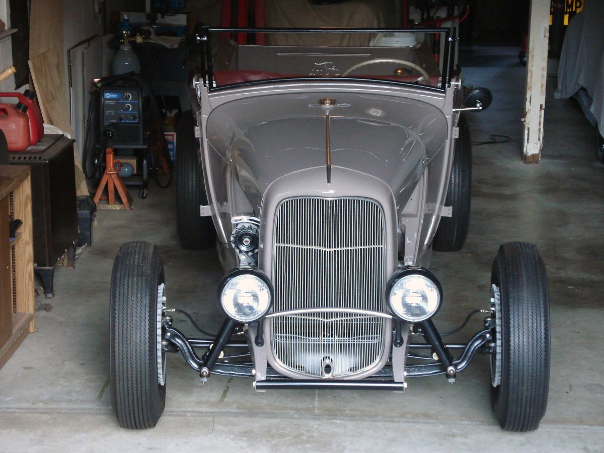

    Mine is s back on the road 003.jpg imilar, a little more drop and a bit of cut and weld.
    bct and Jet96 like this.

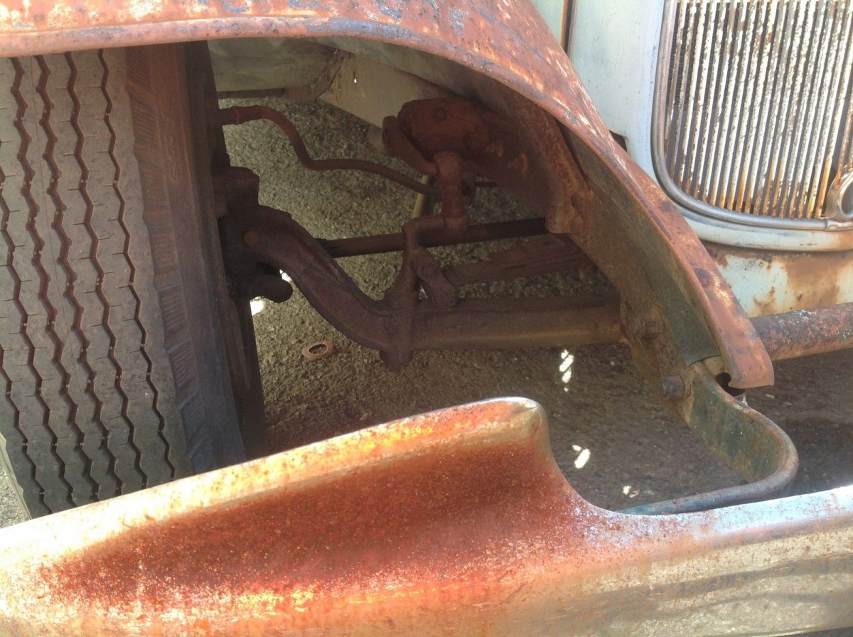

    This old axle in under a 32 pickup I just brought home...
      219.2 KB
      528
  9. falcongeorge
    Joined: Aug 26, 2010
    Posts: 18,339
    falcongeorge
    from BC
    ^^gotta like the Olds bumpers as well, thats an interesting looking truck. Is there somewhere we can see more?
    gwhite likes this.

    PLEASE, Show me your dropped spindle with an I-beam axle..?
  11. gwhite
    Joined: Sep 1, 2007
    Posts: 3,136
    gwhite
    SUPER MODERATOR
    Looks like a Mor-Drop to my eye....very cool!

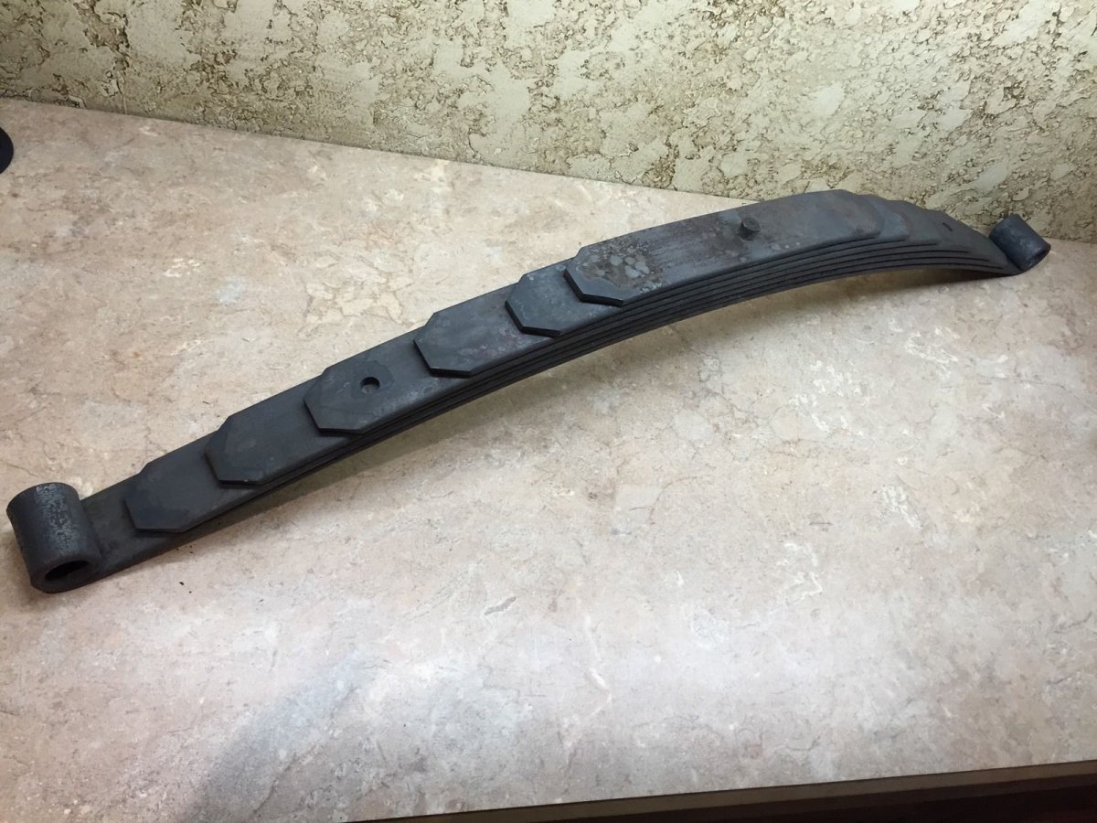

  20. gwhite
    Joined: Sep 1, 2007
    Posts: 3,136
    gwhite
    SUPER MODERATOR
    Ahhh...my mistake, I meant 'clipped corner' or 3-sided taper. The 32-early 34 spring had the clipped ends just like an A; the late 34's and all service replacements thereafter had square cut ends.
    Here's an example of the 3-sided taper springs (A-early 34). I reckon you could do a little grinding on these if you wanted a true rounded taper.
