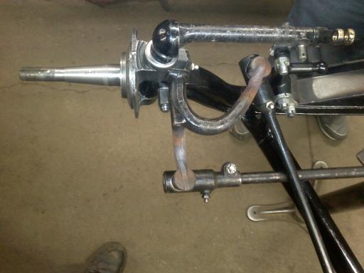

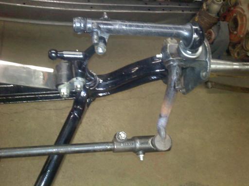

    Here are pics ***us posted back in 2014 of twisting model A arms IMG_0297.jpeg IMG_0298.jpeg
    RICH B and mad mikey like this.
