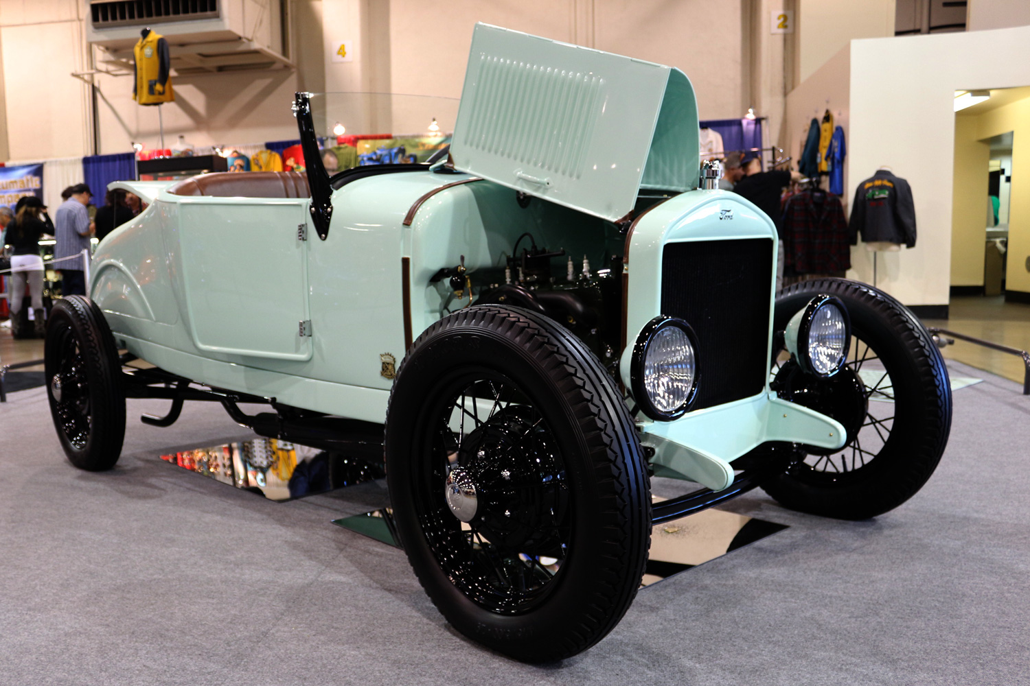

  3. There are a few pictures around of a hiboy style 36 Ford pickup with 19" A wheels. Looks good.
    Would not be surprised to see narrow 17" to 19" rims with skinny tyres (tires) the new "old" trend.

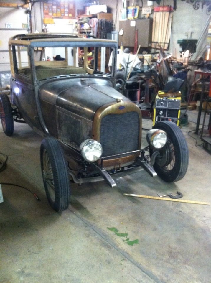

    Not the best shot but I have a 4" drop axle a reverse eye spring and an aftermarket cross member to get a total of 6" of drop in the front and a 6" Z on the back.

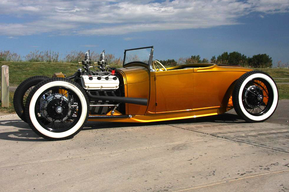

    I also stole this pic from the GNRS. Not lowered but I love the look of this T body on an A frame.
