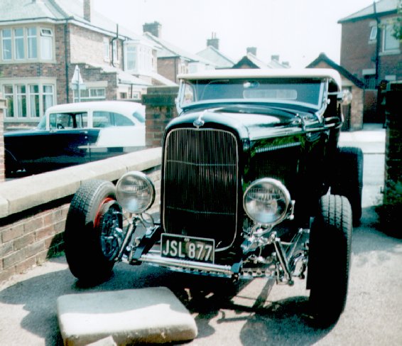

  19. reefer
    Joined: Oct 17, 2001
    Posts: 787
    reefer
    I just got the roadster on the road and I`m knocked out with the ride characteristics.It runs a chassis engineering 4"forged axle and posies super slide reversed eye spring and panhard rod with p&j tube shocks, with split `40 w`bones.The brakes are `40`s with Buicks.I`ve used a Saginaw 525 box with cross steering.It ride real good and pulls up good and straight and self centres coming out of corners,the steering feels positive(ish)and the brakes are equal to my daily hack van.I`m not saying I can take it out on the back lanes and nail it, but the ride is very acceptable...as for i.f.s.on non fendered cars, I`d rather catch the bus!!
