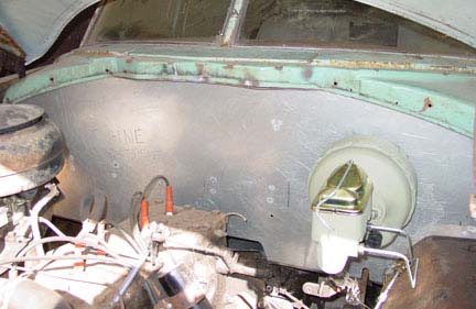

    Hi Jason,
    There is nothing wrong in updating your Hudson. These days there are so many options available to you. Seems you are already converting over to 12 volt system so you are not a "Purist". You have to remember that nowadays you are contending much with higher speeds on the roads. You are also having to deal with getting parts if for some reason you should break down many miles from home. You can't just walk into your local Napa or AutoZone store and get a Hudson engine/trans part. I would recommend looking into something that was newer than the 73 and had an automatic transmission with it. Either going with a 6 or an 8 would be your preference. The newer the engine/trans combo the better. On the plus side, you would already be setup for A/C which would be great on those hot summer days. If you keep your original front clip suspension, there is a Hudson guy that makes a disk brake conversion and it is quite inexpensive. The only thing you need to be careful of is the oil pan clearance on what engine you decide to use in the Hudson. I used a Painless Universal Fuse panel along with my 12 volt system. Here again you have many options these days. In closing, I would suggest a newer engine combined with an automatic trans. This also gives you the ability to have overdrive. Oh I almost forgot, I also am using a dual master cylinder on the firewall for safety reasons. How do I know all this, because I'm doing it.
    Peace,
    Chaz (the elder)
    This photo was taken before I took out the old engine and went with a newer Chevy engine. (my preference) but it shows the dual master cylinder.
