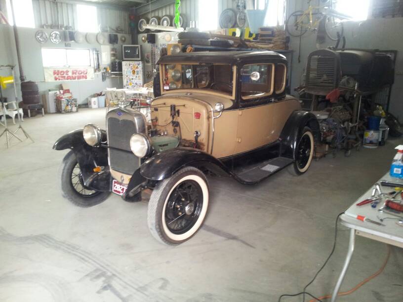

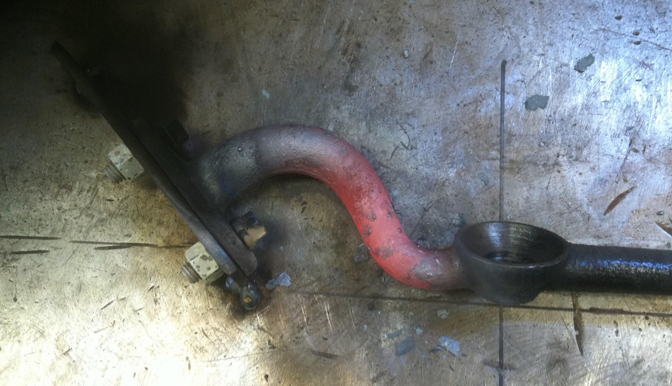

    After lunch today I figured its not a hot rod with a stock headlight bar, so here is the damage report for my 29.
    So the before picture.

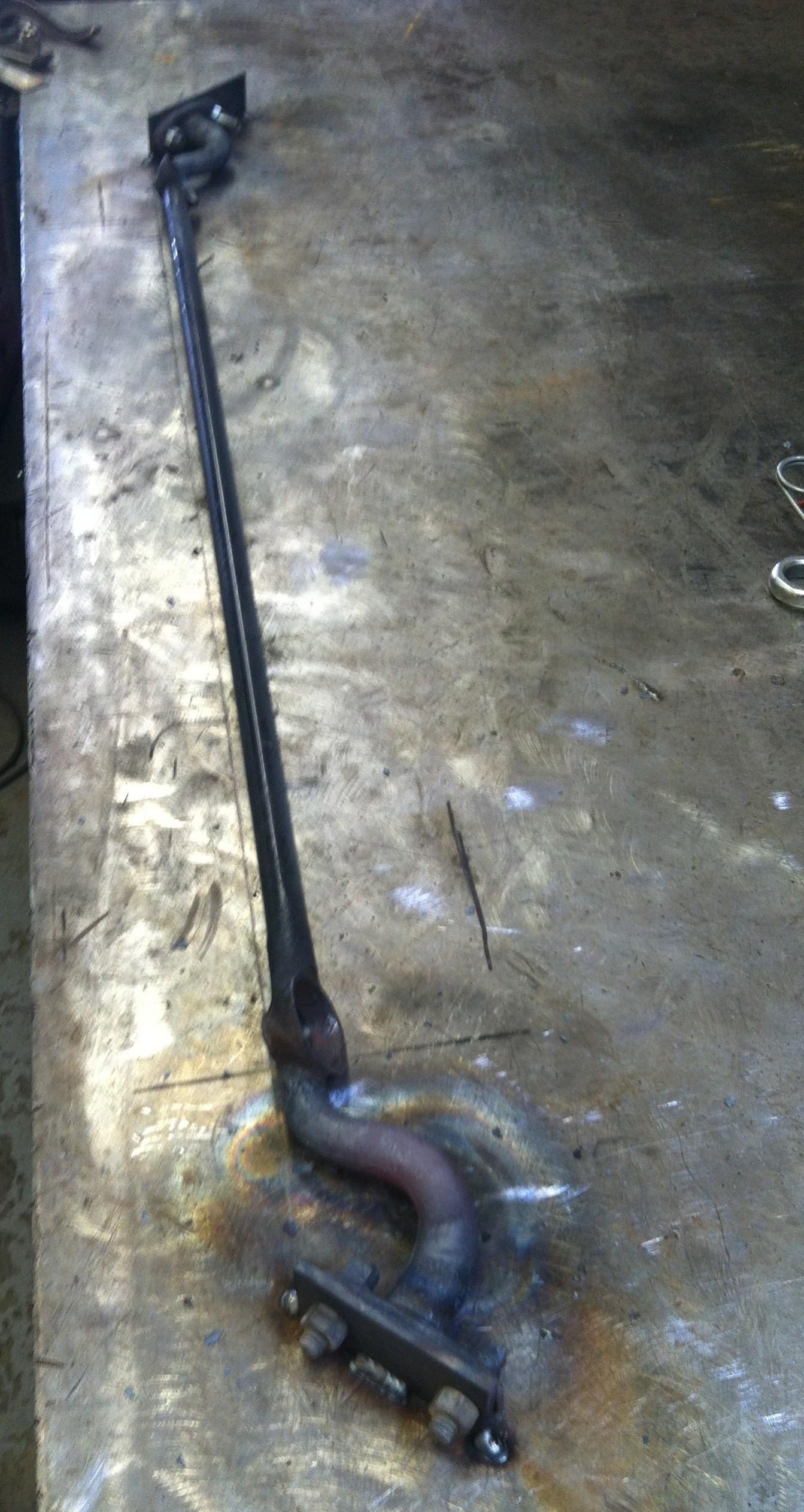

    Removed the bar, made two tabs to bolt to the ends, laid it on the welding table and tacked the brackets to the table.
    Marked the headlight mount centerlines on the table, and a line 4 inches below to aim for.

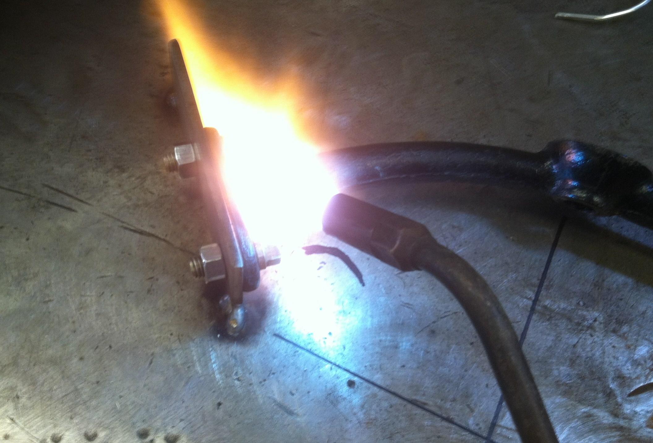

    Unbolt one side, and heat the bolted side with a rosebud, at the very base first. Slowly heat and bend, the goal is to make a 90 degree bend about 1 inch short of the scribed headlight centerline.
    Air cool the first bend, and heat and slowly bend it back to level with the line on the table. The goal here, is parallel to the line, and to have the headlight mount line up again.
    After an air cool, remove bolts, and bolt up the opposite side and repeat.
    On the final bend, you should be able to bolt the first side back into your tabs and let air cool.
    I gave a quick sand blast, spray paint and back on in less than 2 hours.
    No more bug eye headlights.

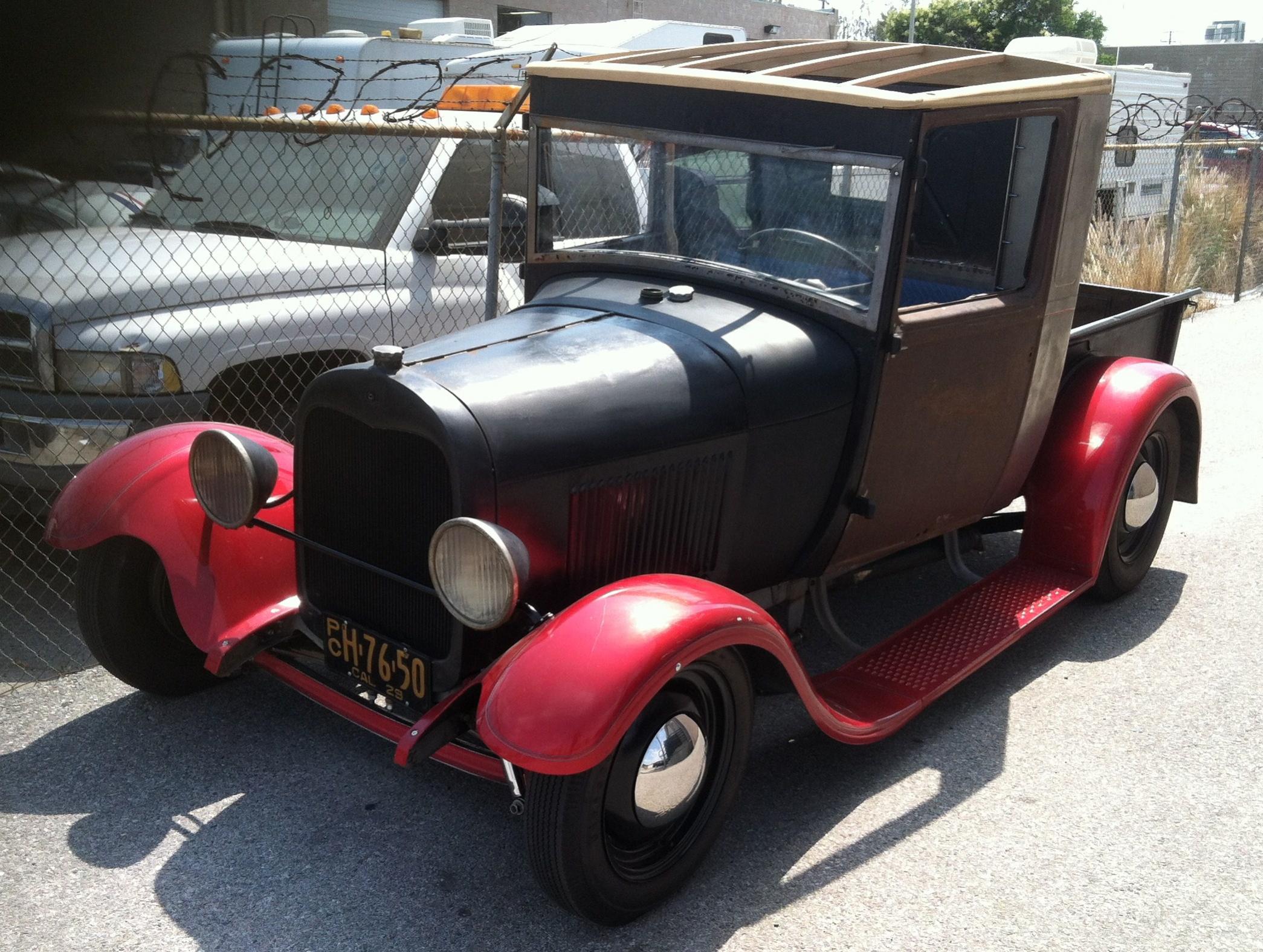

    After.
  3. Big improvement. HRP

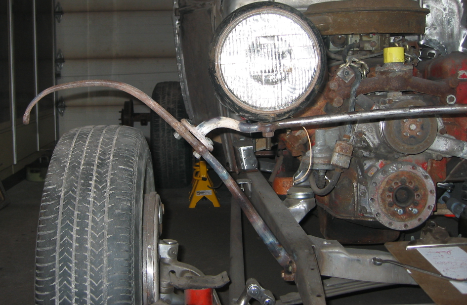

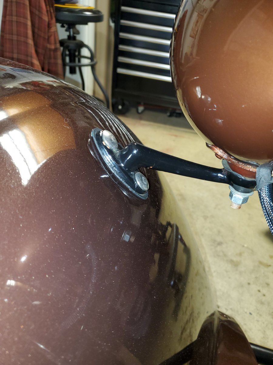

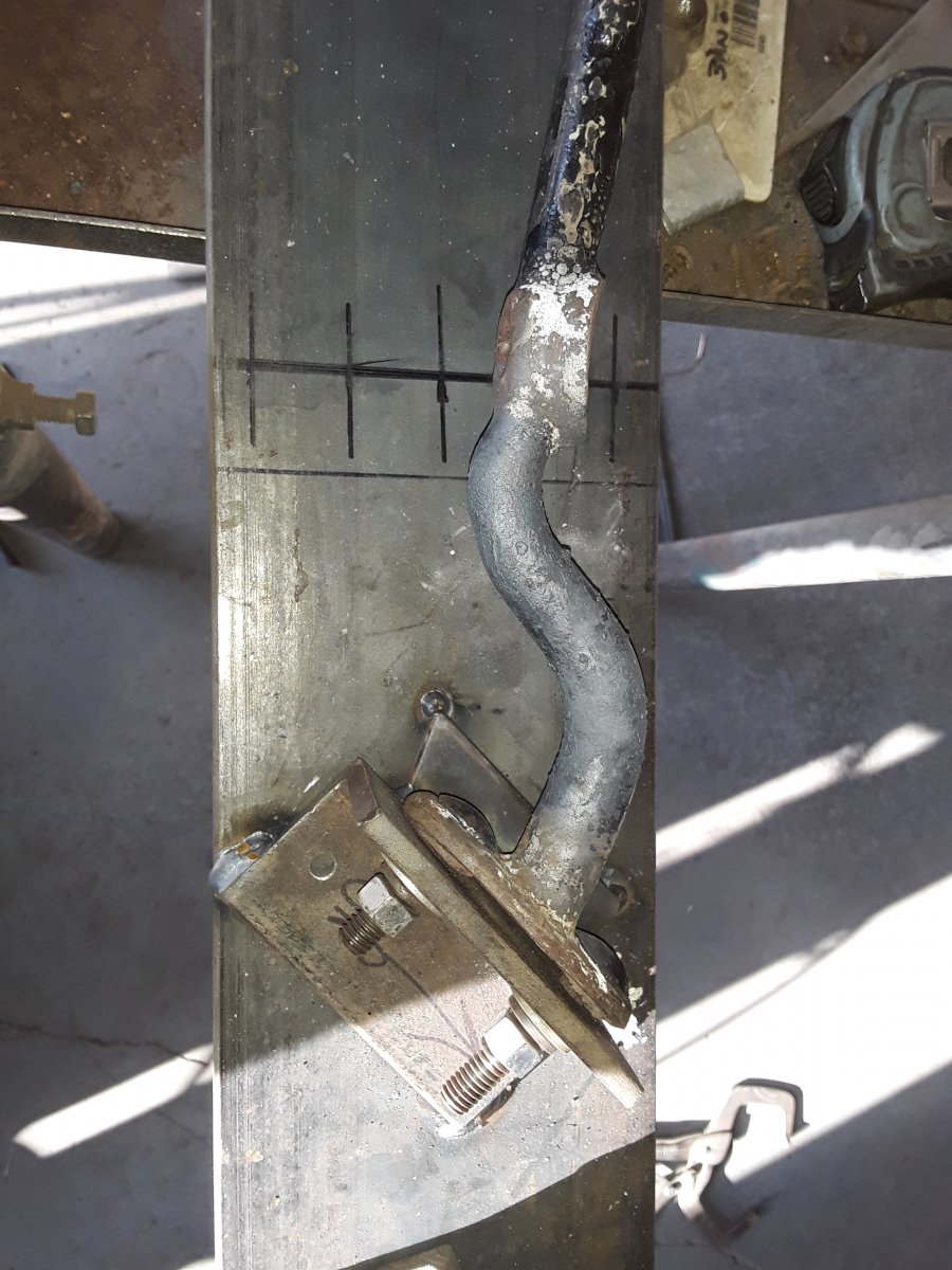

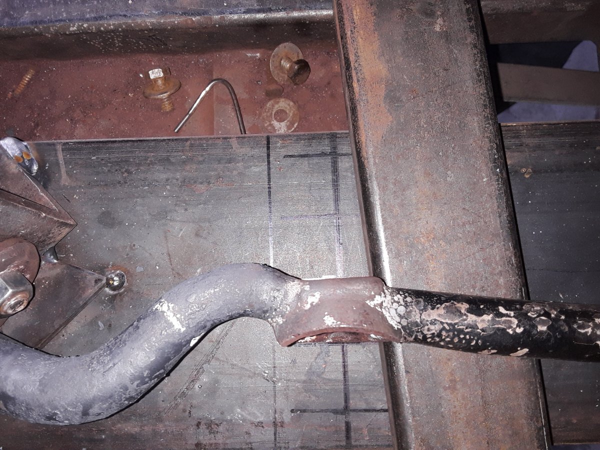

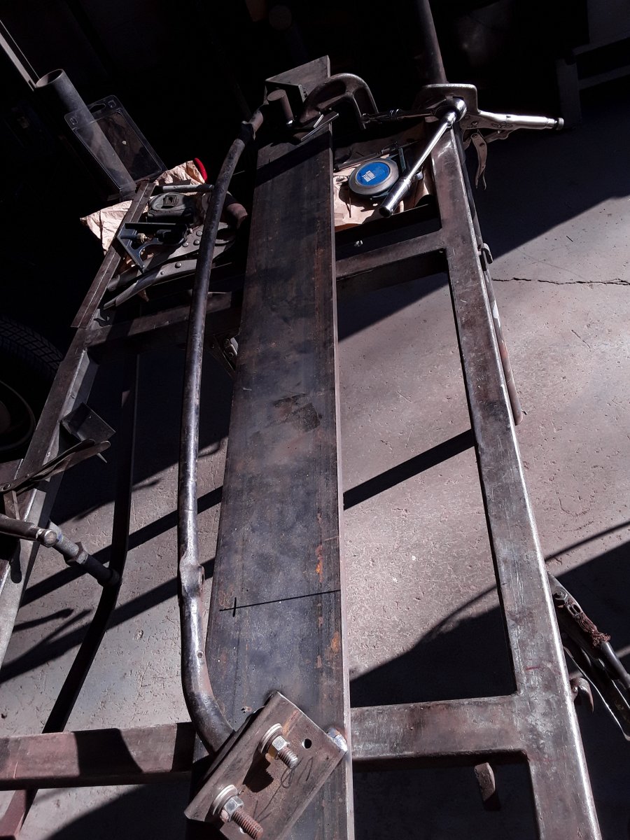

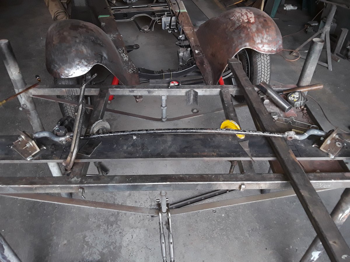

    Today I went to the welding supply store and bought a rosebud tip for my Oxy/Acetylene torch to take on dropping my Model A headlight bar. I had an extra one that I bought at a swap meet so used it and kept the one that was on the car in case I totally destroyed the "victim".
    Welded tabs onto a 6" X 1/2" piece of bar stock similar to what badshifter did in the original post. Made some reference lines for the centerline of the headlight mount holes and 1" increment marks for reference as to the amount of drop achieved. On the first side I ended up having to reheat and tweak the bends to get the headlight mount back on it's centerline (and one photo shows that), but the second side went much better. Although the two sides didn't turn out perfectly symmetrical someone would have to stand in front of the car and have an eagle eye and too much time on their hands to see the slight difference. Maybe the radius of my bends isn't as tight as badshifter's so I only ended up with about 2" of drop compared to his 4" drop, but perhaps it has something to do with his example being a '28-29 bar and mine is a '30-'31. In any case, I'm happy with how it turned out.
    Thanks to badshifter (providing he's still active here) for the tutorial. It gave me the confidence to give it a shot. Even with buying to new rosebud tip I'm still about $75+ to the good, compared to buying a bar that's already been dropped. While I have the jig set up I might just drop the other one too and use the one I like the best.:)

    The truck got finished, headlight bar chromed.
    Liked the truck better when it was a little more rough.....

    FWIW....I dropped the other bar I had today and only got it down about 1 1/2" or so. I dropped it to to use the headlights I have that were on my Coupe and I don't think they're actually Model A, but that's a whole 'nuther story. Probably could have tightened up the bend radius a bit on the bars I dropped to get a tiny bit more drop but I didn't want them looking "kinked". I used a short length of 1 1/4" steel round bar against the headlight bar as a "bend mandrel". It's all an experiment anyway as I prove to myself I don't know what any number of seasoned hot-rodders already know.:confused:

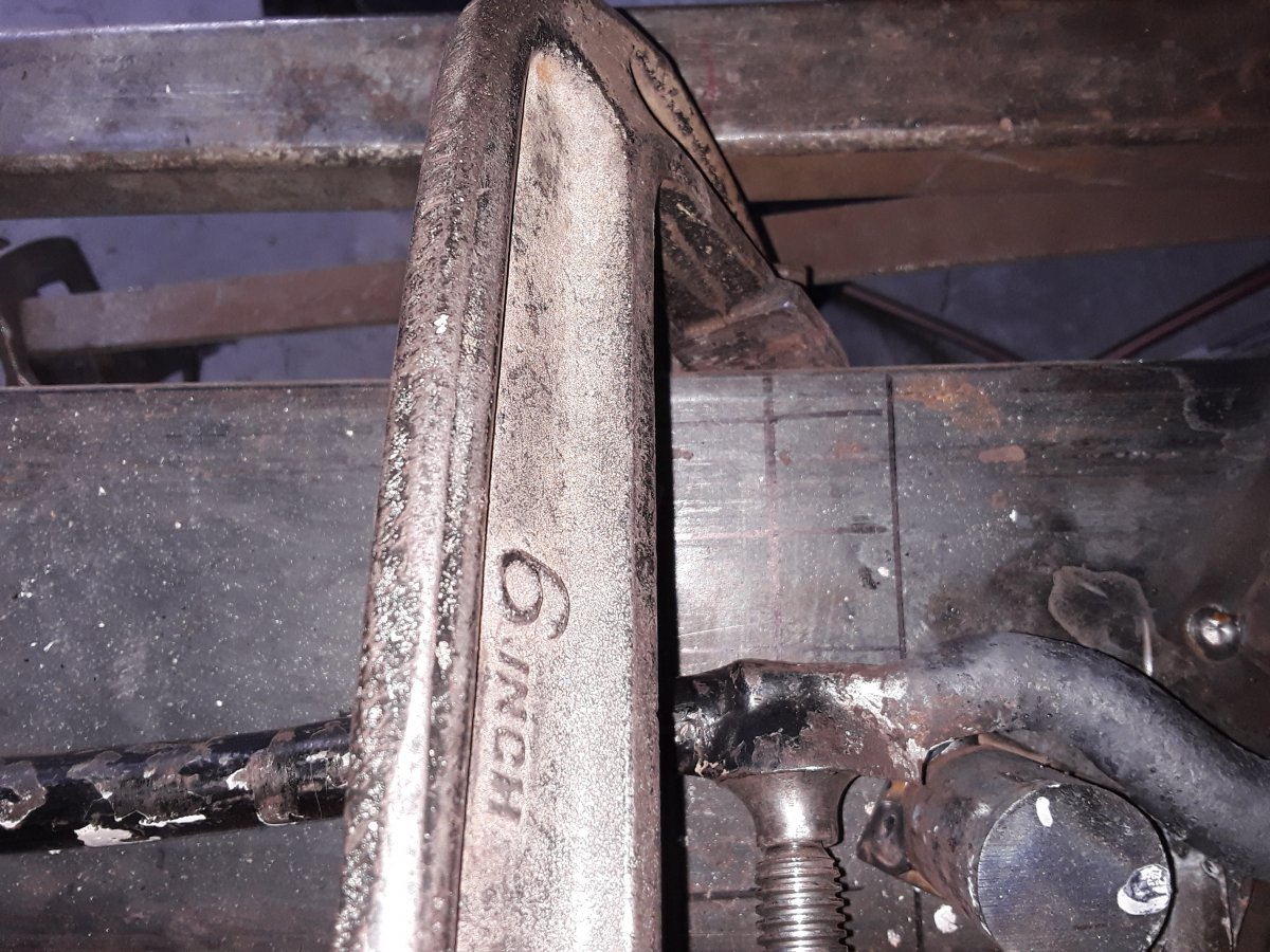

    Just did mine a few days ago....
  28. Anyone ever do it this way? Sorry, no before or during pictures 20201104_100348.jpg 20201104_100355.jpg 20201104_100405.jpg 20201104_100414.jpg 20201104_100550.jpg
