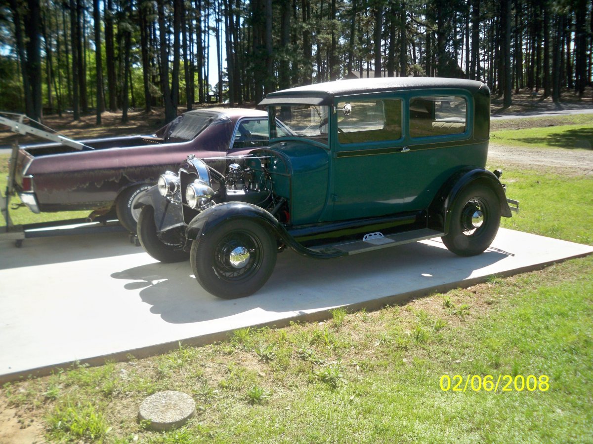

  6. I did my '29 with '32-'36 axle, '32 spindles & spring perches, a reversed eye main leaf with two leafs removed. Kept the mechanical brakes, this was a very simple, bolt up modification and the only modified part was the reversed eye main leaf. Got me approx. 4.5" drop with 6.00 x 16" tires... 113.JPG

    That's the look !
