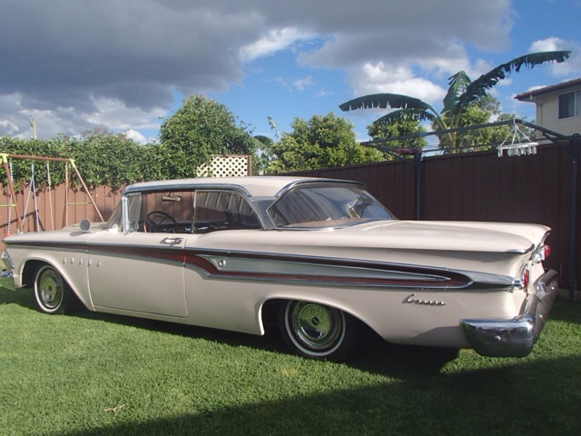

  3. 32 4door
    Joined: Jan 27, 2014
    Posts: 78
    32 4door
    image.jpg Mine has 2" blocks in the rear and cut stock front coils , still handles and drives great

  5. jgang
    Joined: Feb 22, 2009
    Posts: 238
    jgang
    from hamburg ny
    well... i went to see the car the other day and take some measurements and photos for comparison. it is low, but... not as low as i thought it would be based on the conversations i had with the mechanic. yes... he did have to jack it up a smidge to get the lift arm out but it looks just about like cornfields and 32 4 doors. I've been driving it around a little these last few days and i haven't bottomed out, rubbed or scraped anything. I'm not sure if the springs will settle out much or if at all, i will have to wait and see i suppose. i am thinking about getting some spacers just in case, but time will tell. thanks for the info and the pics guys, and i love both of your edsels.
