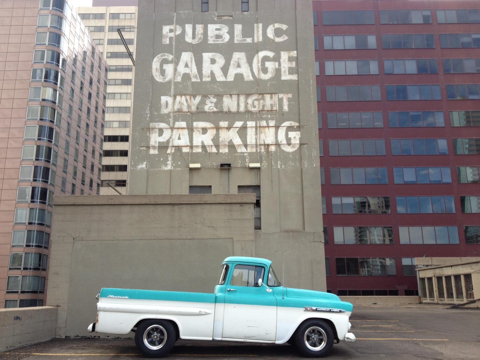

    I run a 4" dropped axle (Sids) and flipped the rear on the stock springs. ImageUploadedByTJJ1366562256.551432.jpg

  23. APACHE FS
    Joined: Feb 20, 2007
    Posts: 569
    APACHE FS
    Right on, Tjet is 100% correct. I left all that out in my post, Sid will give you the low down if you go that route. By the way he's highly recommended by me, great guy, great service.

  26. APACHE FS
    Posts: 569
    APACHE FS
    Not the exact answer you are looking for but see how my wheels are tucked under the fenders? They don't rub unless the suspension cycles while turning into a steep driveway or something. Then it's VERY minor at that.
