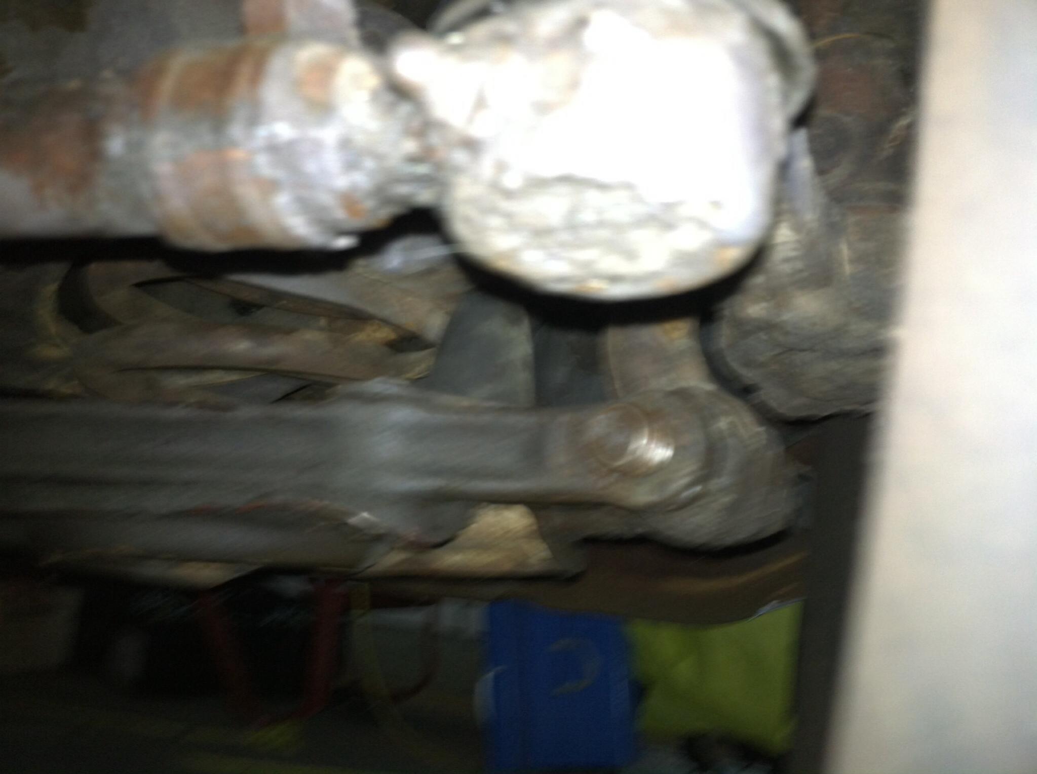

    Well I started with one and it didn't drop it much at all do I pulled me out cut another 1/2 out and now it looks great but ...... Now the snubbers are fractions away from the stop do I find some other ones and try again pull off the snubbers or what!? It looks sweet as hell now
  9. gimpyshotrods
    Joined: May 20, 2009
    Posts: 24,535
    gimpyshotrods
  10. gimpyshotrods
    Posts: 24,535
    gimpyshotrods
    You may need to trim metal if it hits the 3/8" stops on a regular basis.
  11. desotot
    Joined: Jan 29, 2008
    Posts: 2,049
    desotot
    You could start by taking a hacksaw blade and reduce the snubbers to 1/2. Its not a real good idea to totally eliminate them because its murder on the parts when steel hits steel.

  14. 51_special
    Joined: Dec 20, 2012
    Posts: 83
    51_special
    Heres a pic of the lower a arm and snubber
