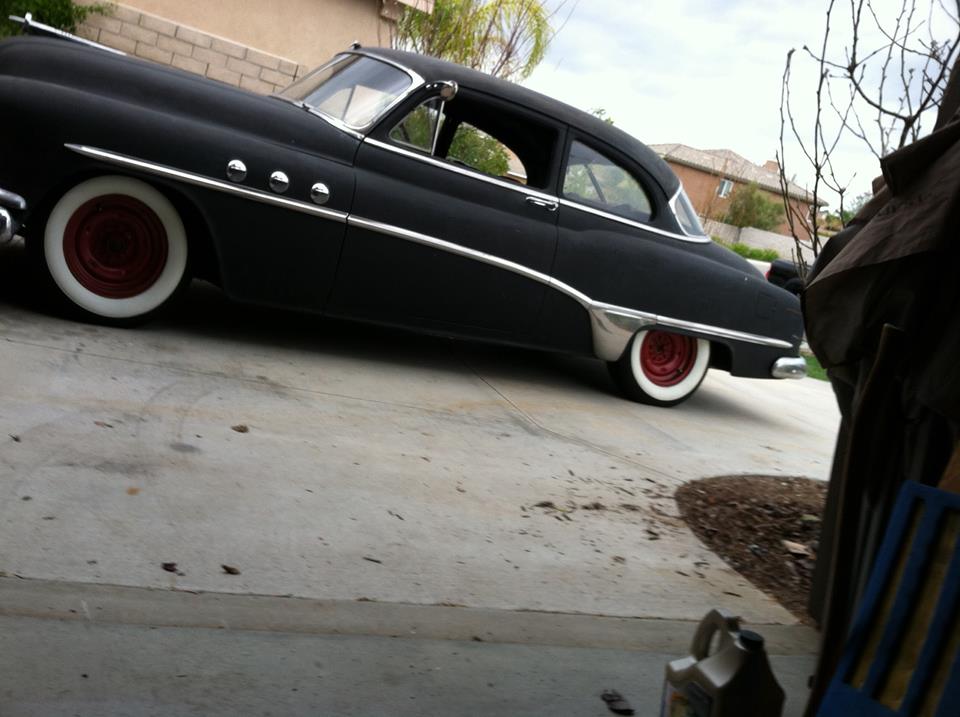

    Thanks guys. beerczar i pmd you. Anybody know how much lower i can go without notching or anything crazy and on the cheap

    As requested here is the info for the rear springs. I got mine from NAPA auto parts. the part number i used is 277-5171 they are a progressive rate so make sure you install them the correct way (tighter coils install UP). really simple. disconnect the shock linkage, Jack the *** up till the weight is just off the wheels, install jack stands. remove the upper bolt holding the coil retainer, then remove the rear. remove the springs.(You may have to jack the *** up more) slip the new spring in make sure you install the insulator on top then bolt the top in. After the top was in i jacked it up and lowered the jack stands so that as you lower it the bottom of the spring just comes into contact with the axle housing. install the lower nut and torque everything down. Jack it up and remove the jack stands, once on the ground reattach you shock linkage. Last step take her around the block and enjoy the ride.
    Hope this helps out. if there are any more questions just let me know and i will do my best to help. If any one knows how much lower i can go with out major mods please let me know. right know my frame is sittin 6 inches off the ground. i dont want to notch it and cant afford the dropped uprights for awhile so it limits the al***ude.

    YI_Work -The bump stops barely touch. It rides great haven't hit any big pot holes so its been nice. Frame at rockers is 6 inches from the ground. I need to take her out and enjoy this wonderful SoCal sun.
  18. 51_special
    Joined: Dec 20, 2012
    Posts: 83
    51_special
    I cut 1 1/2 coils out of the fronts. When i get the cash i may do the uprights as well and look at notching the rear. still run it as a static drop, no bags. I know that would put her at like 3 1/2 inches off the ground.

    Thanks DoinBrodys and tommyduncan! the ride in back is great and all around a huge improvement. my lever actions are empty so they don't help a whole lot but i dont mind it for the time i usually have the wife and both kids when its time to cruise as well and there has been no complaints. even the wife says she likes the way it rides much better. when i get time i fill the shocks. once i get a chance i will get out there and get the tire size for you guys. i will also get some measurements of what the clearance is between the axle housing and the frame.
