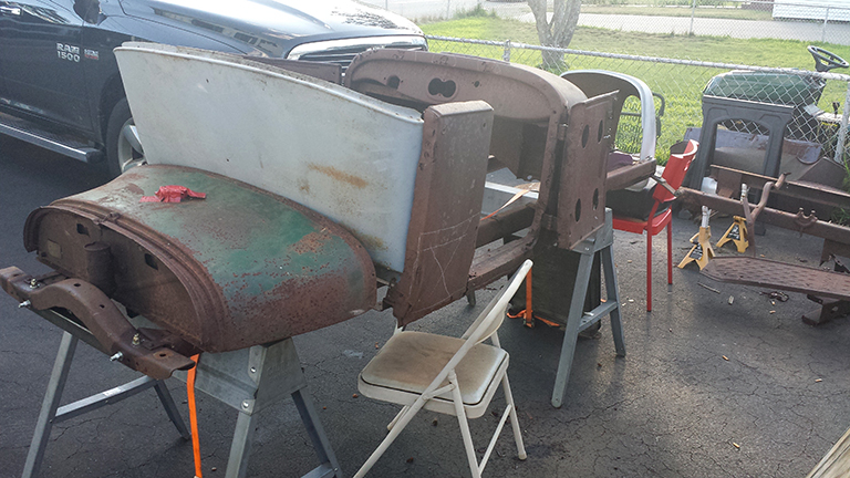

    I did some puttering around on this little project yesterday. I didn't really get dirty or anything but I made a little progress as far as staging for patch panels and freeing the door hinges.
    I hit the hinges with a can of Ultra Lube when I got home from work and the sun was still beating down on the body. I left it for maybe an hour then came back and worked the p***enger side free with little fuss. The driver side had the added issue of a cracked post flexing instead of the bottom hinge moving. So I clamped some angle iron in there and used a little heat:
    Most of the rest of what I did was tinker around with mockup ideas and take pictures. I'm considering throwing this track nose into the pile.
    20160808_182137.jpg 20160808_182859.jpg 20160808_183023.jpg 20160808_183100.jpg 20160808_183946.jpg 20160808_184209.jpg
    One question I'd like to pose to y'all though, does anybody have any ideas for patching a bad spot like this that's not cutting up another cowl? I'm thinking about putting material underneath and using filler.
