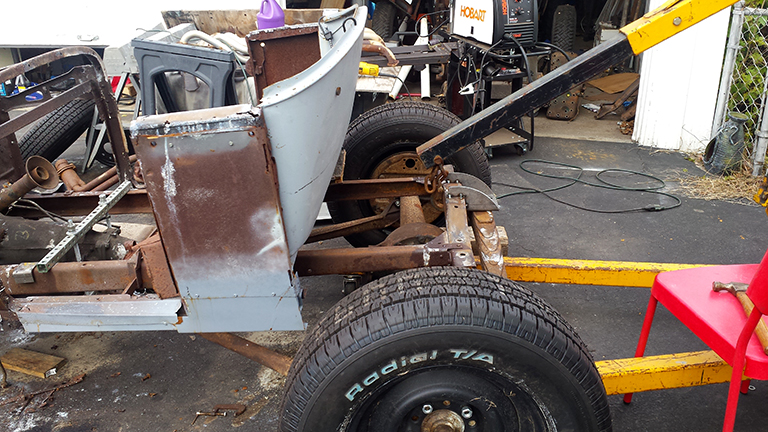

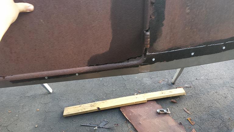

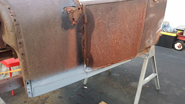

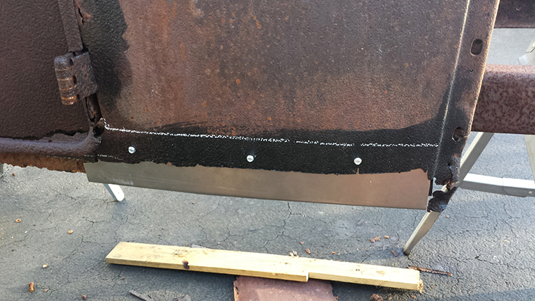

    So, in considering how to deal with patching this tub up and keeping @Six Ball's advice in mind, I came up with a decent idea for supplying patch panels as well as putting them ON the body. It dawned on me that I could use the method that my old timer neighbor, Paul had taught me for sticking panels together without clamps. What he did back in the day was to drill both panels and enlarge the outside hole, then run a sheetmetal screw throug them and they'd pull tight enough to weld.
    So, that's what I've started doing here. This way, the buyer has the option of using them any which way they wish to: as-is,, stepped/modified, welded, filled, on top, or throw them away and start over without having to cut a bunch of tack welds. I should probably grind out the one panel I did tack in for consistency.
    So here are the pictures. I shot them with a bit of primer and sealer since the car is sitting outside and it's fresh metal.

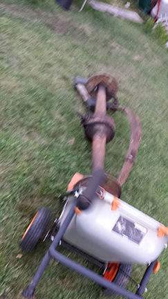

    I pulled some 37 bones, a 36 axle, & a set of F1 spindles and brakes that I had prepped for my original build idea some years back. Unfortunately, I don't have anything to tie it together or steer with like this.
    I forgot that the 36 axle was thinner. I guess some washers would be a good idea here eh?
    Drug the 47 Merc rear out from behind the shed. That was a bit of a chore but at least I'd just cut the gr***!
    This is where I ran out of steam and left things. I needed shackles to put the front end together anyway, so Sunday I went to the swap at NED. I scored some headers for the 265 that I'm dropping in this too!

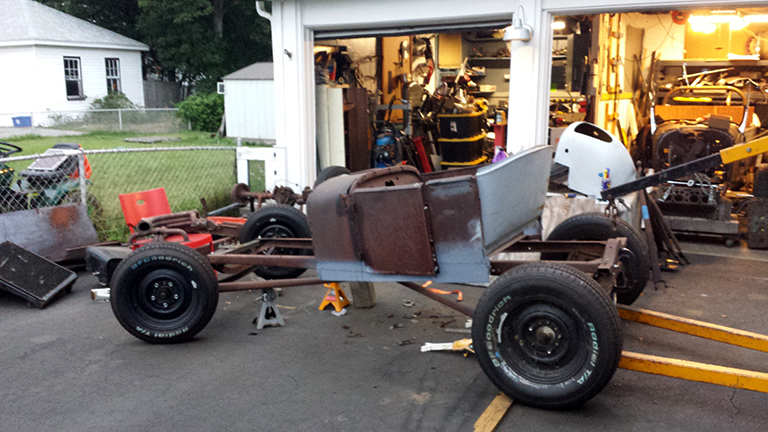

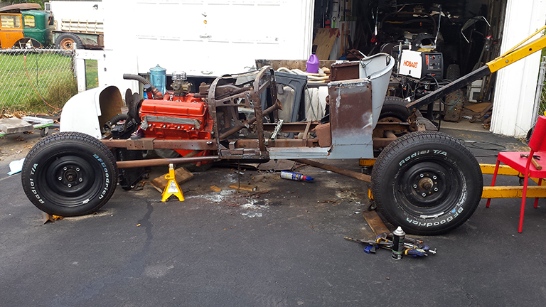

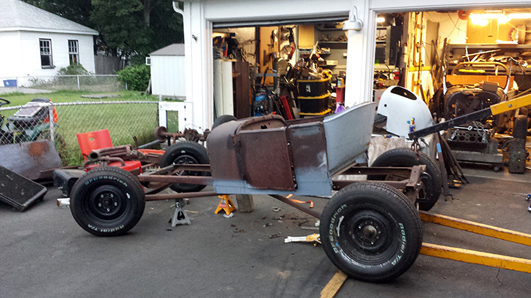

    Well, she's a roller now. And really getting harder for me to part with but I'm going to have to. With some more body work this car will be really something special. I'm hoping whoever takes it off my hands can see the potential too.
    I'm happy with the general stance and wheelbase. I'm sure there will be adjustments needed. I chose a set of 40 rear bones to go on it because they've got more than enough length to work with to make whatever configuration a buyer might decide on AND they're long enough to just connect with the rails at what looks like the right spot to keep the rear end in a decent spot without doing any superfluous work (keeping the canvas blank).
    I think I'm going to have to move the body back a few inches so there's room for an engine and the radiator behind the front crossmember. I'm not doing any permanent mounting though so it's NBD and the next guy can do whatever, which I'm ***uming will probably be modification/boxing of this frame or building another one anyway. I like how the 37 split bones look on this car a lot too.
    I hung the old SBC headers I picked up at the NED swap in Epping NH on there for a little fun along with the little gas tank I've got for it.
    I've just gotta open up the hole in the tube crossmember a little more and figure out a good way to clamp the spring on there without breaking the bank or doing any cutting/welding on the original crossmember.
