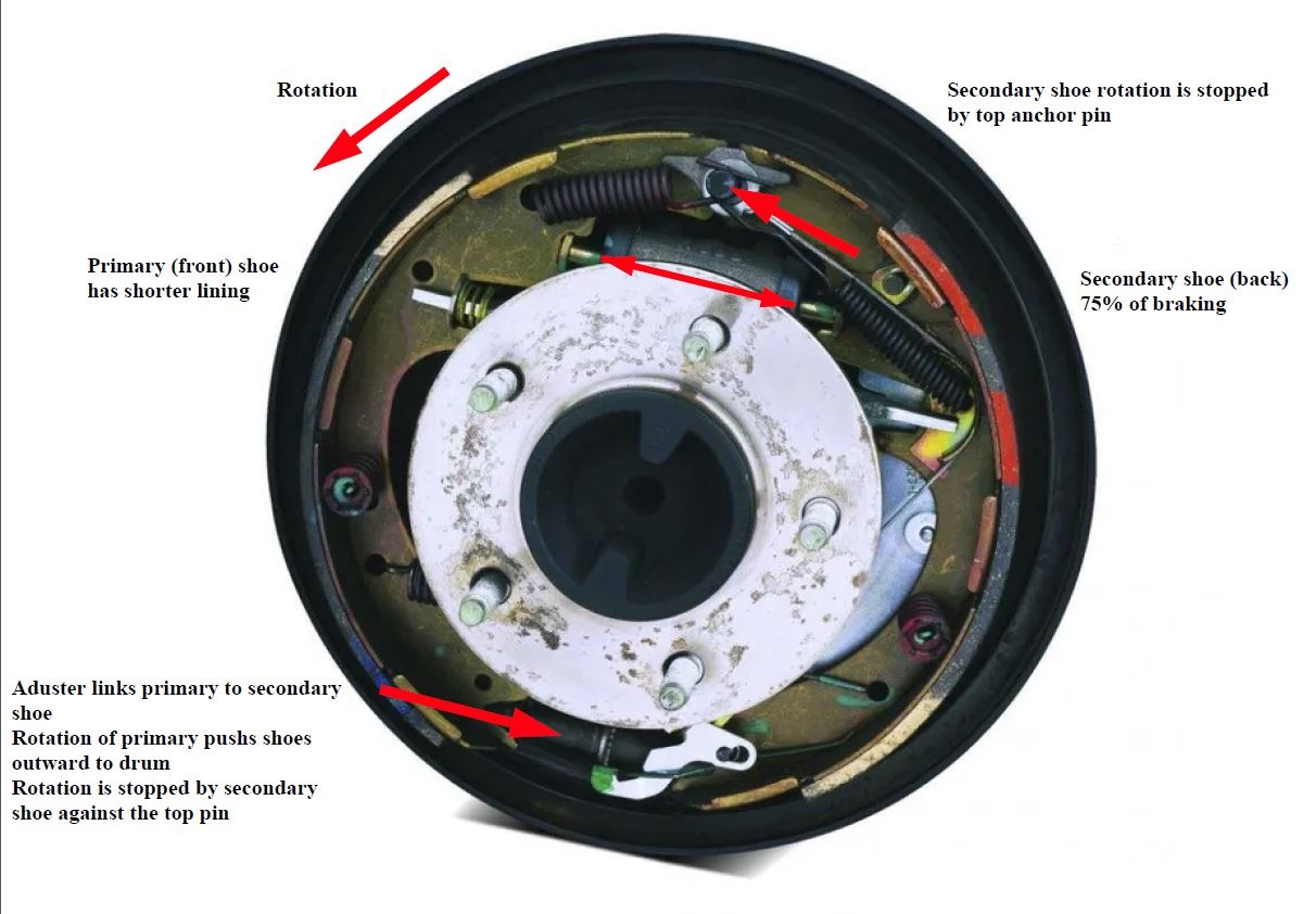

    NOPE don't know where you came up with that ******** but the shoe with the least lining or lower fricion coeficiant always is the primary and goes to the front and the shoe that has the longer or more lining or lining with a higher friction coeficiant is the secondary and always goes to the back.
    Just as on a 4 barrel, Primary = smaller and in front, Secondary = larger and and to the rear.
    I did brake jobs every day for a living for years often fixing one or two that some guy did at home on mondays after they brought the car to where I worked on Monday morning.

    he is talking about 39-48 Ford Lockheed brakes. the long shoe goes to the front on them

    Yes they have a fixed adjustment pin on the bottom. The two shoes act independently and are not self energizing.

    So, typically, longer/bigger shoes on back(on OT cars and "other" makes) but not on the super common Ford Lockheed brakes. On any where the shoes are independently mounted at one end, larger is in front?

    Thanks! That's the photo I should have included with my original post if I'd had the time.

    Drum brakes aren’t hard once one realizes they aren’t all the same, there are different types.

    I actually used that trick this time, and I took a picture! I was just too dumb to notice a different in shoe lengths or widths haha. I’ve also realized that I’ve done many drum brakes in the past with no consideration to primary and secondary shoes. So naturally I’ve been quizzing every man I know if they are aware of primary and secondary brake shoes, it’s about a 50/50 split so far haha
