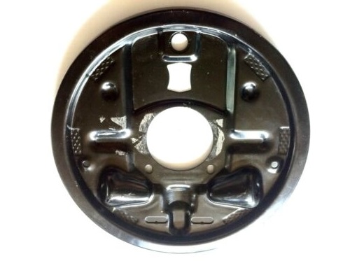

  4. And also notice the shape of the hole the wheel cylinder mounts into that keeps the cylinder from rotating. Even if you did drill holes for the mounting bolts, I think you'll find that the bolt-in wheel cylinders are round where they pass thru the backing plate.
    :oops:
    https://www.jalopyjournal.com/forum/attachments/backing-plate-jpg.5623424/
    GM had a service campaign kit for this problem years ago. It consisted of a clamp-on retainer for the back of the backing plate to retain the cylinder. By their appearance they at least looked more suitable for the job than the push-on clips. Plus this "field fix" allowed the dealers to affect the repair without having to replace the backing plates and wheel cylinders.
    I doubt that GM offers the clamp kits any longer. And if I remember correctly, if you ordered new GM backing plates they were set up for the bolt-in style and you had to replace the wheel cylinders as well. The nickel a car they saved probably cost them $20 to repair.
    :rolleyes:

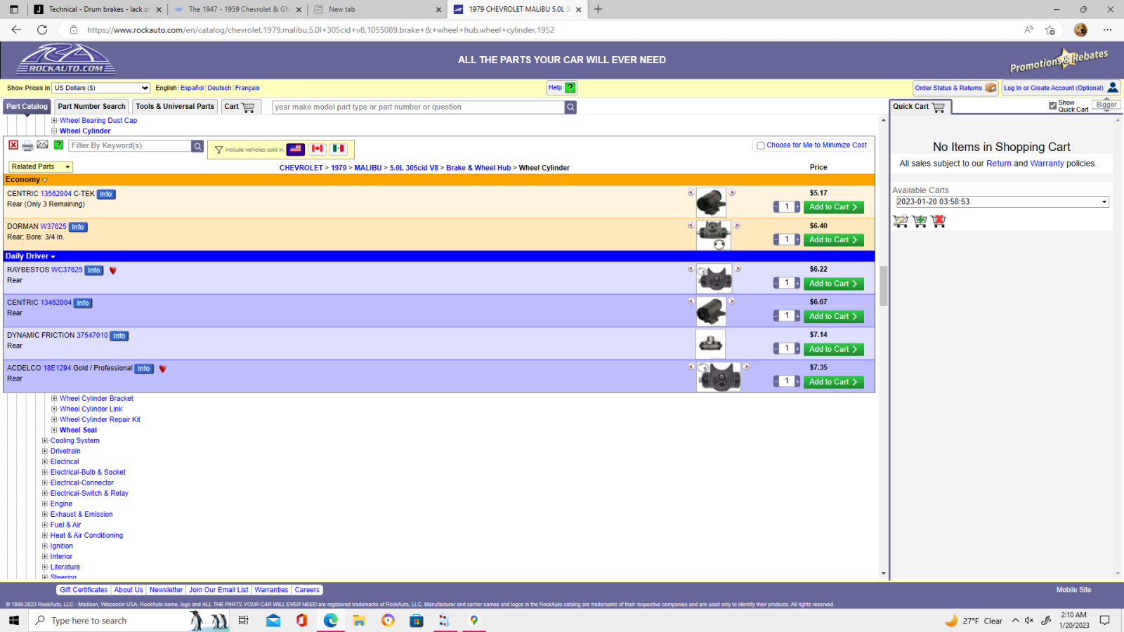

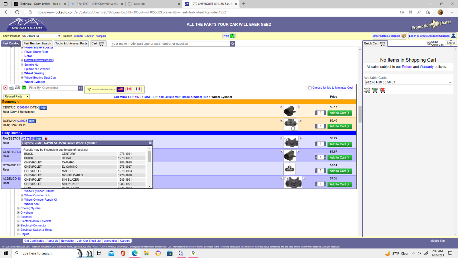

    If you go to the page and click on the part number say (Raybestos WC 37625 a list of what they fit pops up. You scroll that list and find out that they are on one of the more popular "later" rears that guys use right now the S-10 rears. I got out of doing brakes on a regular basis about the time they started using those and have never owned a rig on that list. Mostly G Body, S-10 based and 82-88 Camaro.
    Funny thing is that with all the S-10 frame swaps in Chevy AD trucks and rear end swaps in the ones that don't have a frame swap I haven't seen gripes about rear brakes on them.
    OBTW I looked this up before I saw our post and saved it because the wheel cylinder bore is .750.
    Snooping S 10 rear wheel cylinders 85 Manual brake S010's are the odd duck out and have bolt on 7/8 bore wheel cylinders.
    At any rate that issue has to be addressed before he can decide if that is the only issue.

    In doing a little online research I found that these backing plates have a different axle bolt pattern than any other backing plates. There is no easy way to convert them to a bolt on style wheel cylinder.
    According to several online reviews, the Dorman 924-220 part is thicker and stronger than the original backing plate. So this should fix the problem for a long time.
