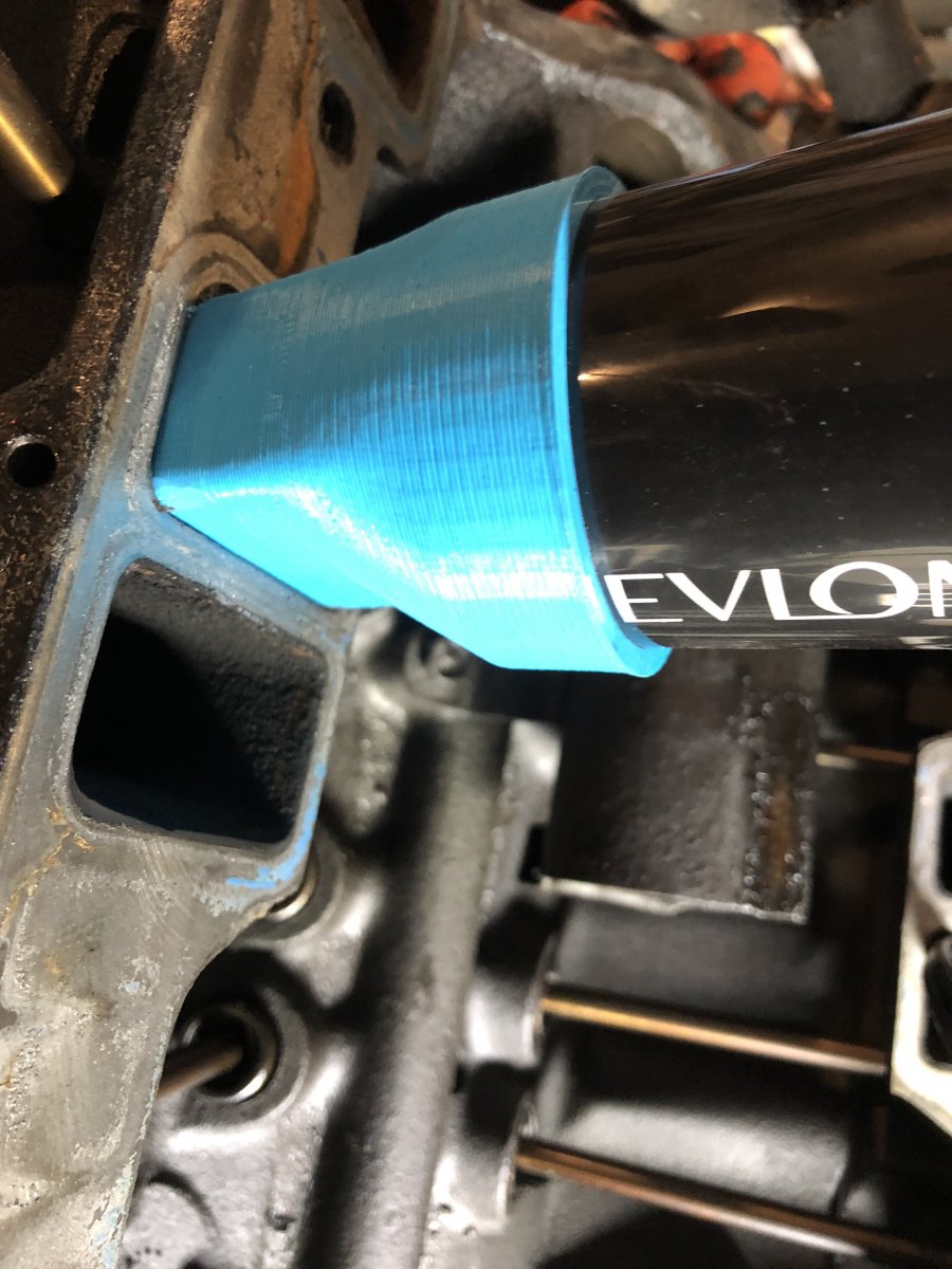

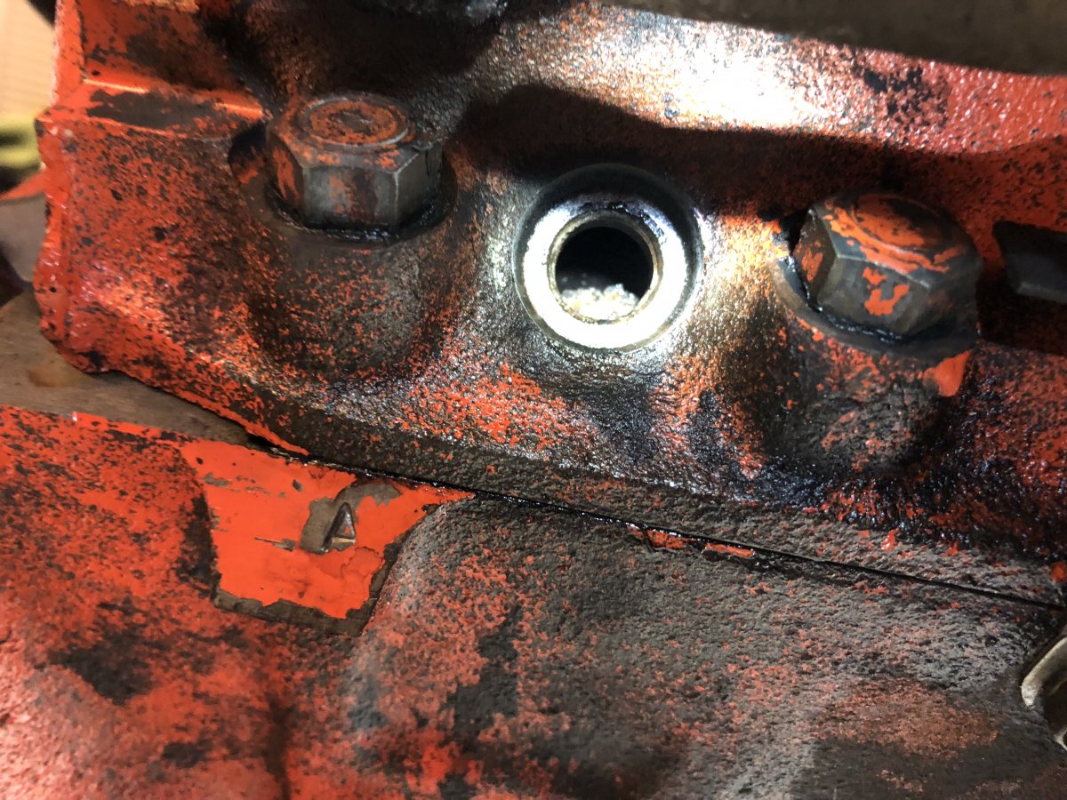

    Before offloading my new 327 from the trailer, I sealed it up and ran to the car wash to knock off anything loose. It looks like my seal under my lifting plate on the intake was not as tight as I thought.
    Now it is in the process of being checked out so I can feel comfortable firing it up. Turning the motor over via the balancer, it went a quarter turn and stopped. I went back about two thirds and again stopped. Now I am starting to worry. I turn it back clockwise and take a peek in all the cylinders via the plug holes. Saw something I had never come across.
    Snow cone in aisle 2!
    So now I have this McGyver’ed up solution. Crank the motor until the intake valve is open and insert...
    $10 blow dryer and a 3D printed adapter - viola! I guess I have to seal things up better next time!
    Time for some penetrating oil ‘til things go back together.

    If you haven't already I'd soak it down with W40. If you have a way to hook a starter up and spin it I think I'd do that with all the plugs out to blow out any moisture too.

    Darn, you kids know how to make all the stuff to make life easier, that is a pretty elegant solution. Well played!
    xnology likes this.

    I’m going to go get more WD40 tonight. I am going to go through and “defrost” all the cylinders before I hook up the remote start switch.

    I think others have it right....plenty of WD40...but I'd hand spin it with the plugs out...then drain the oil...then try to warm that baby up so if any water is left it'll evaporate.

    I ran the dryer in each cylinder for about 30 minutes between yesterday and today. I then shot more WD40 into the plug holes right after drying each one so I should be good to go. While cleaning out my oil pan and I found some lovely pin holes as I was finishing up, so a new pan is in order.

    This probably is a better way to get the engine warm. Could throw a tarp over the engine so that it seals to the floor & cover with a sleeping bag or something that will hold the heat in. Then put a heater under the tarp for a few hours to let the heat soak in & warm the entire engine up. Just be careful & make sure there is good circulation around the heater & nothing touching the heater. A few hours should take care of any ice faster than trying a hair blower.
    A thought on a non heat method that may work.
    Isopropyl alcohol is used as a gas line antifreeze & is very effective at eliminating ice. We used the iso as snow machine fuel antifreeze as it was friendly to gaskets & fuel lines. It is fairly common in Canada as as a gas antifreeze. If an auto store or fuel station near you does not carry Iso as a gas line antifreeze then it is sold as rubbing alcohol in drugstores for foot care in 70% or 100% concentrations. It will melt the ice & mix with the water to stop it from refreezing. If you drench the cylinders a few times with isopropyl alcohol then let it sit the alcohol will take the water with it to the bottom of the oil pan. Drain the oil & put fresh in as you should anyways. Spray WD40 or pour some oil into the plug holes to re wet the cylinder walls with oil. Crank it over with the plugs out so the oil wets out the cylinders to protect them & let the oil work past the rings.

    The blow dryer dried everything out. I am going to braze the holes in the pan to seal it up and re***emble tonight.
    I hope to start it up tomorrow.
