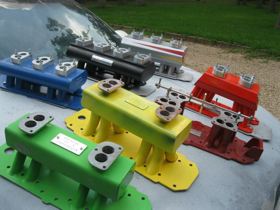

    A129B7E9-9073-4C3C-B05A-885CB77C37B7.jpeg 180F322B-AFAF-4062-AACA-F778518E0F8C.jpeg 85C35618-EB0C-48F3-B998-3FAA59781276.jpeg D8678C81-2DDC-438D-9568-3F150AC5304C.jpeg The Edelbrock slingshot(Y shaped 2-2intake) was a****st the best producer of horsepower,the tall neat looking Thickstun was 19 h.p. Less than the Slingshot and flows terrible.

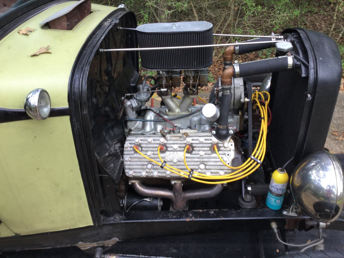

  10. Charles, I had a relatively Stock 8BA with 8RT heads on it. I ran an original Edlebrock Slingshot. One carb was hooked up, other had a plate under it. It ran great. I highly recommend the Edlebrock Slingshot intake.
    Later if and when you decide to run both carbs you can address the distributor issues. Flatheads dressed up with the slingshot intake are great looking motors. Here is one by member @NealinCA
