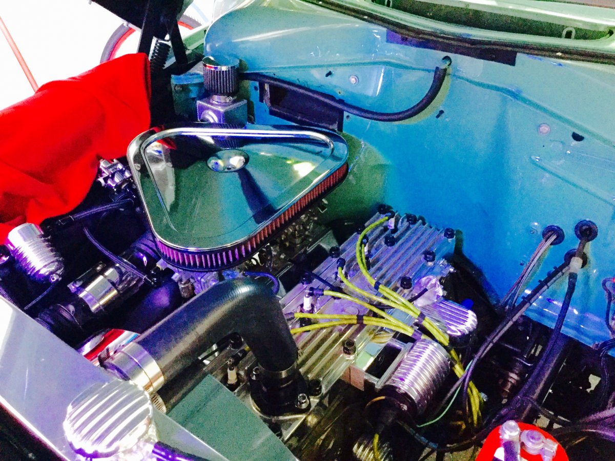

    753259FE-446D-4CF0-906F-9AF88BF34E54.jpeg Had almost the same experience with those carbs from Tom and once I got the right filter and trash out of the carb things have been fine. Really made my old wagon perform

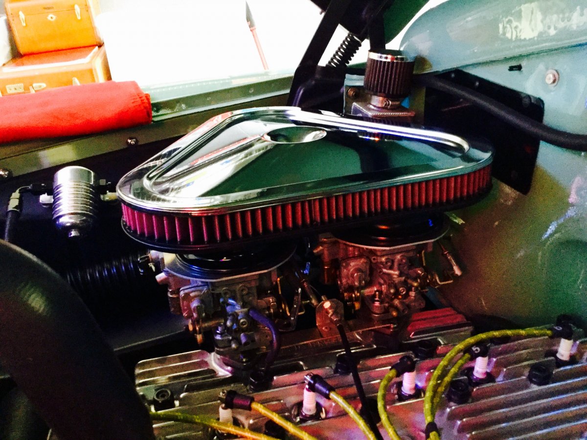

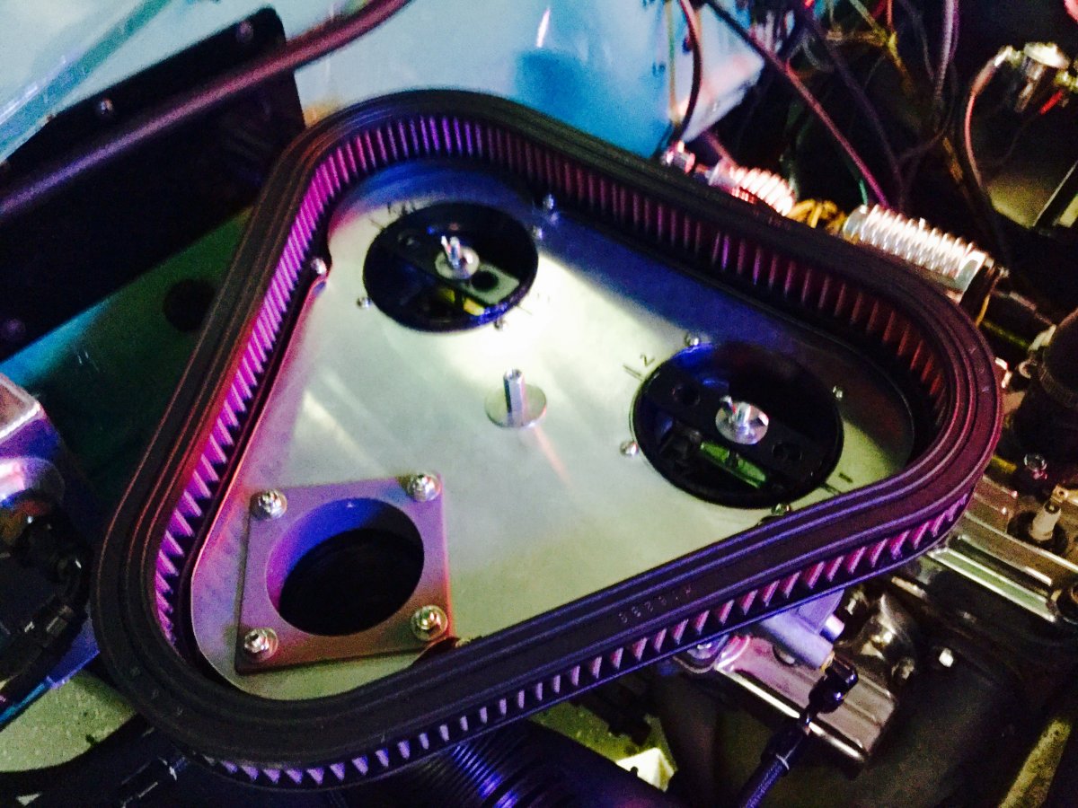

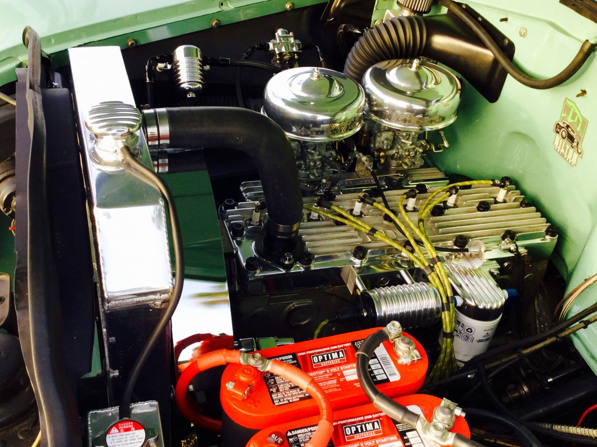

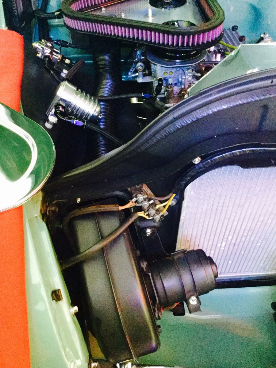

    0D82CB44-F7EC-4A7C-98D4-3088739B6145.jpeg DA490DF8-7A82-414A-913F-6640474AA582.jpeg F5CC7366-8FDA-4D16-9D09-C203E7BE4A8C.jpeg C705938D-72DF-421F-B78B-6D73D6D2E0CE.jpeg
    Had the small air cleaners that Tom sells but after returning this year from the hot rod power tour I decided to make a better mouse trap so I started with a 69 big block tri power vette air cleaner and made a new base and added a fresh air inlet and some carb inlets and now I have cool air to my carbs
