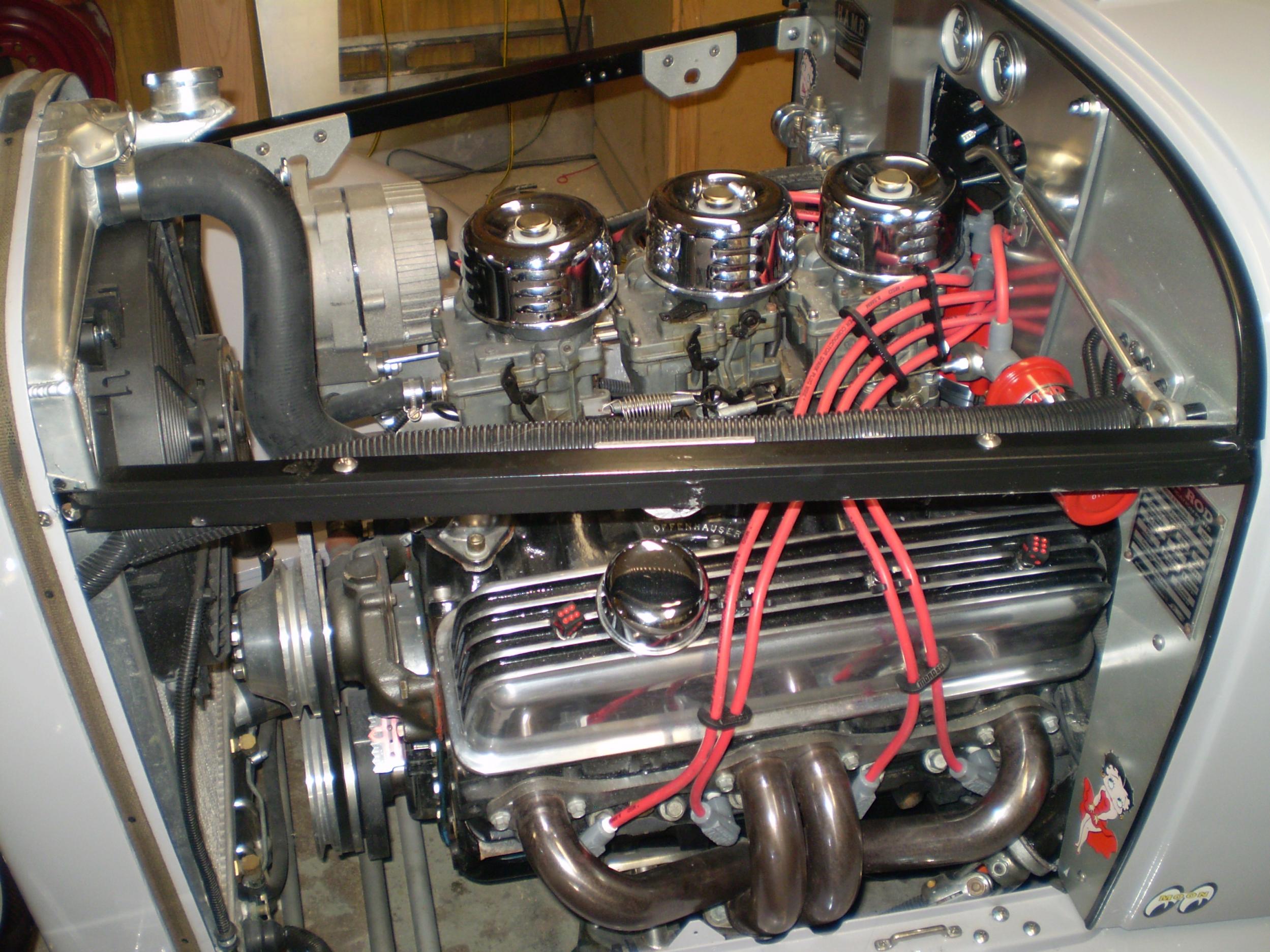

    I ran 3x2's on my 46 for about 12 years and currently have a set on my T.
    If you set them up with the correct end carbs and run progressive linkage, they are great. If you try to go cheap and use regular carbs for the ends, they can be a bear to tune. It helps to keep the fuel pressure down to about 5 PSI, too.
    Three small rochester 2G's are only going to give you about 600 CFM or so. Perfect for an engine in the 327-350 CI range.
    BTW - Just responding to the poll, can't help you with the 2X4's.

  27. That's the best part about tri power, all you have to tune is the primary. On a "correct" tri-power set-up the end carbs should not have idle circuits in them. You run off the center and bring in the ends as you see fit with progressive linkage. I've been running tri-power on all but one of my cars since 1966 and never had a problem as long as I used the right end carbs. That said, I think if he has a dual quad set-up he should tune it, rather than switching and spending more money.
