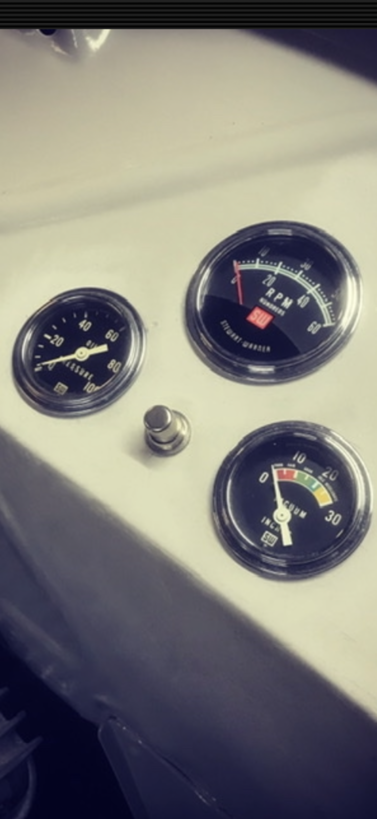

    That’s the style ****on I’d use. What don’t you like about it? C82E5D42-26A0-404B-B528-575C8F9A2B4F.png

    That's a pretty nice setup. I see nothing wrong with that ****on. I like gauges in the firewall. Thinking about doing it myself and thought about a starter ****on. And maybe add a kill switch. Wiring for those would be pretty straight forward. But then I got to wondering if it might be possible to wire a whole 'nother ignition switch somehow wired like a 3-way light switch in the house. I am not electrician enough to even start to figure that out. Would it be possible?

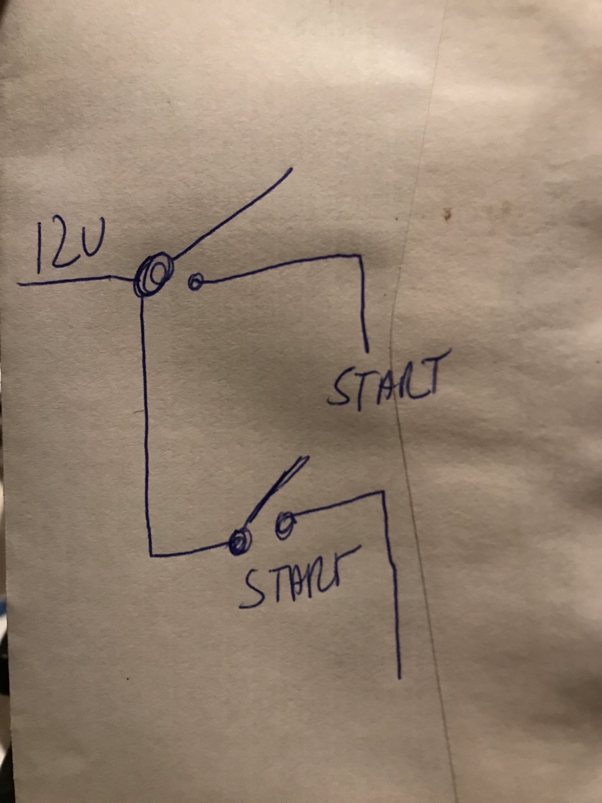

    Sure, just wire the two switches in parallel. Either switch will start the engine. They are normally open contacts with a momentary contact. They need to be held closed until the engine starts.

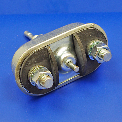

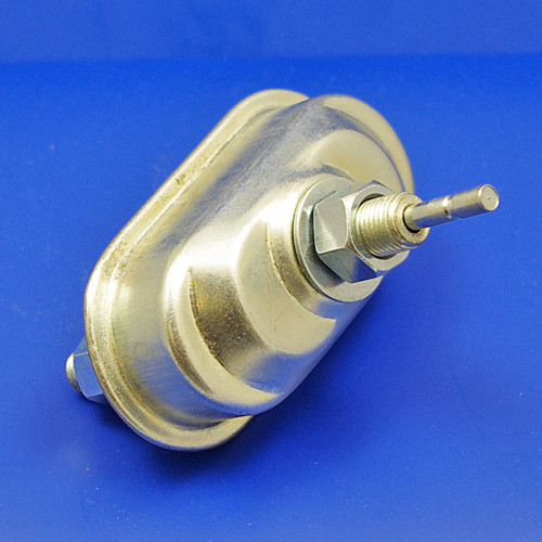

    Looking for an alternative for looks or function? Always liked these....you can find them with black or chrome ****on. Made as repops too but not the same look as vintage.

    OK! I probably got this all wrong, but let me try. So, I wire from the 12v input of my current ign switch to the input of the 2nd ign switch , then wire from the 2nd switch to the solenoid for start and run a wire from the switch to the coil for ignition. Correct? What if I left the firewall switch on and started the car from the dash? or vice versa? It wouldn't burn anything down?

    If you have to turn one switch on to activate the other switch, that would be a series circuit. If 12 volts were run to each switch and no connection from one to he other, that would be parallel.
    Now you could do parallel from one switch to he other by going from the hot (non switched side) of the switch to the other hot (non switches side). Both switched sides would then go to the start circuit.
