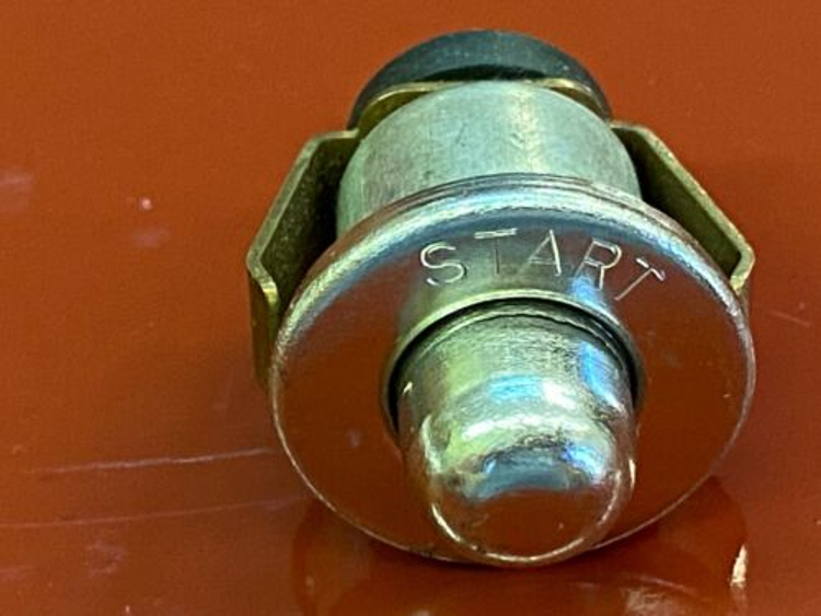

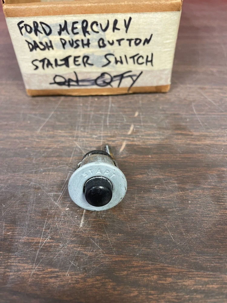

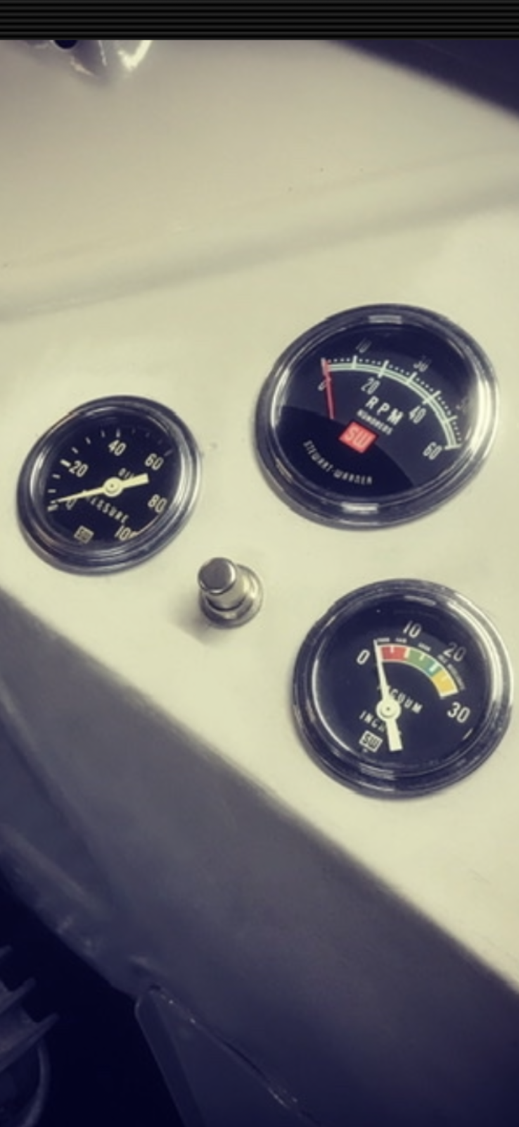

    Wow guys, loads of info, I didnt think Id get much. The cars a manual trans, but you're all right, I'd need to make sure. As mentioned, the ignition would have to be on to start it, otherwise it would only turn over.
    Really like the 'push-pull' switch, not sure i'd be able to reach it from the drivers seat though.
    It feels horrible, really 'graunchy' when you push it, and the finish is a bit 'cheap', and the lock nut that holds it in is just a pressed piece of thin metal that distorts and jumps threads, so doesn't lock up, generally its a bit rubbish .
    Thats a nice one. I like the stock switch as well, but was told it wouldn't work in this situation.. I might need a bit more info, Im not any kind of electrician..
    Looks like my stock ****on, but was told it wont work? This would be my preferred choice though.

    So is this completely independent of any of the existing starter switch/ignition wiring? Looks like an add in that looks after it self, doesn't need wiring in parallel to the start ****on in the car..?

    I vote for the stock style Ford solenoid with the manual ****on to bump.

    It's on a cable (11475 below)
    I have seen them on rods too. Mike
