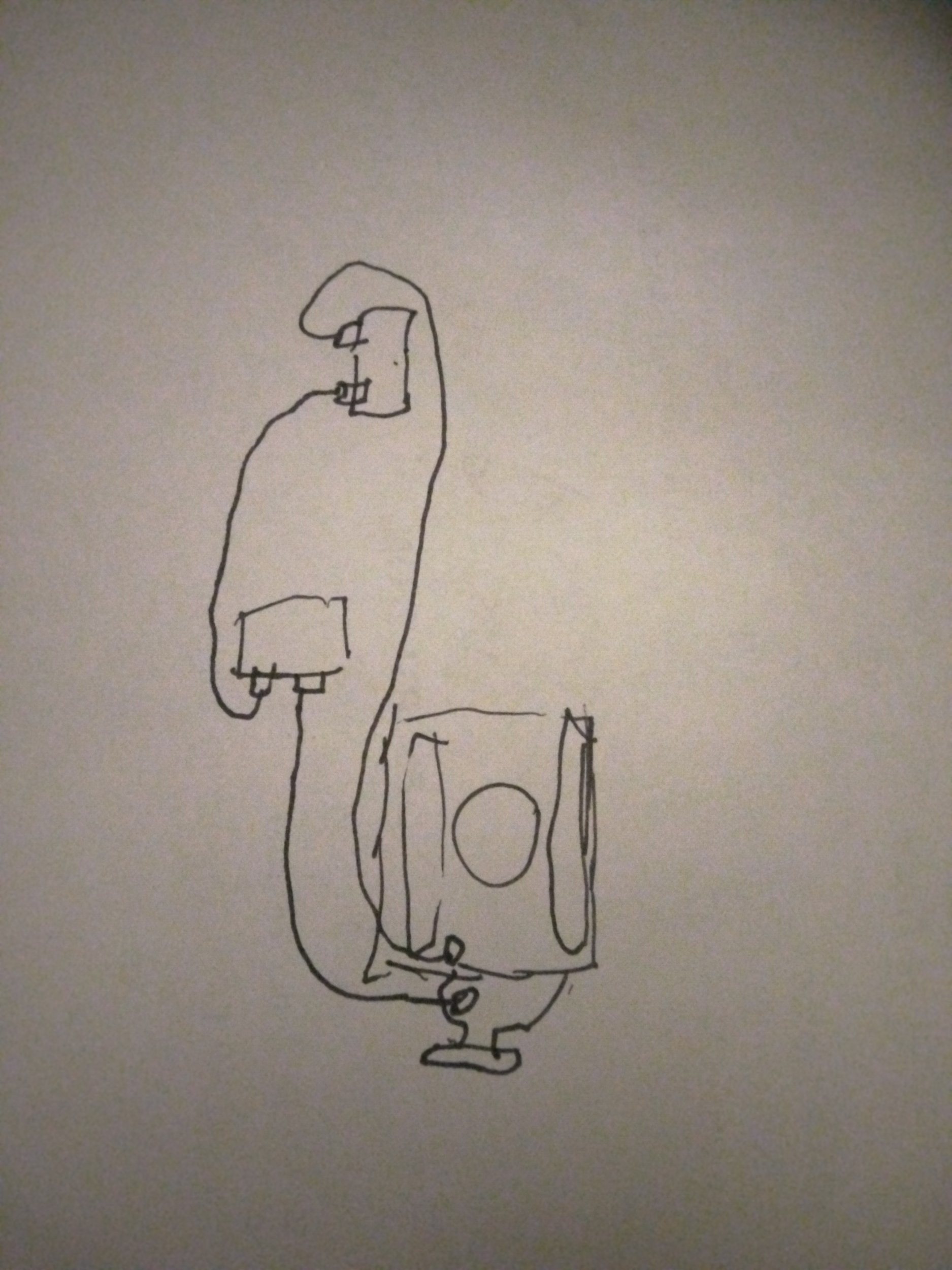

  1. So like I mentioned after getting a working heater in the 53 I decided I'm going to put an additional heater under the p***enger seat to help distribute heat quicker as I'm not adding dash vents and that's a lot of interior to fill lol. Originally I figured I'd t the lines at the firewall and run them that way. But then the idea to run the cores in parallel instead. Would greatly simplify routing. I know it'd take longer to get hot but I was thinking I could run an inline electric water heater like I saw on an international 674 tractor I built. Be fewer fittings to break or leak etc. Also feel like filling it with coolant from empty would be easier. Take a peek at my finely detailed and 100% perfect scale diagram of how I'm thinking and see what you think lol IMG_20250119_203846_HDR.jpg

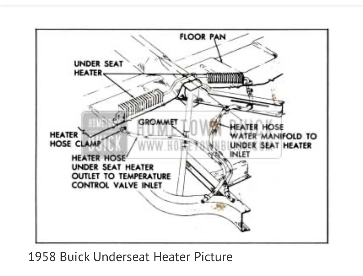

  3. Photos for both heaters installed show broken links

    I have dual heaters in my Buick and Wagoneer. Both are plumbed like you have drawn. They warm up just fine. Go for it.

    My 55 Buick that I had back in 1966/67 had an under seat heater that kept the car toasty in the winter and people who rode in the back seat always mentioned that it was the only car they always were warm in in mid winter. I never had to deal with the hoses but figure that they were just about the way your drawing runs.

  7. chevy57dude

    You draw better than I do. Looks like it will work, your drawing shows the cores plumbed in series, not parallel.
  8. Diagram is in series, not parrallel

    At the school bus garage I work at, we have 2014 Chevy vans, and a bunch of 72 and 84 p***enger big buses. The Chevys have a large heater core at the back of the bus that uses Y fittings off the factory heater lines. No extra pump needed, the engine water pump is enough to get heat to the back.
    On the bigger buses, the heater lines run from engine to the rear most heater core, midway they T off to the mid-bus heater core. The mid-bus heater uses two " T " fitting with a restricter in one of the hoses. The restricter forces most of the coolant to the back heater core, the hoses are 20+ feet long each way. They all have 4 heater cores using T fittings off the main lines. Onced up to thermostat temp, all the heaters put out the same temperature air with up to 8 blower fans running. There is electric booster pump on the hot side pushing water to the back. The entire cooling system holds about 9 gallons of coolant.
    Yours will heat just fine with no other pump or heater needed. Add a bleeder similar to this under the seat, https://www.z1motorsports.com/z1-pr...58-aluminum-coolant-bleeder-port-p-19840.html .

    I did the same as you drew for a car I built long ago. Worked great and both heaters heated equally.

    Nearly all the modern dual heaters that I have seen use a "Y" split point on the inlet side and another "Y" on the outlet side. Those modern heaters run in parallel to each other, and the rear heat is always on a slower fan setting.
