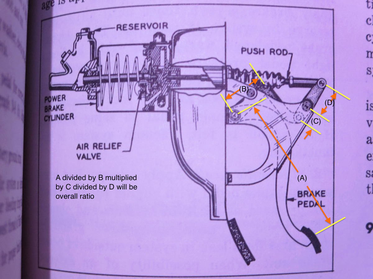

  6. Saw that, didn't believe it for a second, then looked at his diagram. That diagram, as posted, will NOT work. The pedal has no pivot. For the brakes to work, the pedal has to push the first lever, which pushes the second pushrod, pushing the second lever. As drawn, it won't do that.
    So, let's go old-school: measure the total travel of the pushrod. Then, measure the travel required of the PROPER master (which travel may, in truth, be similar to the one you have). If this matches fair reasonable, you are good.

    The diagram is not correct as marked - you skipped a pivot and couple lengths for the links. We could review all that and do a bunch of math - OR- let's skip directly to the answer: There is no free lunch! Meaning put as many links, pivots, bellcranks whatever you can think of it all boils down to one thing ( ok 2 things) - how much MOVEMENT IN versus how much MOVEMENT OUT (perpendicular to the pivots of course)- THERE'S the ratio - everything in between is just "noise" and is only good for confusion. If I push the pedal 6" and the mc plunger rod moves 1" the ratio is 6:1 - doesn't matter how much clap trap is in between.

    This is my pedal ***embly. Not sure how I'd make the mods you were mentioning with the way it is designed... pedal 2.JPG

  14. Here is the missing 'link' to this diagram: The 'pivot' at 'A', is not a strictly a pivot, it is also where the link 'B' is welded to the brake arm. The pivot 'B' is not a pivot, it is a stop, which keeps the pedal arm from over-retracting. With that in mind, the diagram now makes perfect sense. And the pedal ratio math is all wrong.
    It's NOT 2.4:1.
    Cosmo
