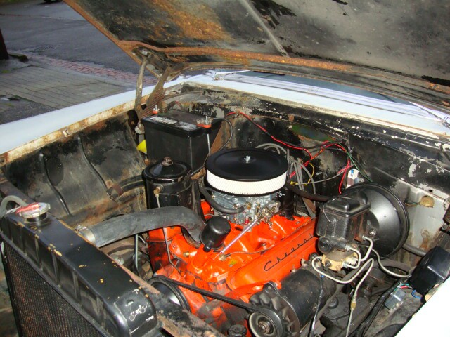

    Here is a pic of my 56 Nomad which was converted from treadle vac system to a diaphram booster. You can see the hole in firewall where the old treadle vac was mounted. The new booster/master cly. is mounted in the same place as where a manual master cly. would have been mounted.

    Sweet! And did you change the pedal ***embly?

    xracer40
    Yes, the pedal ***y. was changed to the factory manual brake set up. 55-57 chevy pedal set ups are relatively easy to find. 58's are much harder to find and can be pricey. If I were you I would snag the one you have access to in a heart beat.

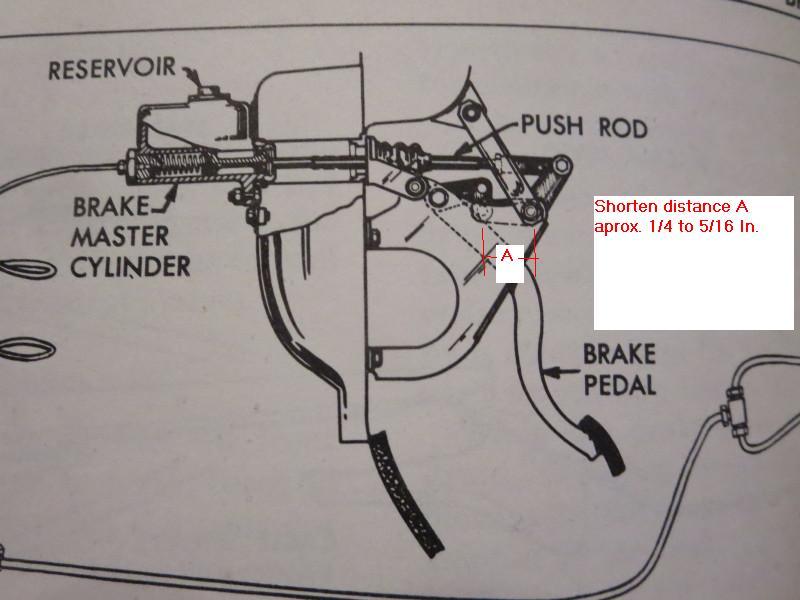

    I just got the manual brake pedal in. Took a short video of it in operation. Most of the literature and the manufacturer for the booster/master says that the ratio needs to be 4:1, so is it possible the 6:1 on this pedal will be too much? If so, is there a way to knock it down?

    For sure, just curious if it's easier to knock a ratio down or lessen it's effects as opposed to my old pedal with too little ratio.

    xracer40
    I would try it first, I think with the 8" booster you have a pedal ratio a little more than 4:1 will be ok. It would be pretty easy to reduce the ratio if necessary. Doing a little hillbilly reverse engineering from the drawing you posted of the manual pedal ***y., you would only need to relocate one hole aprox. 1/4 to 5/16 of an inch. This should reduce the pedal ratio from 6:1 to 4:1. You would need to weld up the old hole before redrilling the new one. Of course you need to do the actual measurements but I believe I am pretty close.

    gimpyshotrods
    I'd probably just run it as-is.
