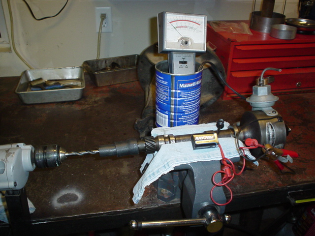

    BobbyB,
    Have FUN??:confused: with the dual point set up!
    I finally figured out the Accell D/Point dist.I have.The second set of points opens while the first set is still open, this fires the coil,so to speak.
    To your question,set static timing off opening of second set.When the circut opens.
    I dreamed up a "poor boy" Sun machine to set mine up off the engine.
    A vise,elec.drill,some rubber hose,C-clamp,9 volt battery and dwell meter.
    See photo below.:eek:
    All that said, if you can run 12 volts on the engine get a set of top line points from NAPA,dual spring them and run a single set of points.
    Well enough from the geezer section-------
