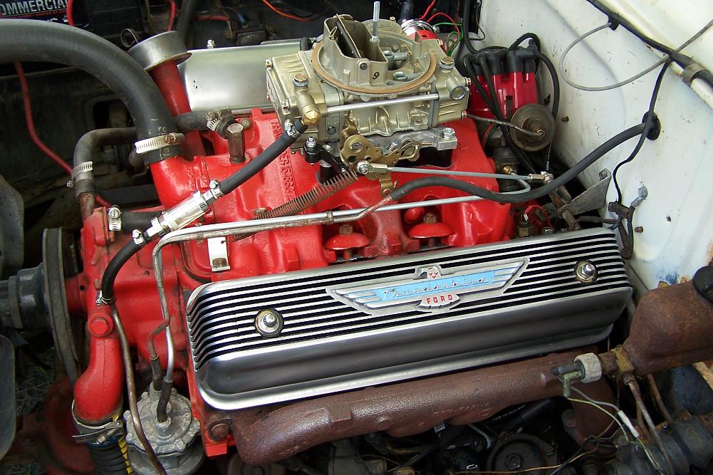

  10. That's what I did. Got the rod at Lowe's and the ends at Graingers. Simple ordeal.
