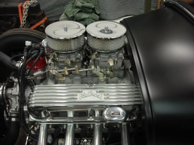

    You won't have any problems. I'm running two 1406's on the 331 stroker Ford in my 27 and both chokes are wired open all the time. Even though I live in Florida it does get into the 40's some times and it still fires right up and idles down immediately.

    good deal man, 1200 cfm on a 331? seems a bit excessive but cool none the less
