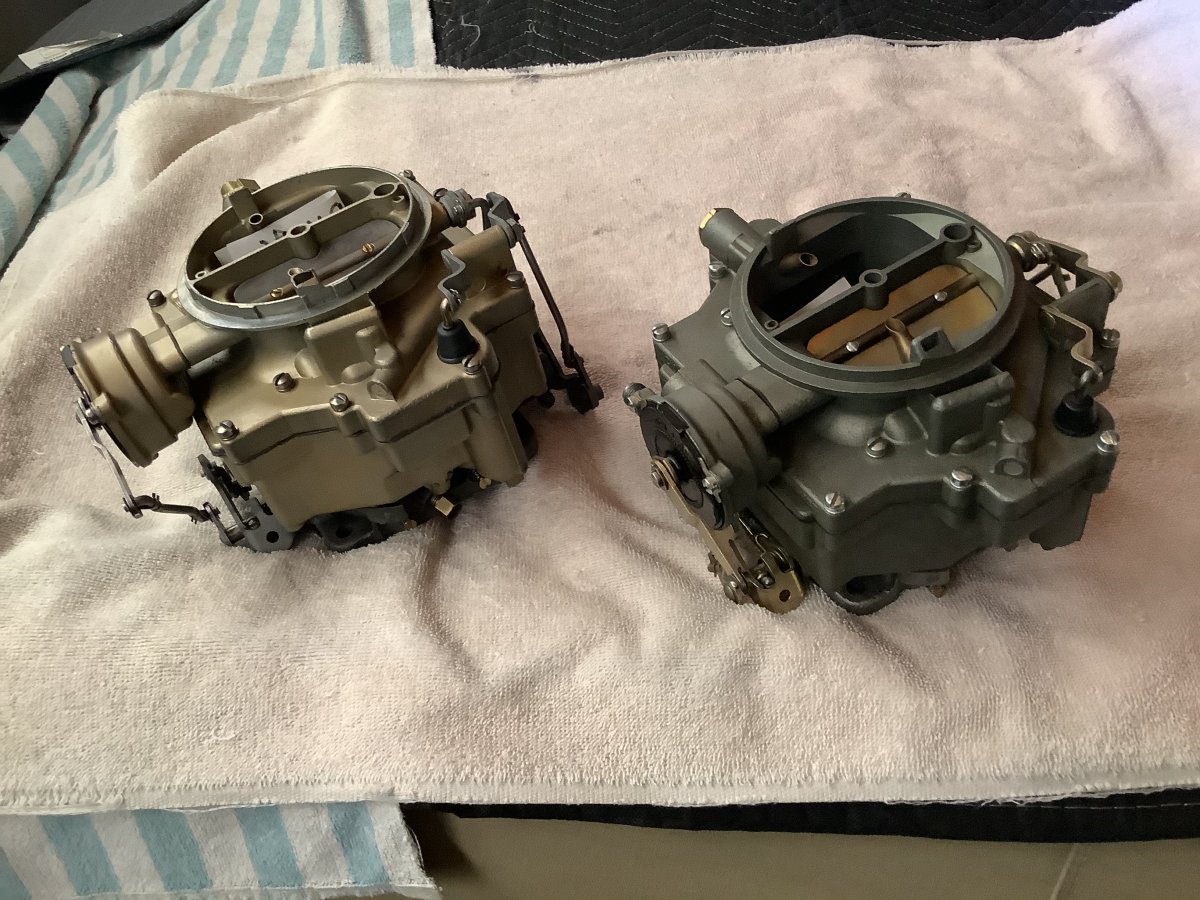

    Jon, I don’t want to highjack this thread but some of the 56 Mercury’s 260 HP over the counter kit did use WCFB’s because one of the ***embly plant for 56 Mercs used Carter’s and were “stock” parts so NASCAR allowed them. They too like the Holleys were to operate with the Loadmatic distributors and are hard to find since the vacuum signal came from both carbs. They too have the vacuum can operated secondaries along with a few Lincoln’s.
    I have a Merc and Lincoln Carter WCFB’s in my stash. They both have an aluminum base. I’ve also a set of 1953 Cadillac Rochesters with the same #’s. They are not dual quad models. I should sell all of these as I really have no need but they fit the flathead and GMC aftermarket intakes too. These just a portion of my carbs and parts.
    As a note when I bought my 56 Ford the first thing I did was install a 57-up distributor and a 53 Cadillac WCFB. The fuel inlet was in the rear and I only needed to make a small plate to screw on the the linkage for it to work. Used that for 4 years until my dual quad conversion. Also the Ford 56 dual quad intake and the Edelbrock placed the rear carb in a slightly different place but was very similar to the 255 Eddy. In 57 Ford lowered intake I think as a different valley cover was needed.
