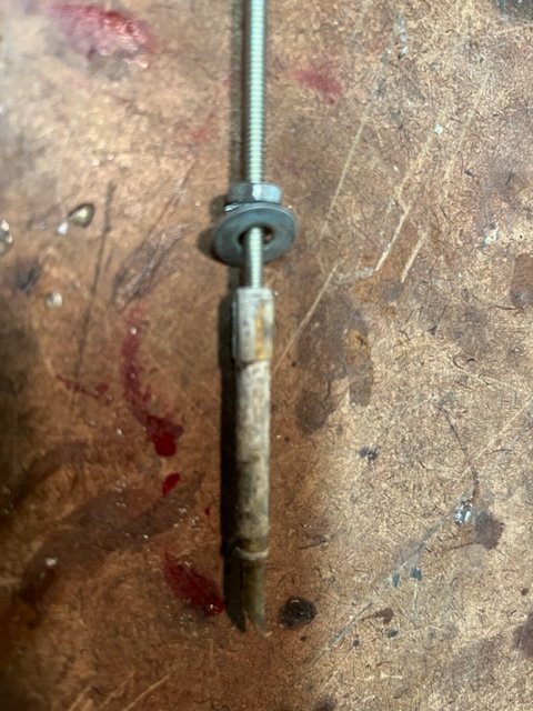

    Finally got the new internals for the carbs. Pulled the emulsion tubes and they were coated in crud. New emulsion tube replacements installed. Even though they are new I also replaced the accelerator pumps and check valves. Checked float levels. Staying with the 43 main jets and 69 power valves. Have an ***ortment of jets coming this week so we shall see. IMG_3031.jpg IMG_3034.jpg IMG_3031.jpg .
  27. alchemy
    Joined: Sep 27, 2002
    Posts: 22,831
    alchemy
    Yikes. I thought you said they were removed and cleaned before?
    Also important is to clean the cavity around where the emulsion tubes fit. A brush is required.
    Airborne34 and Moriarity like this.
  28. This shows exactly why you have to remove the emulsion tubes to rebuild a Stromberg 97. Unless they are clean and all the small holes are open, the main venturis will never flow correctly. This is a very common problem with folks who are doing their own at-home rebuilds . . . they neglect to perform this vital step.
    caprockfabshop and Petejoe like this.
  29. hotrodrhp
    Joined: Sep 19, 2008
    Posts: 456
    hotrodrhp
    from Wisconsin
    Carbs were rebuilt but not by me
    winduptoy likes this.
  30. alchemy
    Posts: 22,831
    alchemy
    Sorry I ***umed it was you since you described the work and said you are meticulous. Maybe you should “out “ the rebuilder so nobody else gets taken.
