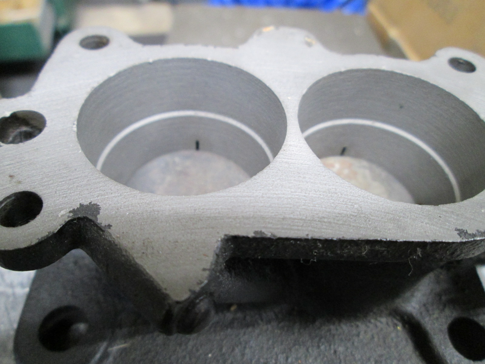

    I'm not that computer savvy to properly show this, anyway here is a rendition of the 'transfer slot'
    It shares the same feed as your idle circuit. This transfer circuit is aligned to the throttle blade, when holding the carburetor upside down the transfer slot should be slightly exposed (they reccommend the hole to appear as 'square'), this circuit sees vacuum with the throttleblade closed and fuel p***es thru the exposed hole - if you look at a used carburetor that area will be washed clean. As the throttle is opened the transfer slot has greater exposure to engine vacuum and greater amounts of fuel will flow - all of this happens in microseconds and quan***ies are very small - when the throttle blade p***es the transfer slot the vacuum is not great enough to get the fuel to flow and the main jets have begun to flow. You idle circuit sees the same vacuum and has been supplying fuel metered by the adjuster screw. The purpose of the transfer circuit/slot is to provide fuel until the accelerator pump shot has happened. If this circuit is not working right the motor will have a momentary lean bog until it gets fuel from the accelerator pump.
    This photograph is your Stromberg looking in from the top to see the size of the transfer slot It differs from the illustration in that the idle circuit and transfer slot are on the same side, the idle circuit is below the transfer slot (this is true with all the carburetors I know of, I think the illustration separated the circuits for clarity)
    This photograph shows the carb from the bottom as you'd see it before bolting it down. The transfer slot is seen just below the closed throttle blade, the square hole, and below the transfer slot is the idle feed:
    I hope this has been a little help, there is considerable internet 'information' if you google 'carburetor transfer slot'

  8. alchemy
    Joined: Sep 27, 2002
    Posts: 23,068
    alchemy
    OJ, that is not a Stromberg 97.
    oj likes this.
  9. oj
    Joined: Jul 27, 2008
    Posts: 6,598
    oj
    No it isn't. I was thinking the OP had Stromberg 81's, my fault, I believe the 97's have a series of individual holes instead of a slot.
    Good catch.
  10. alchemy
    Posts: 23,068
    alchemy
    That’s not an 81 either ;)

  11. banjorear
    Joined: Jul 30, 2004
    Posts: 4,885
    banjorear
    Four bolt base is a dead give away that they are not Strombergs. Are those 2GC's?
  12. carbking
    Joined: Dec 20, 2008
    Posts: 4,008
    carbking
    If I get to guess, my guess is Carter WD-0.
    The explanation of the function of the idle transfer slot is very good.
    While the Stromberg EE-7/8 marked 81 or EE-1 marked 97 had a three-bolt mount; MANY Strombergs have a four-bolt mount.
    Jon
