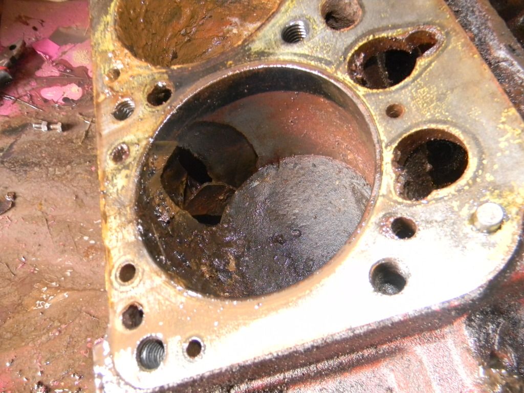

  6. shtterbug8
    Joined: Jul 31, 2011
    Posts: 512
    shtterbug8
    finally got the bellhousing off! there also was a dead snake trapped inside. been there for awhile. small.
    here is a picture of the busted cylinder

    Do a search like- hemi truck heads water. By the way, unless I've missed sumthin it looks like the engine might have been drained and water filled that cylinder- down the intake, an open valve. One busted is'nt the end.

    o im very excited that that was all there was. im going to try and get the pistons out tomorrow....that is if weather permits me. if its cold outside i might keep my **** indoors.
