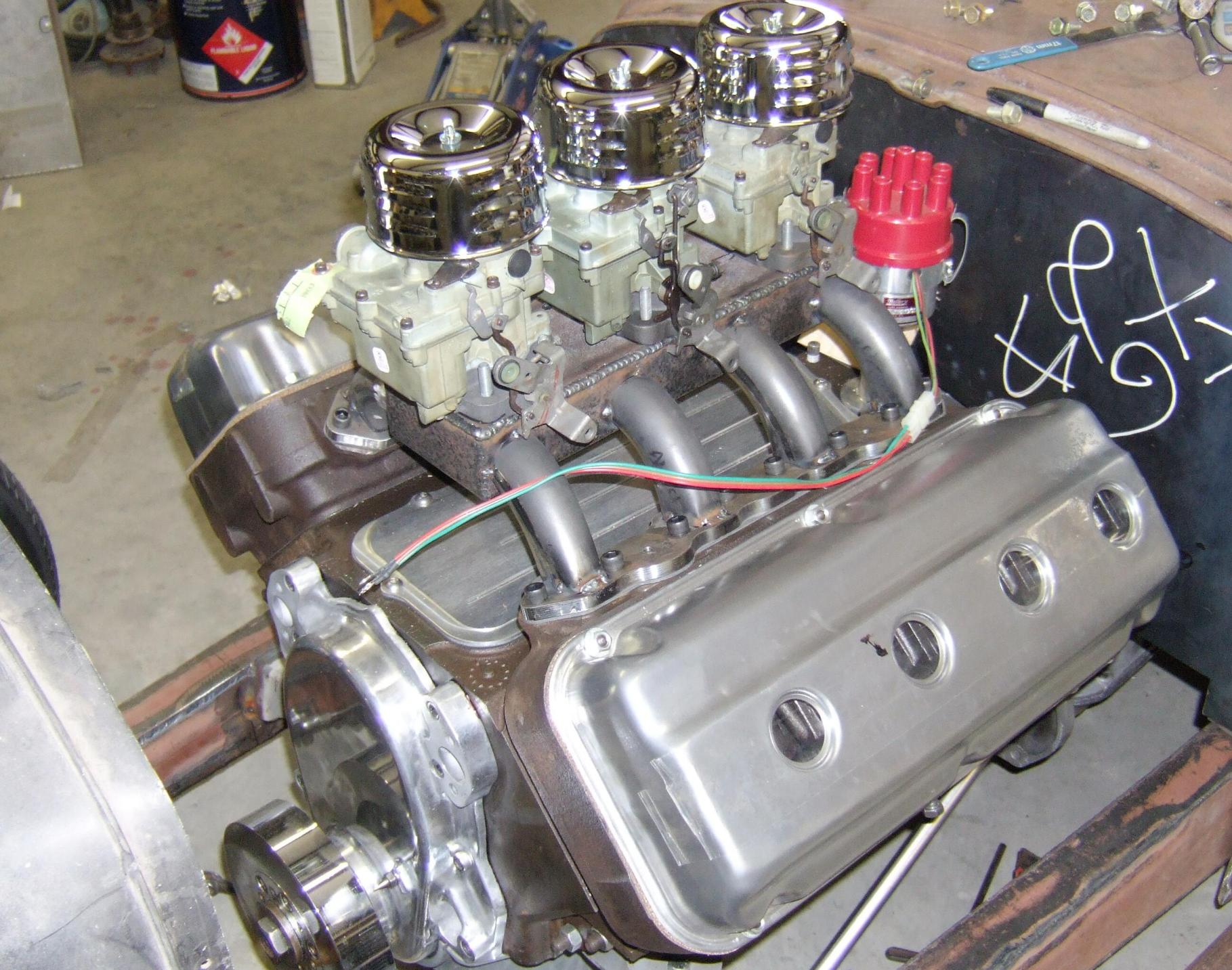

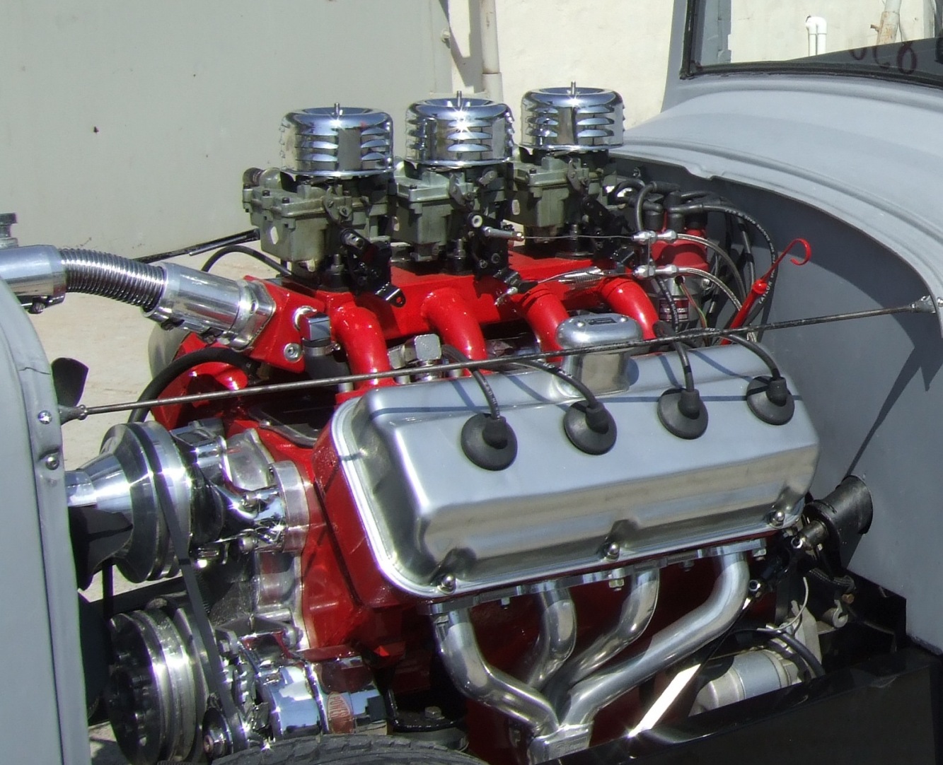

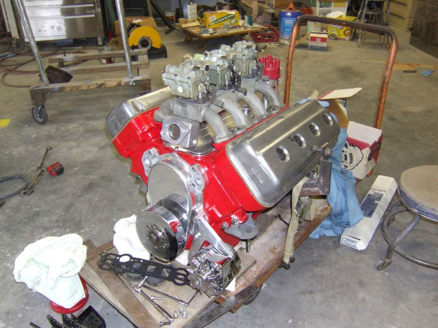

    I made my own intake for a 341 Desoto hemi using the following pictures as a pattern. I bought 4 mandrel U bends for the intake runners. In one of the pictures you can see a small hose running from the thermostat housing to the water pump. With a remote housing the engine would get real hot before enough heat found it way thru the return hoses to make the thermostat open. That small byp*** hose lets heat get to the thermostat without the engine getting too hot. It works real well.
    Take a look at the pan rail on the block. My 354 truck engine just happens to be drilled for either the 51-53 pan or the later 392 style pan. Because of that I was able to buy a new 392 pan.
