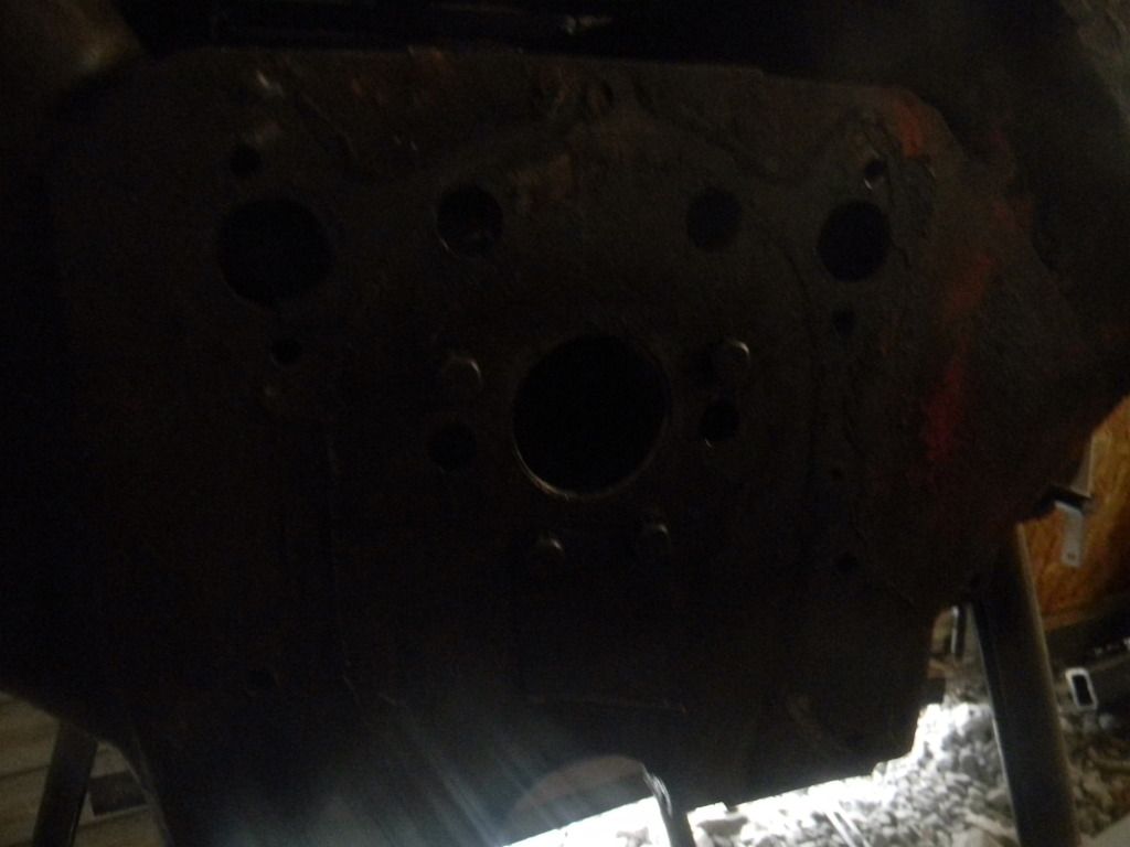

  6. shtterbug8
    Joined: Jul 31, 2011
    Posts: 512
    shtterbug8
    really really confused right now. ive doubled back and read all the cooling threads about the hemi bbc adapatation process. and im just hitting a brick wall.
    for some reason 1. the adapters i bought was dale wilch do not match up the the holes in the block. they are slightly off and can be fixed by drilling a slightly bigger hole in the adapters.
    2. neither bbc or sbc water pumps come close to matching up to the adapters. its like the darn hemi got thrown into a dryer wway to long and it became to narrow. the pump in the picture is the sbc. the bbc goes to the edges of the heads and i dont see how it would fit at all.
    3. what am i to do now? my head is telling me to drill and tap my own holes and make it work. weld up the holes i dont need....

    Ok...once again. You have a truck block. The adapters you bought only fit a car block. If converting to an aftermarket water pump on a truck block, a sb chevy pump is used. Usually those adapters are part of the aftermarket aluminum timing cover, because things are so close together. (timing cover and water pump outlets)
    In review. Car and truck blocks are different. They take different timing covers and different water pumps.
    I explained this once already in post #83 and 87.

  10. shtterbug8
    Posts: 512
    shtterbug8
    damn...my memory ****s. your completely right TR.
    instead of me lets say...buying more incorrect parts....lol. is it not completely impossible for me to move my water parts farther outwards. drill tap new holes and weld up the old. im not sure how big the water p***ages are in the block.

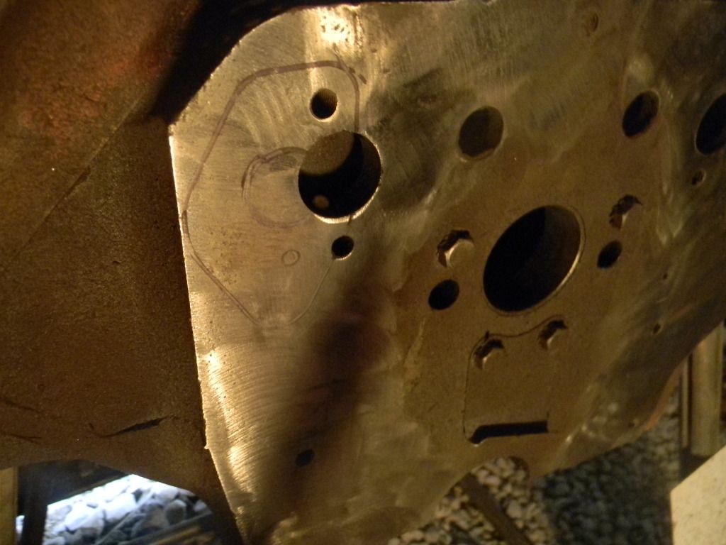

  12. shtterbug8
    Posts: 512
    shtterbug8
    my luck....the way its been going....i would do as you say and end up still with the wrong cover/adapter.
    that being said....im doing this my way now and fixing the problem as i would at my job....FABRICATE SOMETHING COMPLETELY UNIQUE.
    here is what ive got going so far....ive cleaned the part of the block off i will be working on. i bolted the adapters up to the bbc water pump and held it up the the block. then as im holding it agaisnt the block in the position that looks good to me i traced around the adapters with a permanent marker. after doing this i unbolted the adapter from the water pump and held the adapter up to the traced outline and then marked the bolting holes and water p***age.
    for tomorrow if time permits i will weld up the holes i dont need. center punch the location of the new holes and then drill and tap the new holes. the water p***ages i will use a hole saw size 1.125" to create new holes with.
    i used my finger in the existing water p***age hole to determine whether or not i had enough "meat" behind the area i will be creating a new water p***age and to make sure the cylinder wall was no 2 close for comfort.
    will all this being done i will not be modifying my timing cover....the one i have is the wrong bolt pattern and i cant seem to find the right one. so i will be plugging all the old holes for the old timing cover and drill new ones for the one ive got. ........
    the coolest thing i dont know if you can tell from the photos i took....when i removed all the old paint and oil off the front of the block you could see the factory machine marks where the block was leveled off or something. very cool.

    If you are going to drill your block full of holes, why not just use a SB Mopar timing cover and waterpump?
    By looking at your outlines, the waterpump is not centered. Might want to check that.
  15. shtterbug8
    Posts: 512
    shtterbug8
    that is true about the sb mopar timing cover and waterpump but i dont see why i should go buy another timing cover and waterpump when i got perfectly good ones already.
    the waterpump is not centered. you are right ...but if i center the water pump it will hang off the flat face of the block and create different issue all together. nothing says a water pump has to be centered on a engine. heck the stock truck pump was above the valley cover.
    if i did center it also it would make my hole on the left side ontop of the cylinder wall. no no good.
    im thinking about buying one of your valley covers made out of the 16ga steel. i do believe im going to...just trying to make up my mind.

    I'm not sure you'll be able to mount a starter with that left rear stand leg where it is.

    1. Attempting to weld up such large holes is a very poor decision.
    2. The tin cover you bought does not fit because you have a truck block.
    Once again, for all intents and purposes, You have a 1954 331. It just happens be have a larger bore.
    1951-1954 331 did not use a tin cover, it was a one-piece casting that served as the chain cover and pump housing. This one-piece cast housing will bolt directly to your truck block.

    first i would like to clear up some worries on this welding block deal...i am would some consider a Technical Welder. i specialize in welding uncommon metals. mainly aluminum of several types....my other speciaty is welding cast iron. i use nickel rod usually doing this type of process. preheating before and pingin the metal as it cools. ive personally done a half dozen or so blocks whether its a crack or hole busted in the side. one should never try and weld a hole that big! i will be using the chunk i hole saw out to make the water p***age dramatically smaller.
    the stock truck water pump in my eyes is HUGE and very ugly. thus the reason for not using it. plus $$$$ to find or rebuild. chevy pumps are dime a dozen...heck i bought my bbc aluminum one for $47 NEW! this was thru a autoparts store and not ebay. so that makes sense to me.
    not insulted at all! just trying to help others that might have a truck block as well as help myself as i do this build. lol
    the lifters were bought brand new. all bearings were bought already. the heads im holding off on. in a month there will be a swap meet in louisville and there is usually a bunch of hemi guys up there with parts. almost always there is rebuilt heads for sale. my luck there will be nothing this year.
    im using the stock distributor but im replacing the points with the Pertronix Ignitor Points Eliminator Kit by speedway motors.
    with all this being said.... this is what i did before i got on here and read all your posts!
    the engine has been drilled and tapped and holesawed for the water pump. fits nicely. i was very happy. all new holes did not come close to anything critical in my opinion.
    i installed the crank, 340 balancer, and my 318 pulley off a dodge ram truck. for some reason my crank bolt will not go in all the way. when its tighten all the way the bolt is still sticking out about a half of an inch. not sure way. im going to measure the original harmonic balancer and see if there is a difference. this is a slight difference in the alignment of the pulleys but ive got an idea to fix that. its not bad.
    the next thing i will be doing in the next couple days is drill and tap holes for the timing cover and get that installed.
