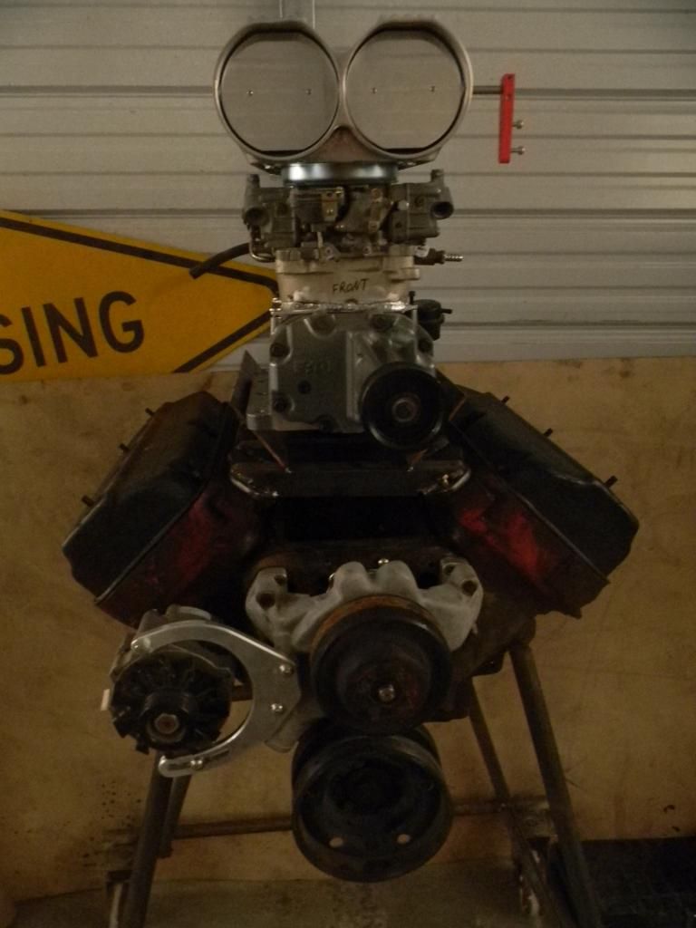

    got a really great deal at the kyana swap meet this year! found me a distributor NEW for the hemi $65. just cant beat that. plus its a va***n advance and electronic. no more points!
    wasnt able to buy any heads at the meet....just no one with any. was able to meet a guy that lives locally and he is suppose to have rebuilt heads that were never used on his hemi. im going to meet up with him later this week to try and purchase them from him.
    here are some pictures of the new distributor and scoop.
    i like the chrome cover on the distributor because it reminds me of a magneto.

    been a little bit sense i posted anything but its mainly due to the fact i stopped working on the engine because im working on other stuff. but i was able to get some work done to the supercharger today. looks freakin awesome.
    here some pics of what ive done....

    figure i post a pic of the engine sitting in the car for mockup purposes.

    Im thinking that later on in a few years after i get it going about switching over to a more traditional 671roots style. For now i think this just looks freakin awesome.

    I'm wondering how the fuel/air from the rear carb will find it's way into the blower inlet? seems to be a very small space for the air to turn. Looks like 1 carb right over the inlet would be a better deal

    air inlet to the supercharger is in the middle of both carbs. shouldnt be an issue. will find out on the day it fires up...or explodes
