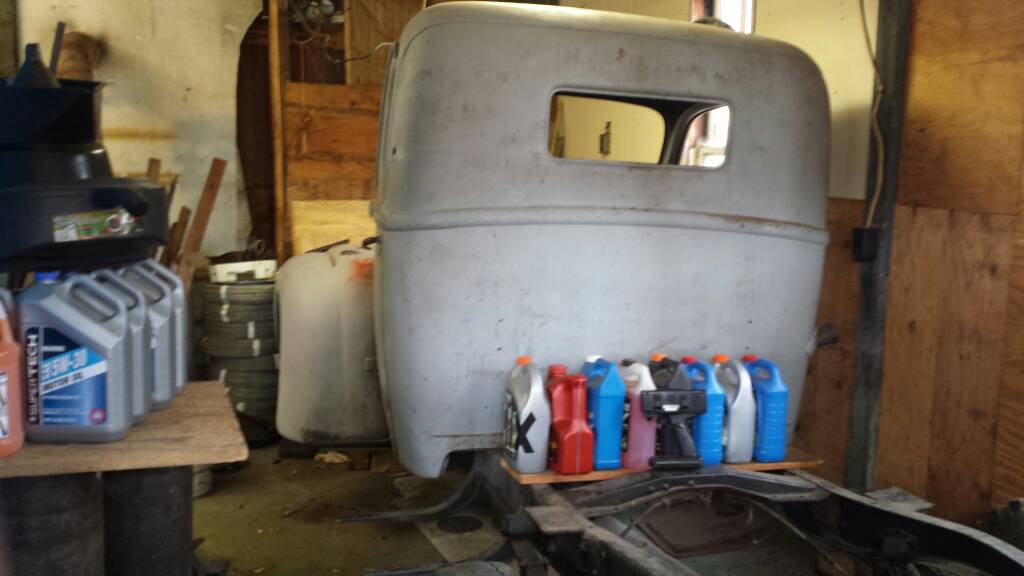

    here's my 47 ford jailbar I plan to turn into a g***er. It's got hidden rust here and there but overall it's in good shape.
    A picture:
    So I got the truck for free just because it's been stuffed in my little garage for the past 20 or 30 years. I haven't bought any parts for it yet just because I have basically all of them already.

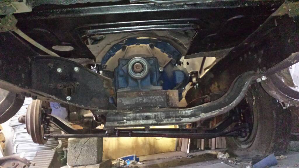

    Here's the sad excuse for a ****** crossmember.
    Basically what is bad about it is its been hacked in half and bolted together with a different crossmember out of a different car.
    The motor crossmember is just bolted to the frame by the bottom of this box like thingy so basically the motor sits about 4 inches too high.
    That's the weird box. It can be seen from another angle in this next photo.
    It's at the bottom in the middle in top of the frame.

    What is the real problem is the steering, what I asked about in my introduction thread. Someone on another forum mentioned something about using some sort of Chain drive deal, but the only thing I've ever seen chain steering on is a waterloo tractor, there's probably a reason for that.
    The oil pan is rather close to the front axle as well that I'm not worried about though.
    The pan is the big blue thing at the top and the axle and steering linkage is the big tubes and the I beam at the bottom. Also in that picture you can see the motor crossmember, that's the haggard pice of metal in the middle.

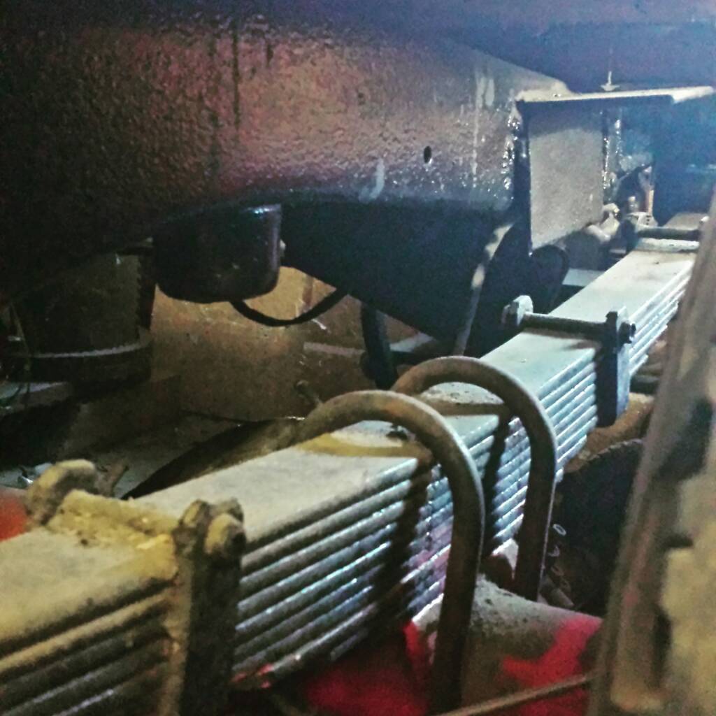

    Yay for me, I have a 9 inch rear

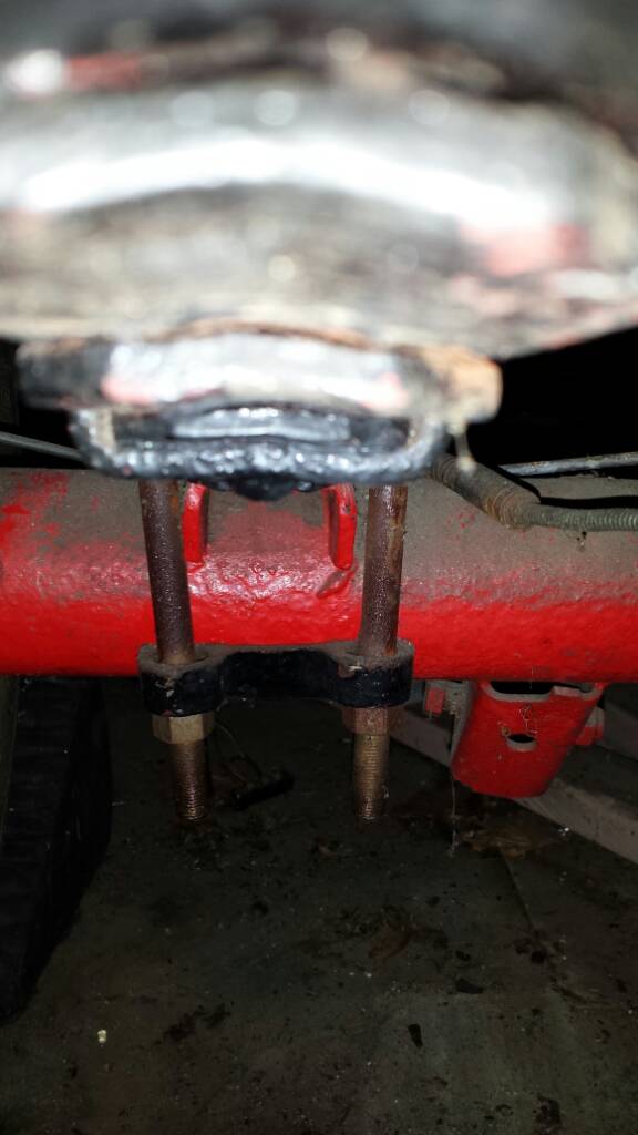

    The u bolts that hold it on are round when they should be flat, and are two large so they look like a one humped heart.

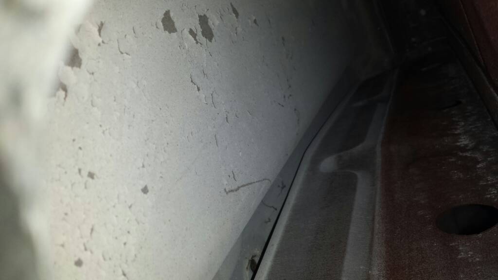

    I started by removing the primer off the fender and wishing I didn't.
    So kinda horrified by that u covered it up and got to work on other parts

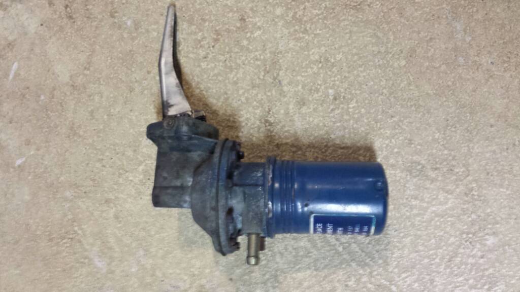

    I took the fuel pump out and cleaned that all up

    nothing like a "keep it simple" challenge - have a good clear ***le? have room to take cab off to redo frame "booger welding", etc? so, why keep the motor & trans?you might think that will keep costs down but, it won't. instead of a g***er, why not go for a reliable driver? have a good size budget?

    Did they keep half of the old crossmember so they wouldn't have to move the master cylinder or something?

  6. on the rear axle, you need to turn the U bolts over and put the round part under the axle and use a flat plate with holes on top of the springs

    Regarding FE and toploader, these are mighty material for any build. No reason to get rid of them. But motor mounts need redoing! The 9 inch is not a bad rear end, that trinity will make your truck drive very nice. It should be possible to do reasonable speeds, and be able to stop. I think there is good drum brakes available from a newer truck that should be easier to adapt to you parts then disc brakes, but Google is your friend!

    Regarding the manifold vs collum, it looks like is possible to fix that. There looks to be way more room then a Flathead in a Model A or Hemi in a 34.

    One Google search, direct to photo and here is what I found; ImageUploadedByH.A.M.B.1460483050.885755.jpg ImageUploadedByH.A.M.B.1460483081.798254.jpg
    If it doesn't fit try moving engine to the one side, that will make room, and the engine don't mind, as long as you pay attention to angles of carb flange/prop shaft, and you are better fabricator then the last guy "working" on the truck.
    And regarding paint under primer, I can say for sure I've seen trucks with five layers of paint under primer, each time the truck went to a different firm, the scuffed it up and painted in the alley behind the truck shop. No biggie as long as it's not a show truck or a custom.
    Just even it out with a sander, re prime and get cracking. The pleasure is in driving!!

    And to answer barn find, that's the exact reason it's like that.
    Another thing, I plan to make my own headers. The manifolds above do give me an idea though. Thanks.

    You should rarther flip the rear axle, get the front axle dropped and go for some lowered springs in the front to make it level, paint it with a simple color (one tone with a accent color), put a shop logo on the door and enjoy the car till the end of days.
