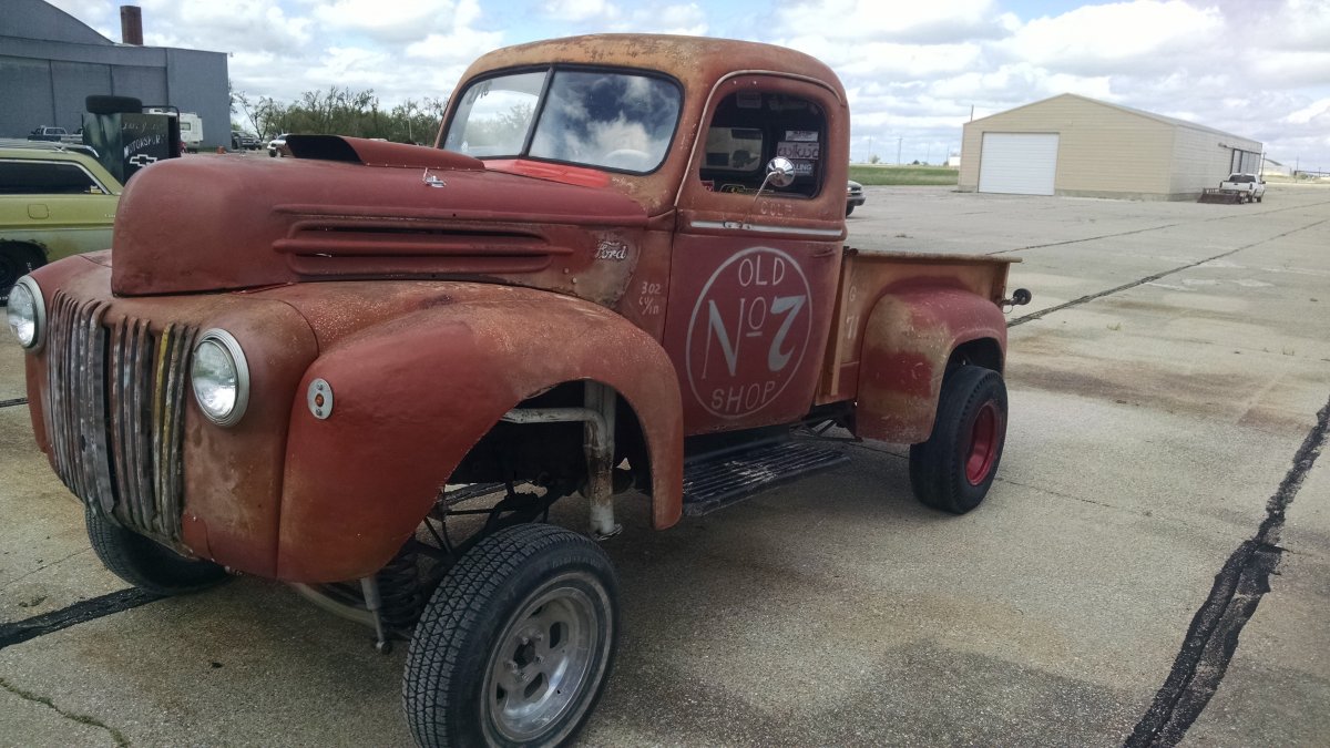

    So after 40 years it's finally come out of my garage today.
    It went back in the opposite way so now I have room to actually work on it, and I can push it out if need be (there's not plywood stacked against the door anymore).
    Here's the only photo I know of back when it ran in 1970.
    I know it's not a great picture but it's the only one I have.
    Thanks for looking.

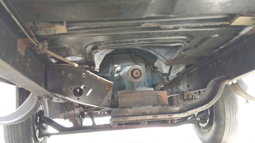

    Finally making progress now, today I got the engine pushed back to where it should be. It sat too far foward before. I'm going to make do with the engine mounts I have as I still have yet to buy a welder, the mount itself is a little ugly but it'll work. I'll just have to change the transmission crossmember.
    So with the engine pushed back I gained 2 inches of clearance between the waterpump and the radiator
    The steering box is a little tight but it doesn't hit so it's good for me.
    There's a rivet holding the boxed section for the steering box onto the frame In my way and it needs to be cut off in order for the engine to sit 100% level side to side. But other than that it looks ok. Hopefully when I grind the rivet off it still clears the steering box, if it doesn't I can probably notch the tube and sleeve it or something it should be ok. The engine sits kinda close to the steering column like I thought it would but it appears it will clear if I bend the header tube towards the front of the engine, I can worry about that when it becomes time.
    That's not the major problem, the "major" problem is the trans crossmember. I would like to keep the pedals under the floor just for the ease of making a clutch cable and keeping the master out of the way, they also look more original that way. Problem is if I go with a tubular crossmember like I plan to it'll basically mount right behind or on top of the crossmember that's there.
    I figure I could probably cave and run the brake pedal off the firewall if it comes down to it, but I'd like to keep it stock looking and keep the clutch right there so I can run a straight cable to it easily.
    That's how it sits on the crossmember that's currently there.
    This is said crossmember
    YEah fantastic fabrication was done in my truck, (all this work might have something to do with all the empty beer cans I found around the truck when I first started tinkering with it)
    Anyway back to the point, I know that I probably need about a 3 inch drop, from the measurements that I've took that seems about correct, I'd just have to adjust it to where the engine sits at the proper front to back angle (my rearend is out of a 4x4 truck so it's got a bit more pinion angle than most, I'm probably gonna have to shim that.)
    My plan is to get a kinda cut to size and weld on bolt on pads style like this
    https://m.summitracing.com/parts/trd-4559
    So after all that banter I'm gonna ask a question, when it says fits ford and chevy transmissions, do all fords use the same transmission mount? Or does it mean for particular ford transmission like a c4 or a t5?
    Thanks for looking.
