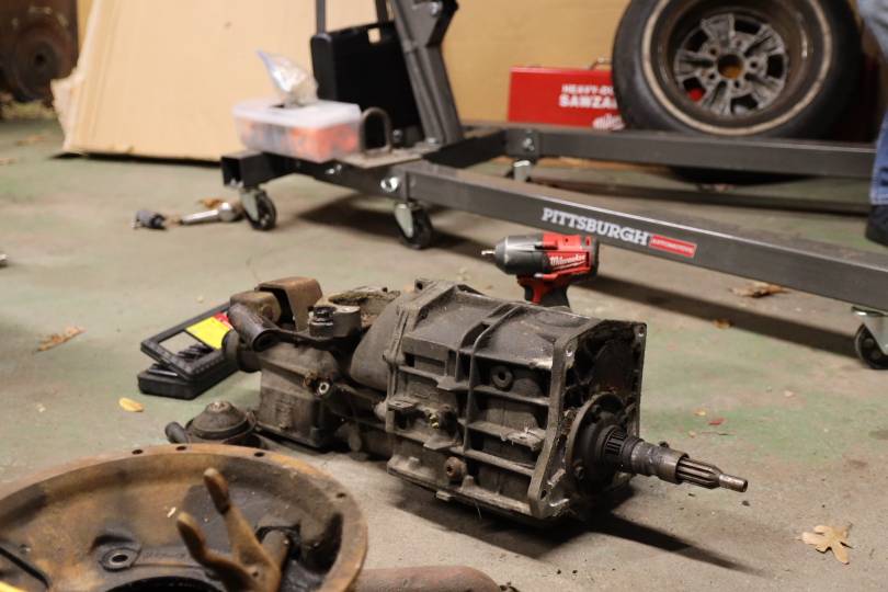

    Aquired a t5 from a friend, seems to be locked up.. not sure why but hey can't complain when i got it for the low low price of free.99 20201129182451_BG9A7986.jpeg

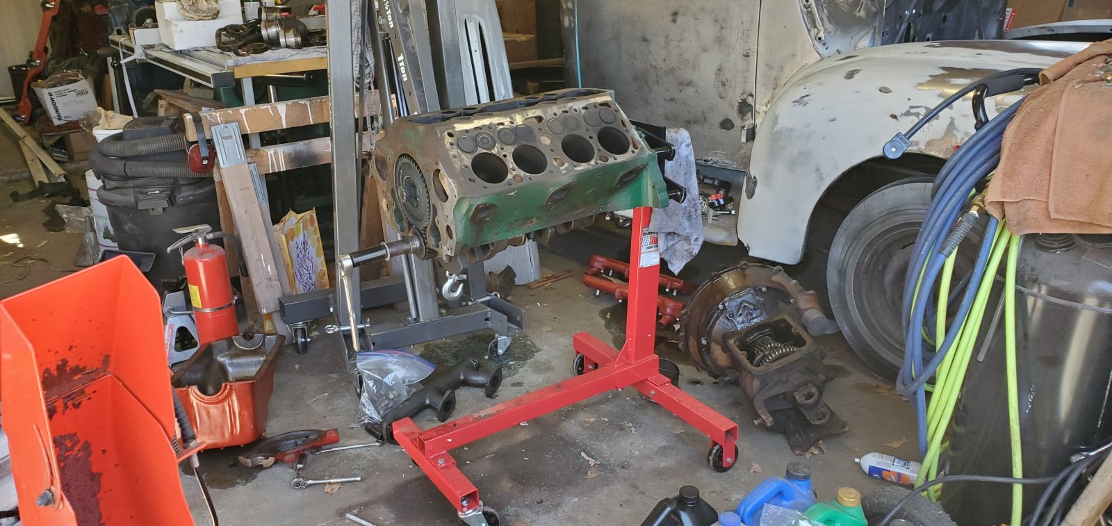

    Another update, I've got the motor back out, pulled the crank out and have it down to basically a bare block, I'm hoping to have it runnable by the end of this year, not saying planning because I know things never go to plan.

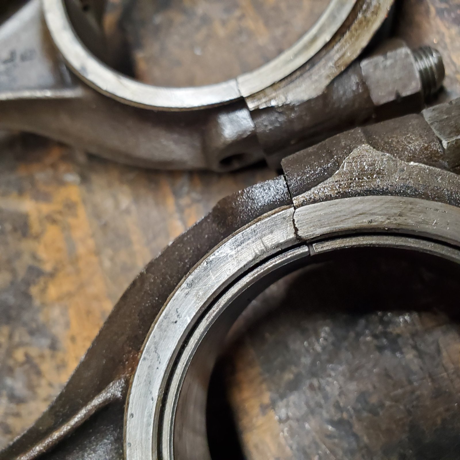

    The crank looks fairly decent in my opinion I'm not too concerned about that, here's what I am concerned about though. 20210826_144230.jpg 20210826_144123.jpg 20210823_145259.jpg 20210826_144114.jpg
    I know my rod bearings are in need of replacement, they all show copper and I'm ***uming they probably shouldn't. I also noticed these 2 rods though, one straight had the bearing fall out of it when i pulled it out of the engine, guessing that's not usually a great sign for the bearing. I also noticed the rod and cap don't sit flush together on the bearing surface, is that normal?, also the cap is offset from the rod and both the rod and caps have the gouges in them that don't look too hot to me, any idea what would cause this?
    I wish I could get better photos but my phone has a hard time handling up close and I don't own a macro lens.
  12. Budget36
    Joined: Nov 29, 2014
    Posts: 15,303
    Budget36
    Looks like a well worn engine.
    Was/is your plan to just freshen it up?
    You’ll need to start off with a minimum of brush honing the cylinders, polishing up the crank and take some measurements to see what you are starting off with.
    It can be intimidating at first, but realize as you buy some tools and get into it, it becomes a bit easier.
    Duellym likes this.
  13. Duellym
    Joined: Feb 28, 2016
    Posts: 358
    Duellym
    I was planning on at least giving the cylinders a dingle ball to get the rust out of them, same with the crank, I haven't pulled the valves or cam yet just because i don't have a way to keep those parts in order yet, once i do that'll come out and then I'll decide fully if i wanna take the block to a machine shop and at least get it hot tanked.
    The rods just kinda concern me with the fitment and the odd wear to them
    Budget36 likes this.
