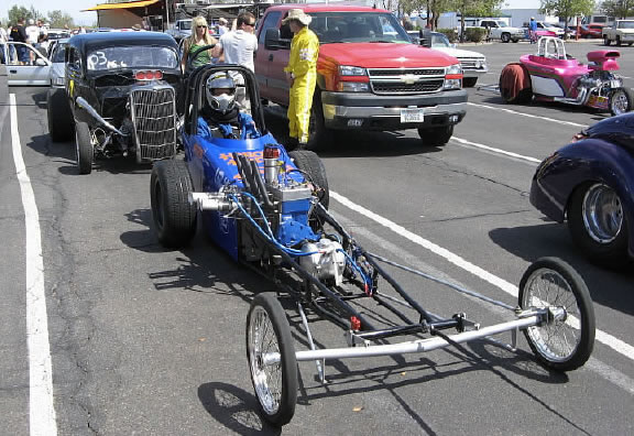

  6. RichFox
    Joined: Dec 3, 2006
    Posts: 10,020
    RichFox
    i am not the first guy to do it. I got the idea from Dave Dozier. But he said his didn't "Work". Wouldn't or couldn't tell me why. So I had to try it myself. Worked OK for me.
