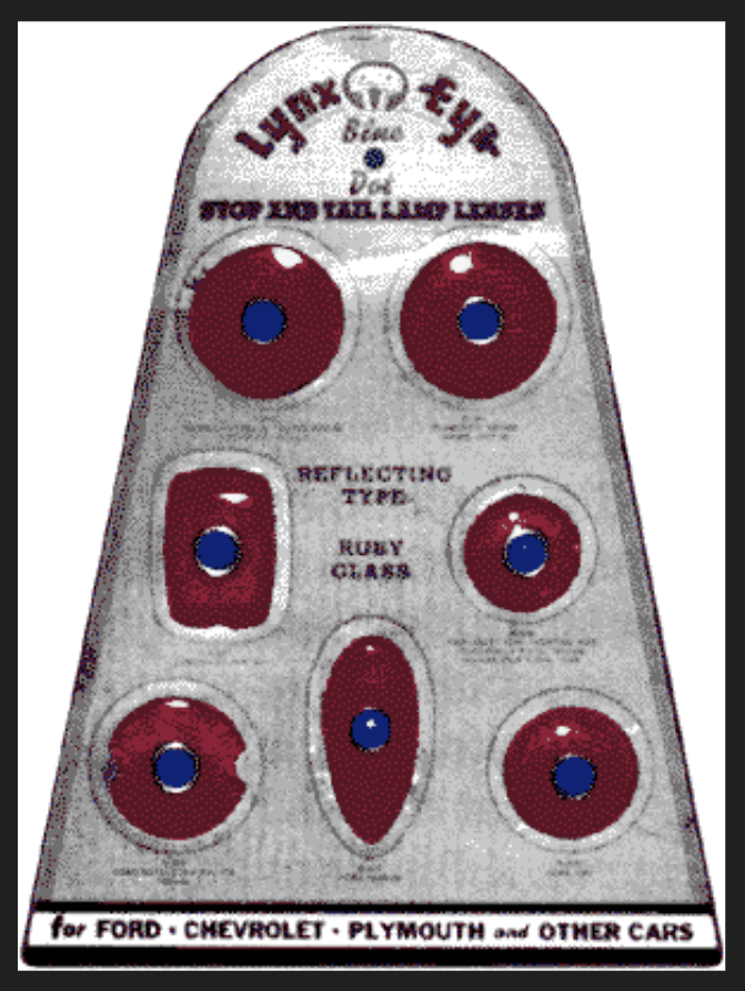

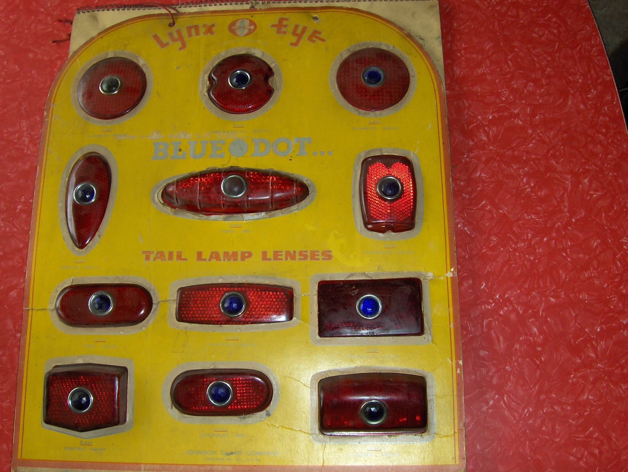

    Yes only Blue when the brakes are applied.....or turn signals if you ride has them.
    Sorry this image is not clearer, but "Blue Dots" only illuminate "Blue" with the Brakes are applied. That's because the "dot" is centered over the center of the bulb in most cases. The light is dispersed around the Dot and out the red part of most lenses.
    Kind-a a Blueish-Purple if they are the Gl*** "dots". Sometime the plastic dots are not as bright or blue.

    HMMMM don't a lot/ most of those lights shown have a dual element bulb ( 1157 if 12V ) were the stop is just brighter and light would be going through the dot all the time ????
    I guess unless I want to drill my own lenses its what I'll live with if I keep them in .
    Wonder how hard it is to get a hole in the gl*** I have never tried it .
    I was just disappointed after putting them in I cant even see what both look like at once unless I put put rock on the brake pedal LOL.

    Dual element is the key. The brighter element is directly behind the "Blue-Dot" give off the signature Blueee Glow :)

    The blue is darker. Low illumination around the sides with the reflector shows Red, but the center is only dimly Blue. Brighter illumination makes it glow.

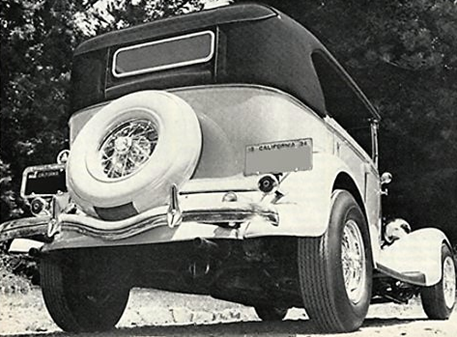

    Hello,
    Those blue dot tail lights are attractive for all hot rods. They were a valued accessory to add to a lot of old hot rods, just to have a little something extra on the custom hot rods.
    1934 Ford Phaeton with a custom California Top Goleta, CA
    The stylish looks were popular on other year hot rods, too.
    Hot rods that had them on during those popular, but hated CHP vehicle check points came away with a “fix-it” ticket. They were/are illegal as the blue light interferes with the vision of the following cars and that the only blue light is for police motorcycles. An easy fix as it unbolts and the stock all red lens gets added for a neighborhood police check off ticket.
