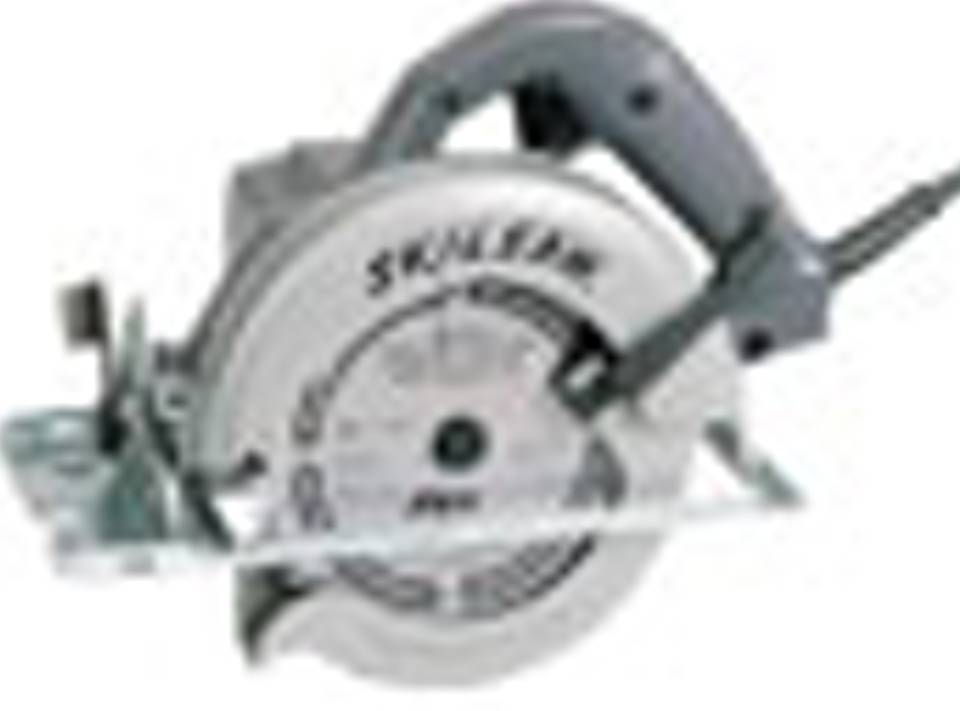

    I've used the 4 1/2 " grinder, but for the long straight cuts; Quicker, in my opinion safer, is a regular skill saw with abrasive disc.
