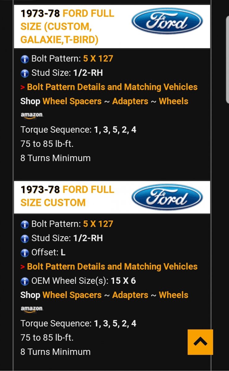

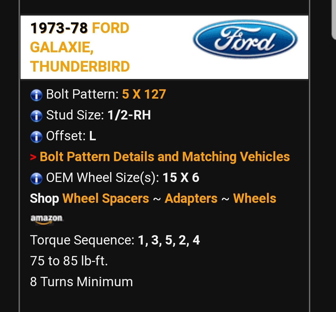

    If you're going with 5x5 bolt pattern in that truck then I bet you could find a full size 9 inch out of one of these that's already 5x5 pattern, the width has to be really close too.
  14. slack
    Joined: Aug 18, 2014
    Posts: 544
    slack
    This is good stuff. I know there's an old LTD in there that is about that year and a T-bird. If it needs to be cut down, I can manage it. Thanks, Swade. I would've replied sooner but my fingers get stiff when I gaze upon your avatar. o_O
