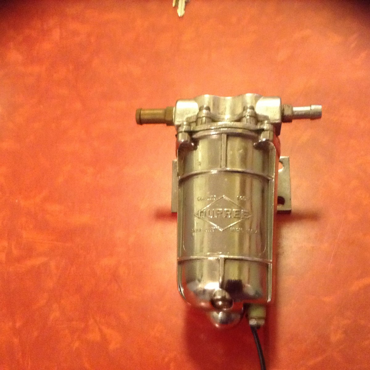

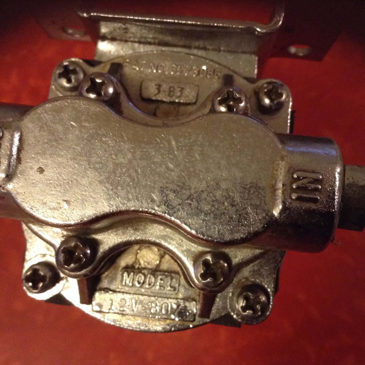

    image.jpg image.jpg I've got a Dupree electric fuel pump it's a 12 v model 807 needs a new diaphragm. I checked with Walbro but they said no parts. Anyone know of a source? Also I'm not familiar with the 807 as most are 801 models. Looks cool and the old ones I used in the past worked well.

    Yeah, I just took it apart and the diaphragm was like a soft goo, I contacted Walbro and they said it was obsolete no parts available so it's back to the box. Thanks for info but I guess the parts have dried up.

    That's it, the bellows, mine melted into pudding. Thanks Chris.
