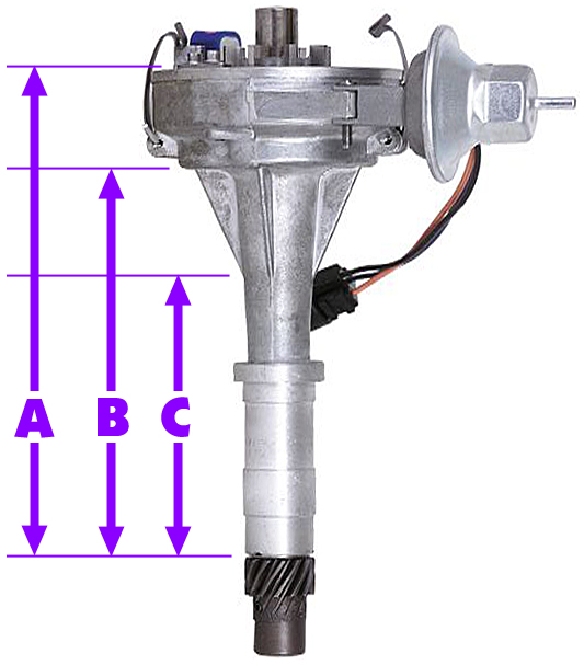

Has anyone a long-stemmed clockwise DuraSpark distributor as was used in V8 Jeeps of the '80s? I really need some measurements from one. Here (I hope) are the numbers I seek:
Hi Flathat- I have one here that I have modified to use in a flathead motor. It's a spare one I made and matches the one I've been running in my motor for several years now. Dimension A is 8 inches with the thrust washer included. Dimension B is 6 1/2 inches with the thrust washer included. I can only give you an estimate on dimension C because I turned off a portion of the fins to put on a clamping plate for holding the distributor in position in the motor. That number is 5 inches. If it would be helpful, send me an email address and I can send you a picture of my dizzy. Bill
Thanks, Bill. That's exactly what I plan to do. Your numbers are a huge help. Look for my e-mail. Cheers! Richard
