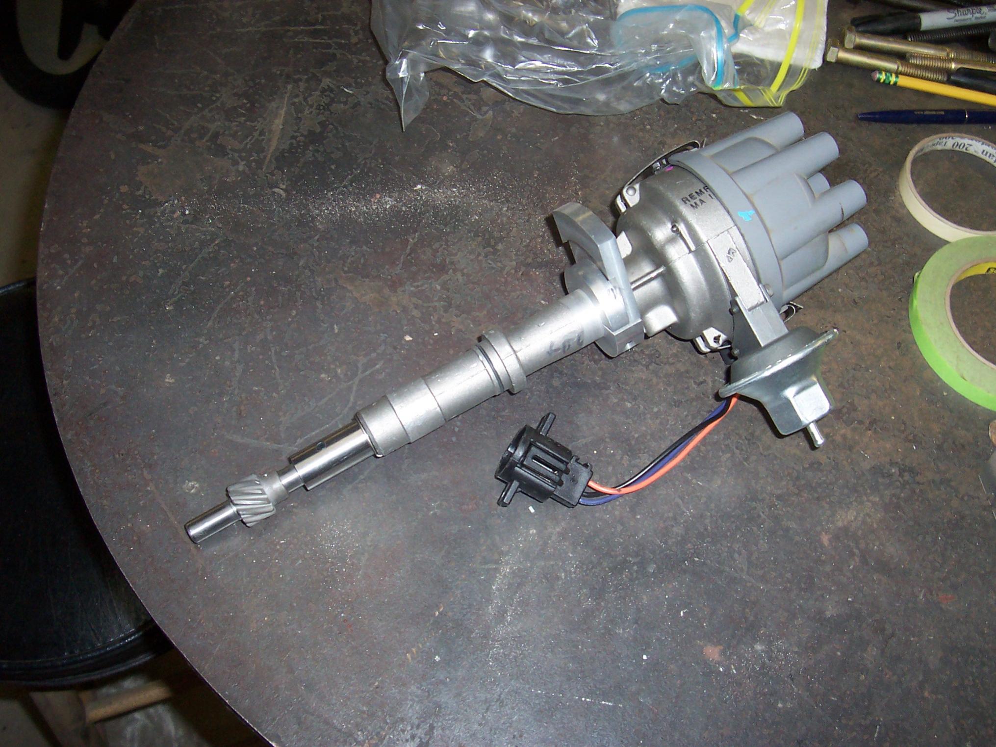

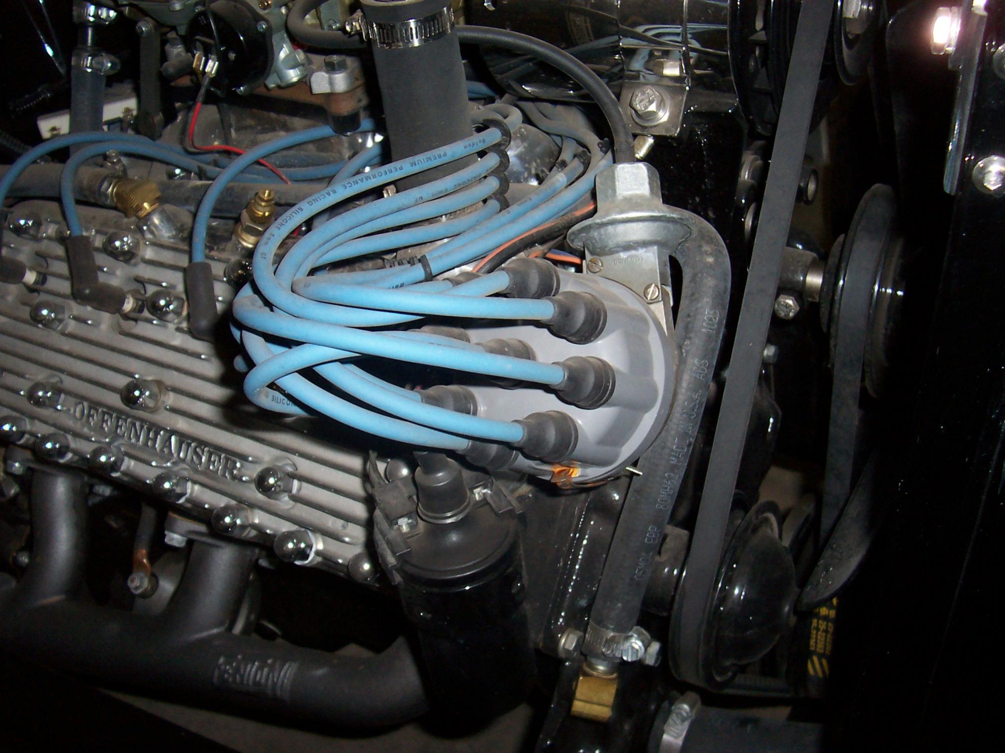

    I have attached a couple pictures of mine. The first is in a flathead motor in my '32 cabriolet, the the second is a side shot of a spare modified distributor. To use it in a flathead requires an extension shaft be made and the fins under the body be turned down for attaching a clamping plate. I used the late aluminum timing cover on my flathead which has the same diameter as the distributor, although that diameter has to be cut all the way through. It was an easy job with the proper size reamer (1 1/16" as I recall). This unit has run great for several years now. I like the idea of having an electronic distributor that looks like the original unit and has parts availability anywhere.
    Hope this info is helpful.

    The cap you see (and rotor) are the correct ones used with that distributor. Both distributors I've shown in the pictures were rebuilt units. I traded in cores on them that I got straight out of Wagoneers and they both had the smaller caps on them. The caps even say "Motorcraft" right on them.
    Hope this helps.
