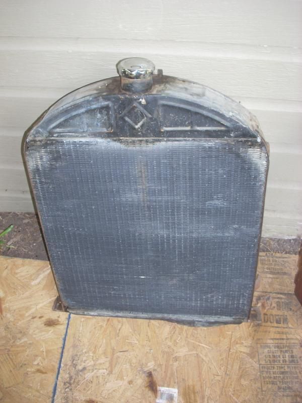

    MAn...I've been bombarded by BS lately!! I had it mounted up once and didn't like the way I had the mounts fabbed up and I'm still working on the right radiator hose reducer method as the Whippet inlet and outlet pipes are way smaller than the A. Then, Iwanted to drive it around on the 4th. of July so i stuck the '29 A radiator back on!! This week....hopefully!!!

    OK....here's the sneak peek of the Whippet grill shell and radiator. I re did my shell mount today and then just mocked up the radiator. Still have a long way to go but this is what's coming along....
    GWhite....here's your "new radiator that'll be coming your way!!

  26. Sweet! I've got your hand pump, oil pressure gauge, and side plate ready! Let me know when - I've got my radiator guy on standby to modify that bad boy to fit my nickel T shell :)
