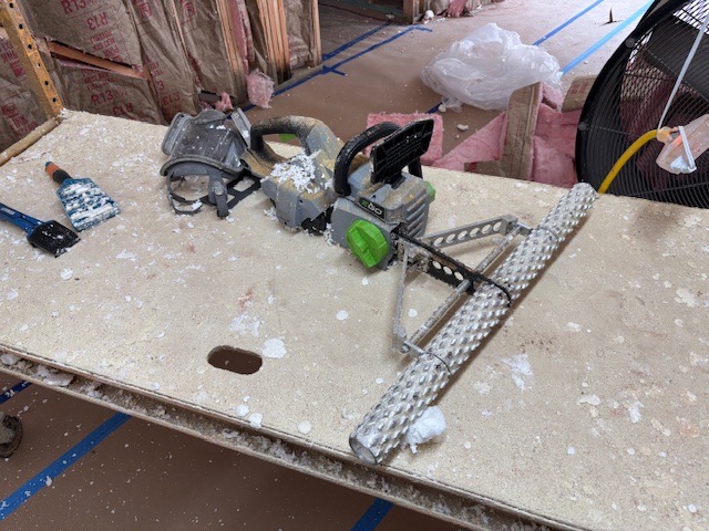

    This is what they use to flatten it. It’s basically a chain saw with a special attachment.
    This is the wall after it’s leveled.

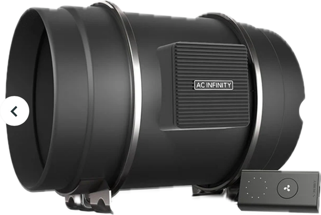

    I added an inline vent blower to evacuate fumes out of the welding shop. It’s roughly 800 cfm.
    It should work out ok. We had a problem anyway trying to vent the dryer vent, since I didn’t want it to go out through the roof. I used a Y to tie in the dryer.
    It’s an 8” duct. Should be plenty of volume
    For fumes. I added a check valve right at the exhaust vent and another to prevent the dryer from pushing the exhaust into the welding shop.
    There will be a 90 degree fitting here and will tie into a hood. Still have to build the hood.

    Here is a pic of the blower.

  30. Do you have a link for that inline vent fan? I want to have one in my welding area, and also vent it out the wall.
    Thanks!
