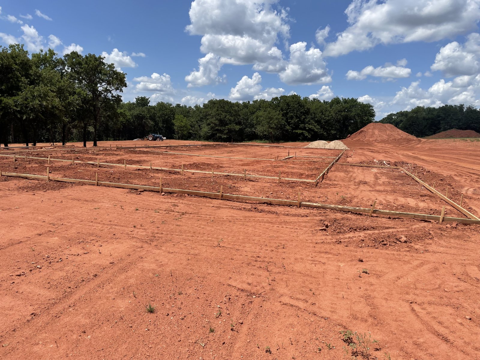

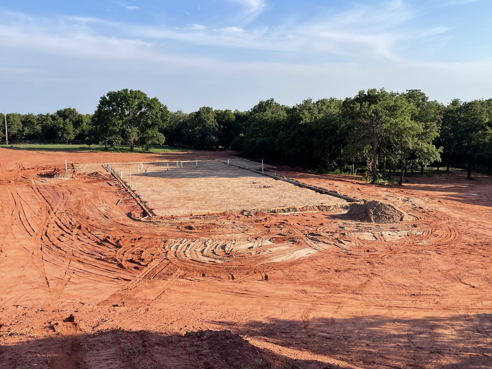

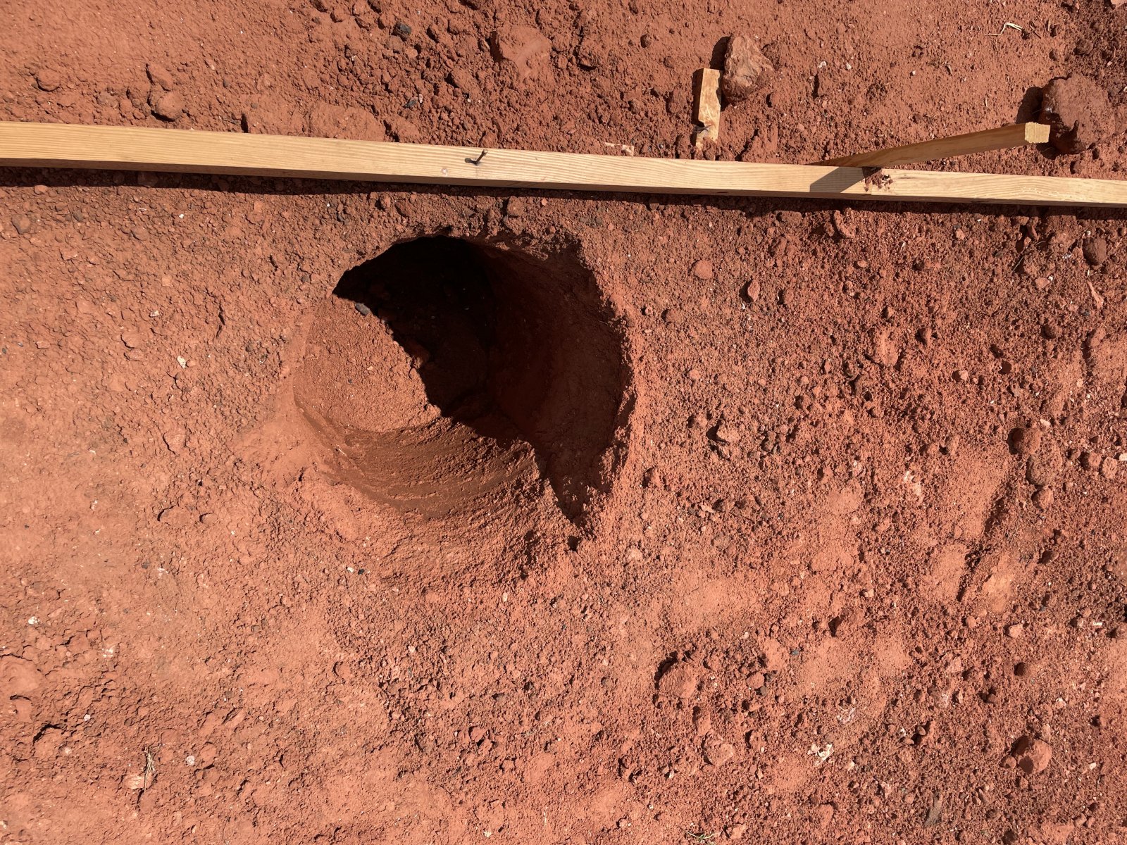

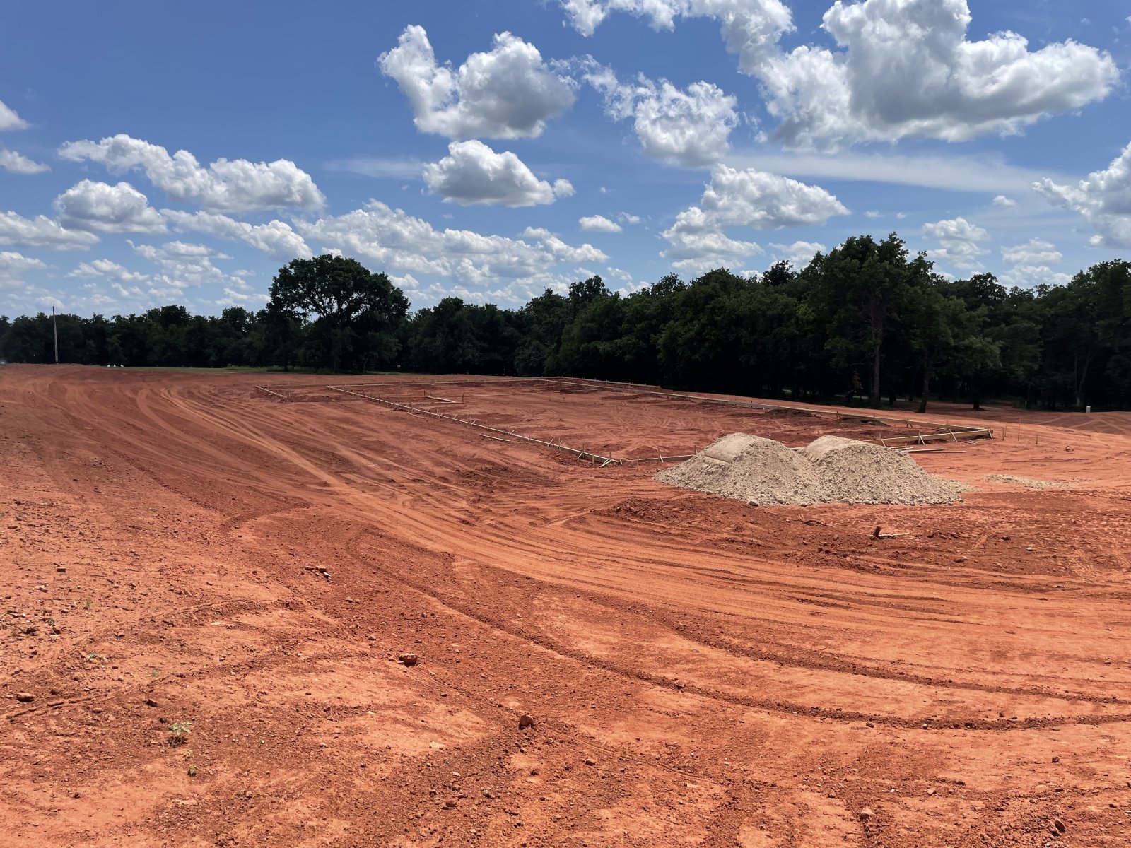

    A few update pics. Can’t see a lot here, but it’s all I have today.
    The hole pic is the piers. They are like 3’w and 3’ deep. IMG_3664.jpeg IMG_3662.jpeg IMG_3663.jpeg

    Okla City area, red clay.
    Okie Pete, Sancho and Roothawg like this.
  7. Roothawg
    Joined: Mar 14, 2001
    Posts: 26,034
    Roothawg
    Yep and lots of it…

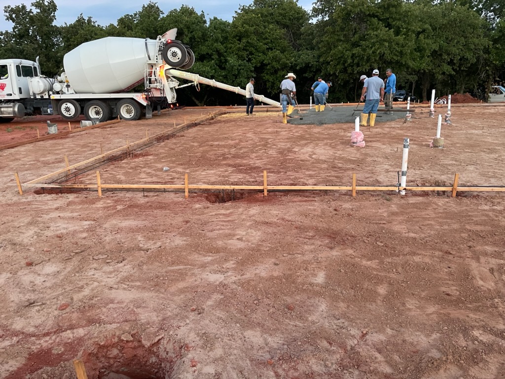

    Pouring concrete tomorrow!
  10. Dan Hay
    Joined: Mar 16, 2007
    Posts: 6,464
    Dan Hay
    That’s going to be a lot of concrete!
    Sharpone and porkshop like this.
  11. Roothawg
    Posts: 26,034
    Roothawg
    They start pouring at 6 am. My best guess is about 75 yards before porch. Another 18 for that....They will be close to 100 yards.

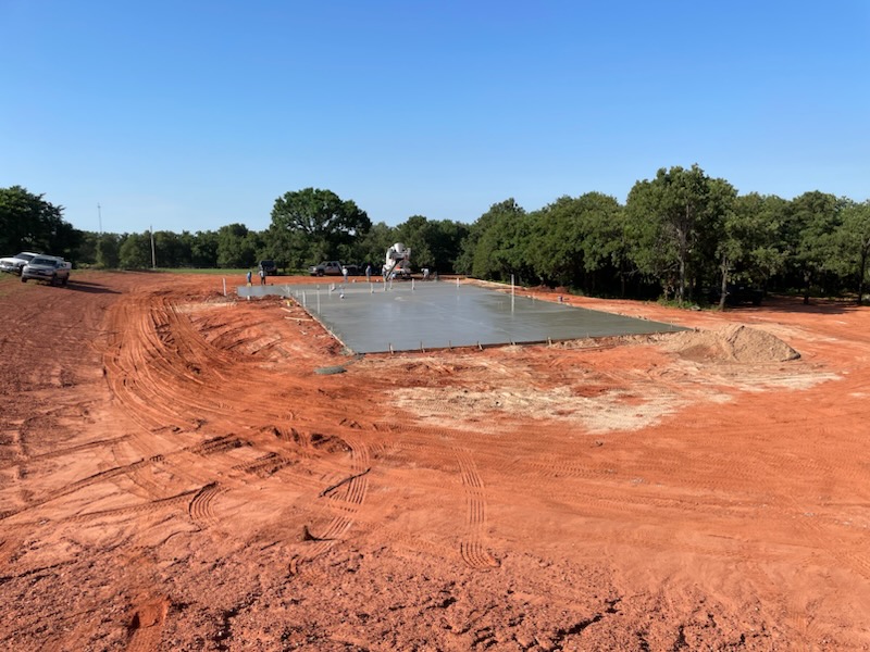

    It’s getting real!

    Holy **** these guys are good.
    Started at 6. It’s 10 now.

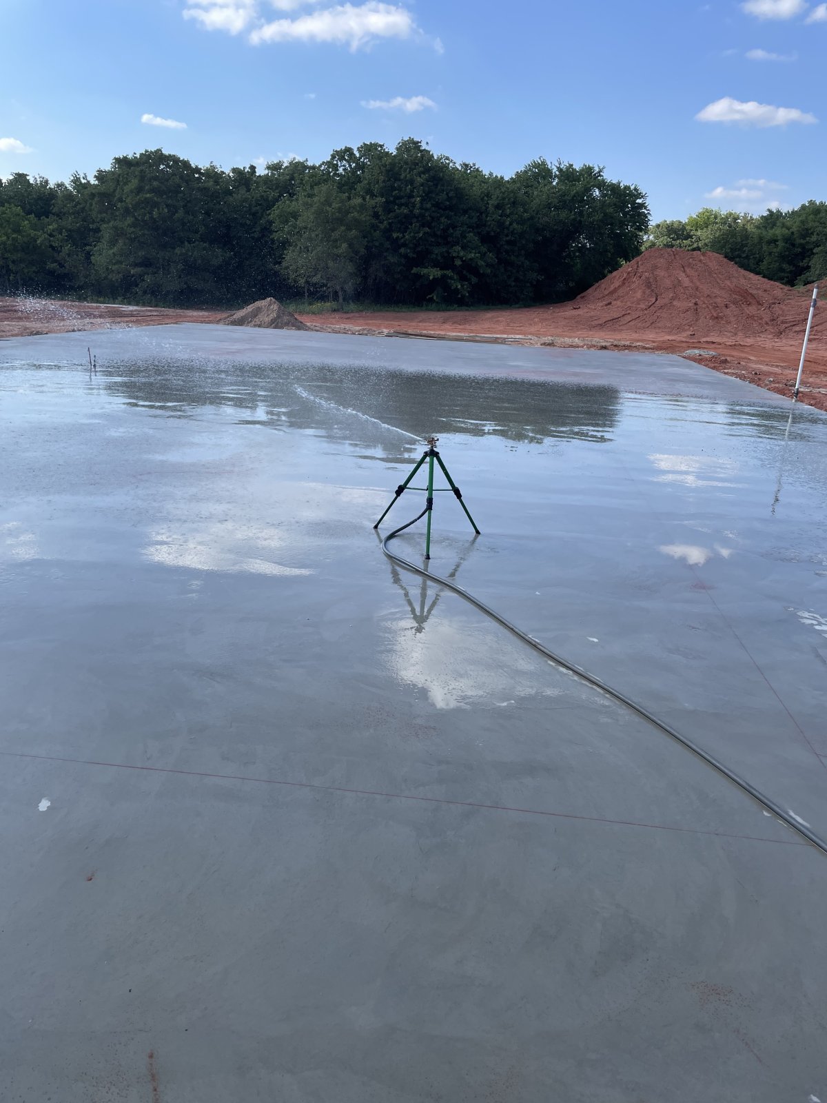

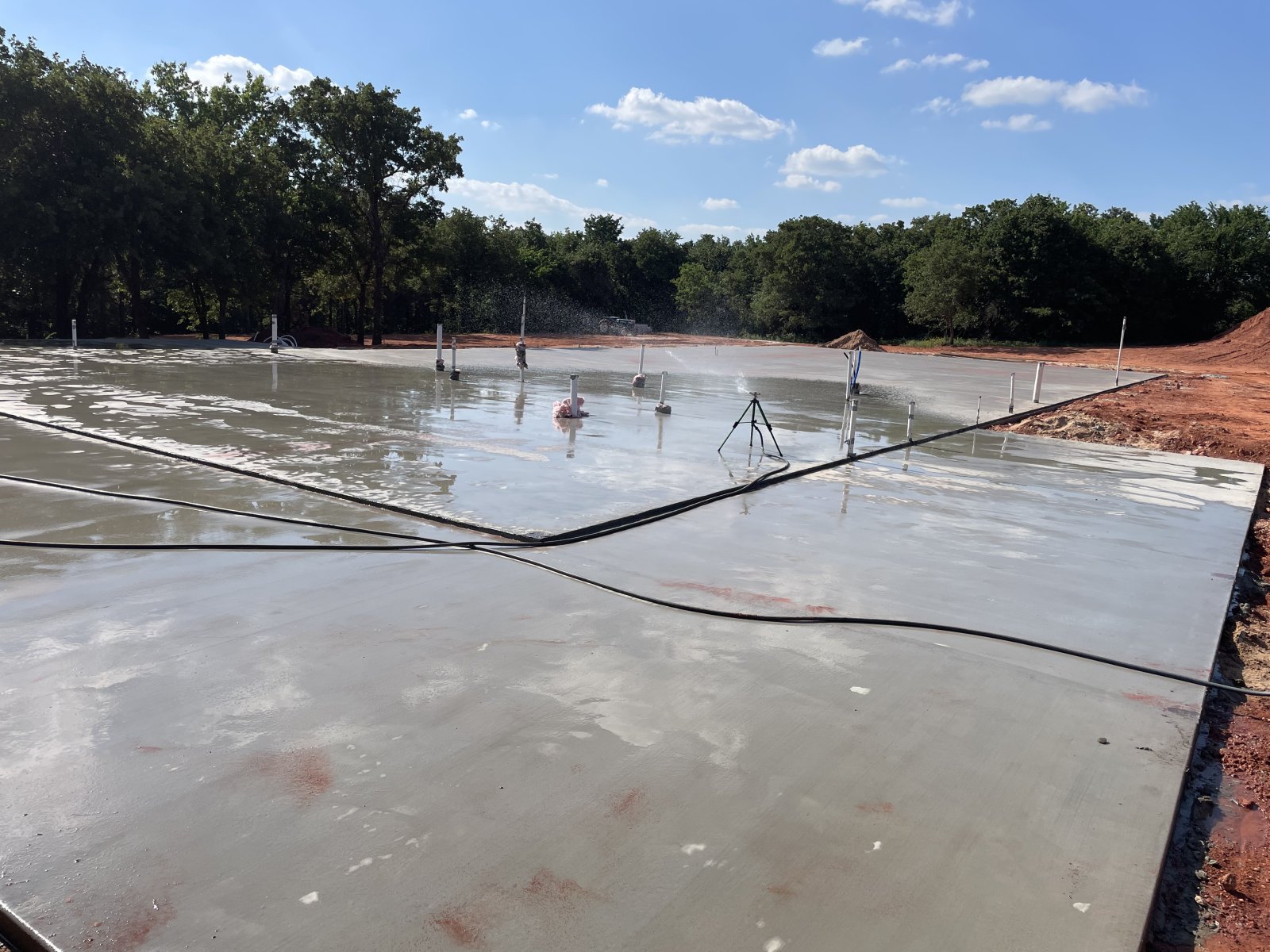

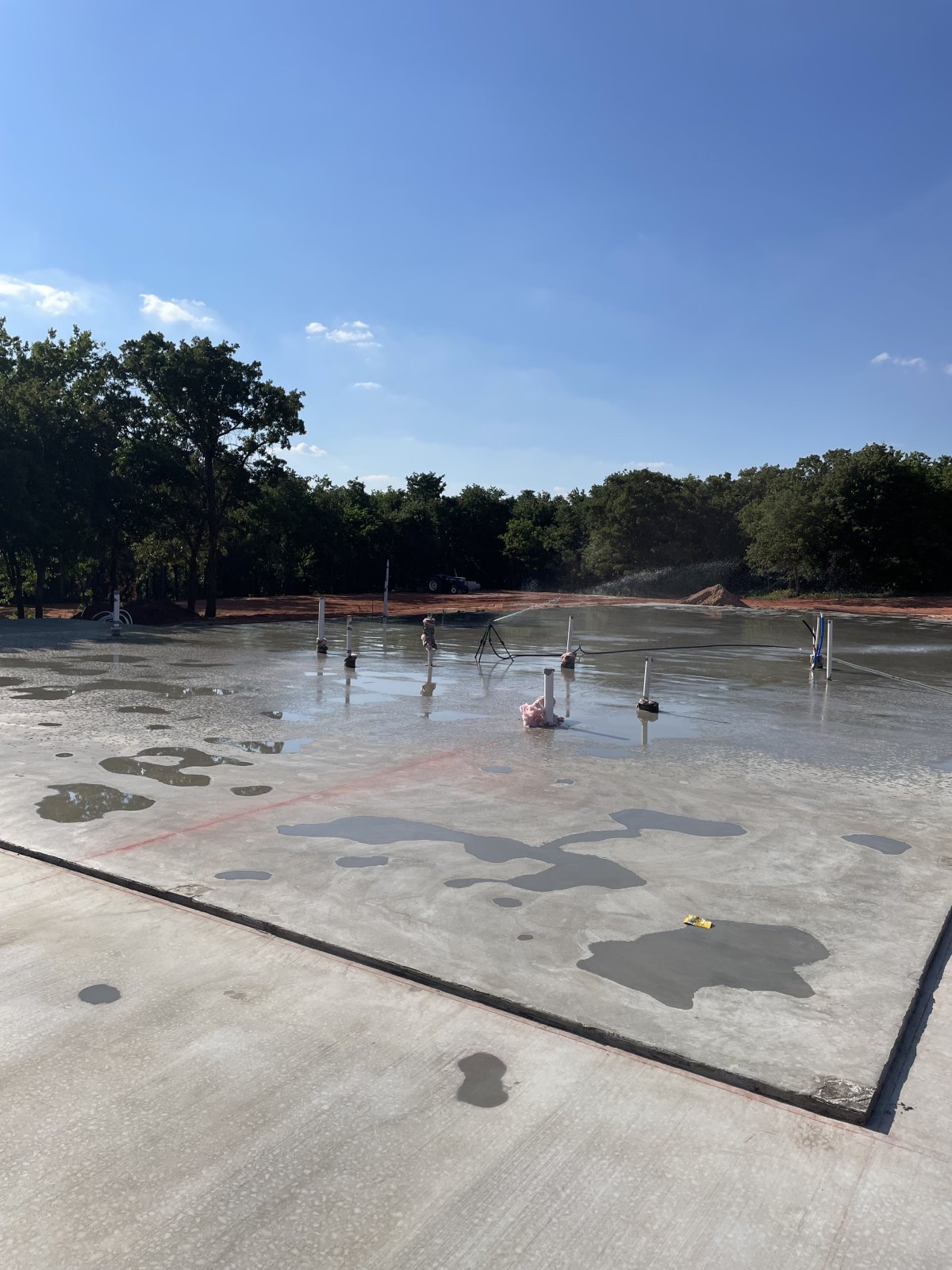

    IMG_3720.jpeg Built this Rube Goldberg contraption to water.
    IMG_3723.jpeg IMG_3722.jpeg IMG_3721.jpeg Just watering the concrete. It’s already over 90 here every day.

    Did the concrete guy polish the surface? Some of the guy(s) running the power-trowels/floats are really good, when they get done, it almost looks like a mirror. Coating/Sealer adds the shine.

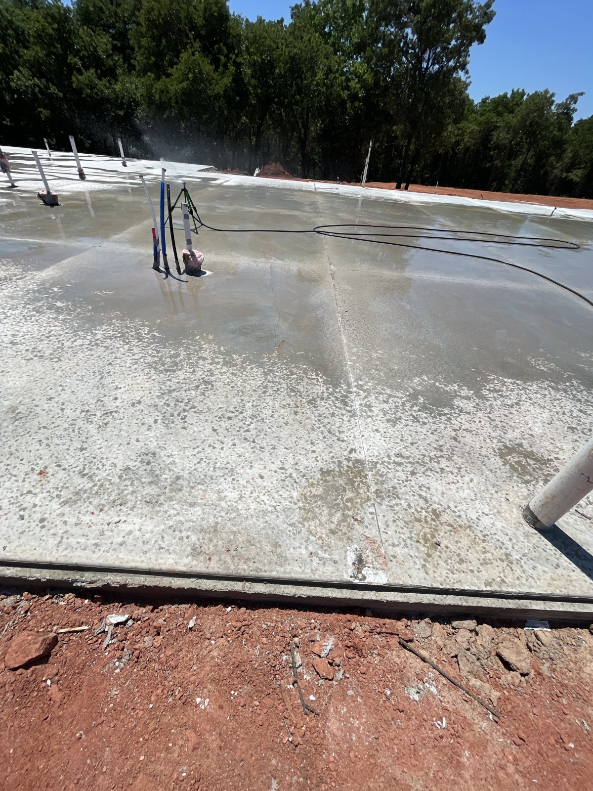

    I'm pretty bummed after days of watering, I have a giant crack the spans the whole width off the shop. It's just a hairline, but I am still bummed. They cut the concrete today, but it looks like it cracked overnight. Oh well....it was bound to happen.
    They did power trowel it. It looks pretty good.

    When we poured n finished my brothers' gar, we put in little "T" strips, to promote any cracks there. Didn't completely help ;D . But it was 'way smaller than your shop. When some pros did the garage(s) at the bus-garage(s) I worked at, their stuff also cracked(both new whole floor pours, & smaller piecemeal fixes) - & was supposed to be to state-govt-code. It does crack, re-rod, metal-mesh, shredded-fibergl***-fishing-line, all helps, doesn't stop it. Only slows it down, & if the hard-packed-sand-bed is thoroughly wetted, that too only helps slow the curing. Have seen plastic sheeting laid down to slow cure-rate, kept wet under that, sometimes gets surface irregularities from the plastic. Cold & freezing temps are a problem here as well as too hot, too soon. Hairlines aren't so bad, surface-shifting-level ****s. Maybe your concrete guys know why? I feel for you. ;( . Hope it isn't bad, only visual.

    The same thing happened on the back porch we poured a few years ago.
    I have an idea if the would have added some
    Sort of retarder, it might not have happened. It’s hot here and it dries quick.
    They sawed it this morning on 10’ grids. That should catch anything going forward. It’s sitting directly on bedrock, so I doubt it shifted.

    FYI. Here’s a bad pic of it.

    Around here they say its either cracked or it will be. After 15 years laying floors on thousands of concrete slabs of every style Ive found that to be true. I wouldnt sweat it. I dont know if yall water your foundations up there. Ive found the slabs that keep a consistent soil moisture content via soaker hoses. Landscape & drainage have the least issues. It all makes a difference in the long run. Great to see your progress !

    Are those light areas just dry, or is the surface spalling? Hope it's not the latter...

    Nah, just drying. It dries as fast as it hits.
