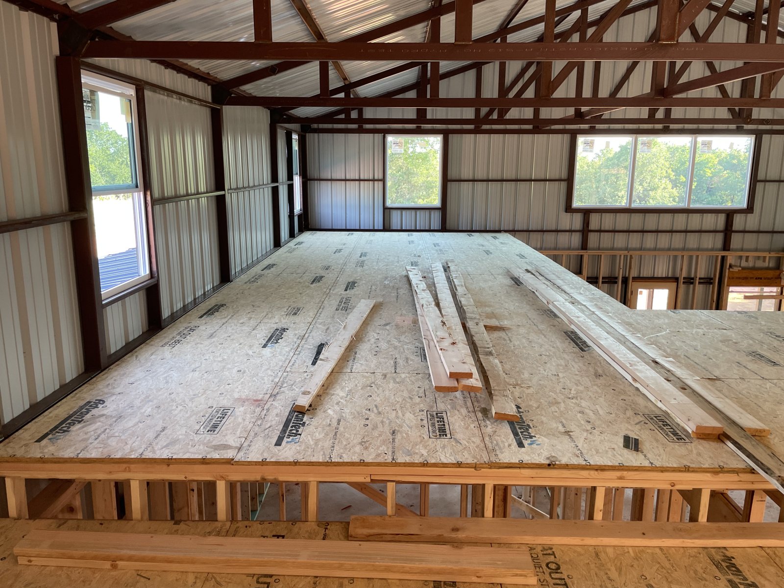

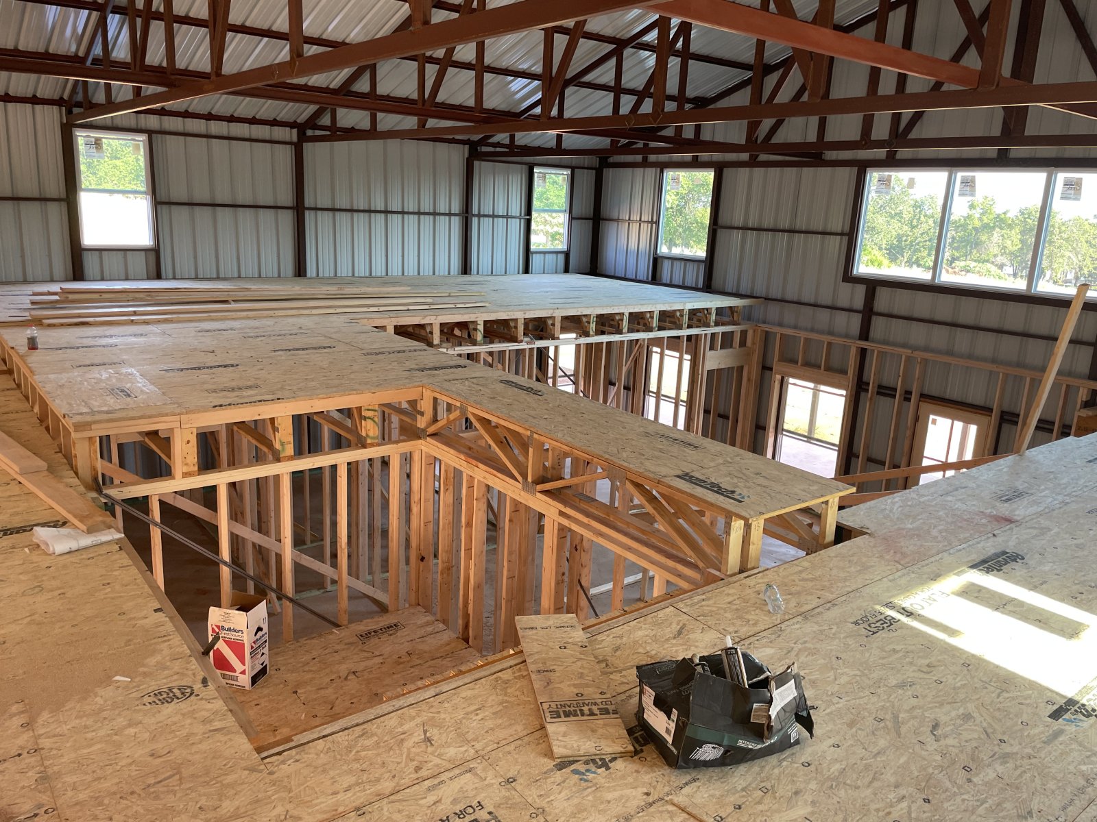

  16. Roothawg
    Joined: Mar 14, 2001
    Posts: 26,038
    Roothawg
    IMG_3991.jpeg The raised area is all storage/upholstery shop.

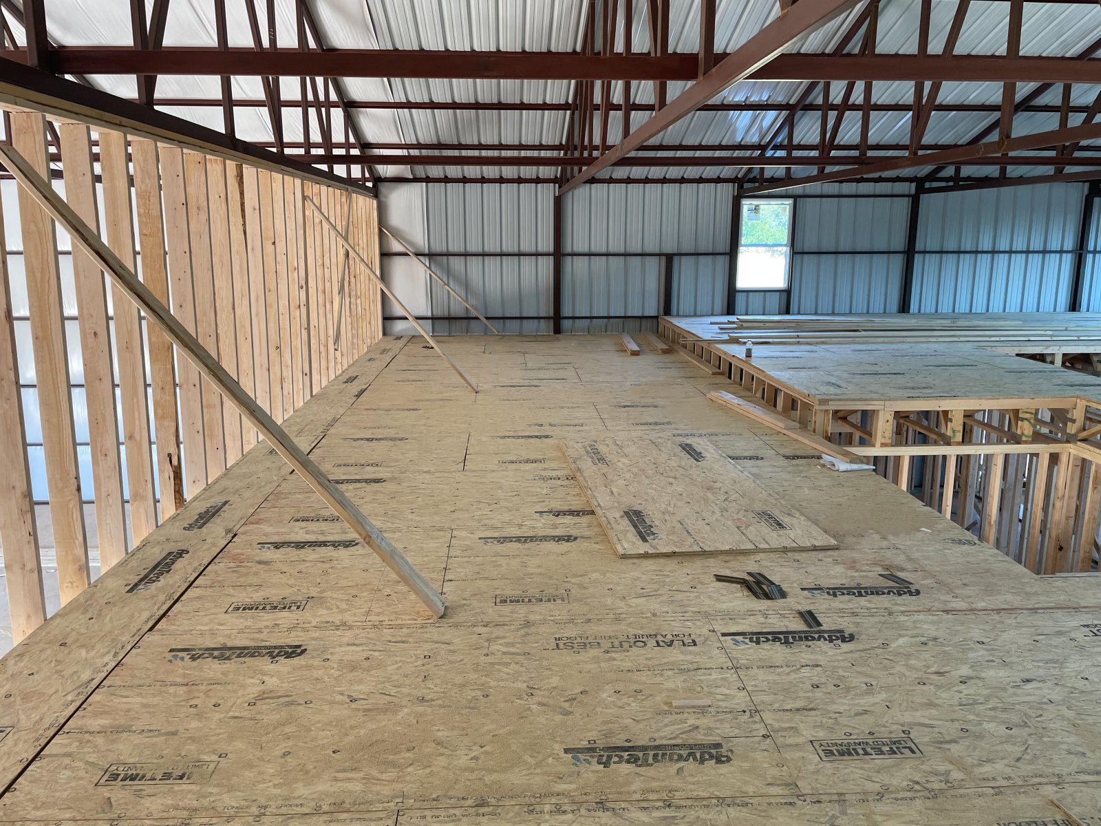

    Day 4
